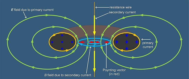

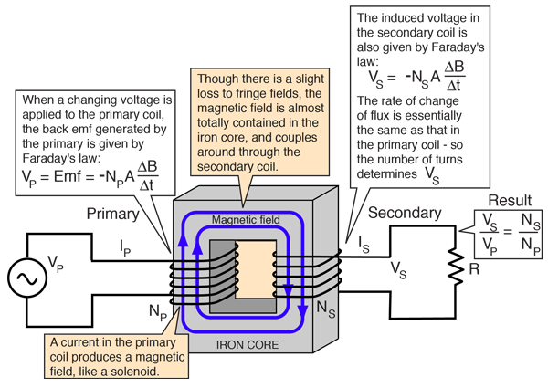

An EI transformer's flux looks much like that of a horseshoe magnet. This picture is very similar to what my daughters observed:
There is of course flux from the sides, but consider much of this is actually caught up in the thickness of the windings of your transformer. Yes, some spacing is wise here too. But consider that the the flux at the ends will be very significant, and there is no covers or extra space (the windings proper) there...
Magnetic flux is a property of any correct functioning transformer. Best is to work on a proper layout and avoid overlapping magnetic flux.
