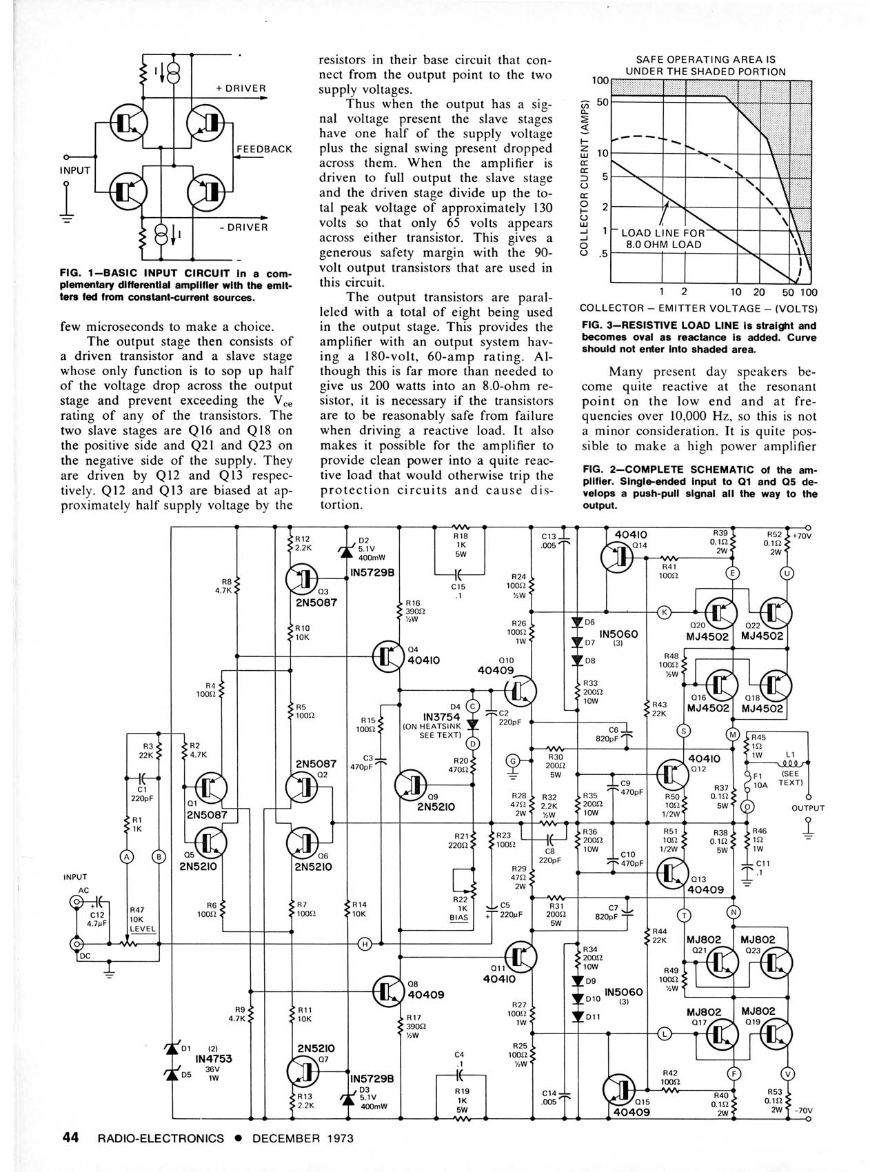

Some early Ampzilla info can be found here on the Popular Electronics Sept 1974 edition. Tried to post it but the file was too large.
The southwest tech Tigersarious can be found in the Dec issue of Radio Electronics.

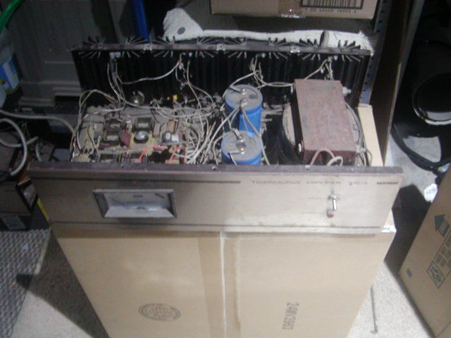

I have one Tigersaurs that I've never heard because it had oscillated itself to death which seems to the common problem with them. But this problem seems to be due to crappily built kits. Maybe some day I'll get mine going.
https://worldradiohistory.com/Archive-Poptronics/70s/1974/Poptronics-1974-09.pdf
That is Dec 1973.
https://worldradiohistory.com/Archive-Radio-Electronics/70s/1973/Radio-Electronics-1973-12.pdf
Fig 3 is drawn wrong. Schematic point G is wrong.
