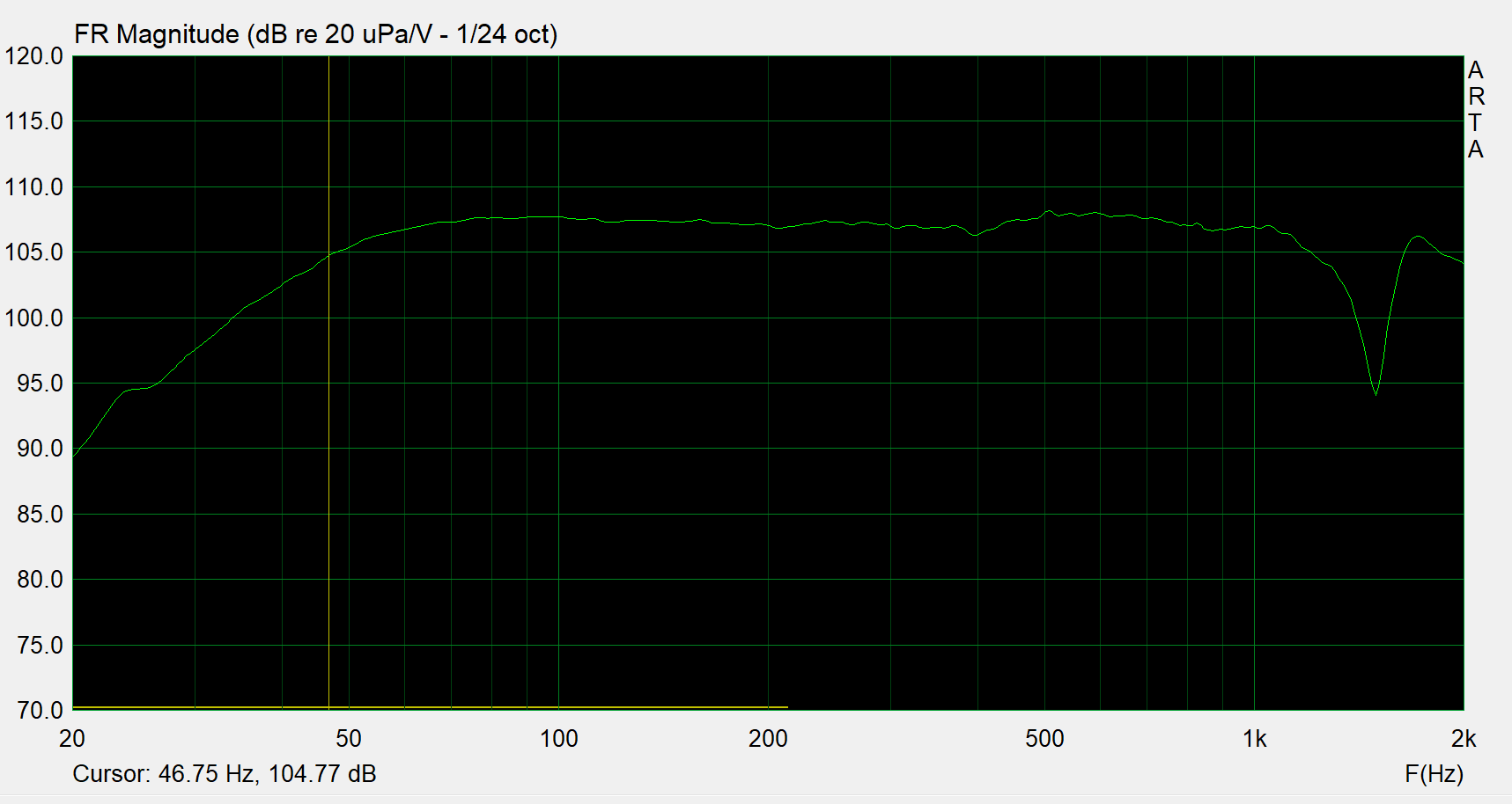

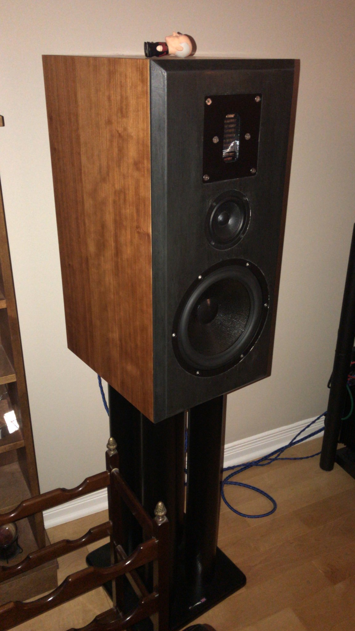

could you show us your design with the eton ? have you got a thread about it on here ? I like sealed designs better and find it a bit frustrating there seems to be an imbalance with most drivers aimed towards vented
It's nothing extraordinary.
A DXF file is attached for the box.
Nearfield response (bass only) looks like this. probably about 18+20dB higher than what it actually is. I have a baffle step at 400Hz or so. Crossover is DSP.
  • 3way812_10F_tpl75.zip
