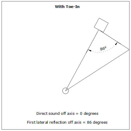

For stereo reproduction it is usually assumed you are at the apex of an equilateral triangle and your loudspeaker at the two other.
With 60* coverage you limit a lot of the reflections from the most adjacent wall of each loudspeakers.

Yes, you are missing the point. We may be listening on axis, but we do not only hear what is on axis. We hear first arriving signal, then few tens of milliseconds later we receive reflected signal, of axis. The signal which traveled from those 40-60 degree angles reflected from the walls, floor and ceiling. If that signal is significantly different, out brain has to work harder, and gets tired sooner. Speakers with significantly different on axis and of axis response do not sound natural to me, even worst is with abrupt narrowing and widening the of axis response.

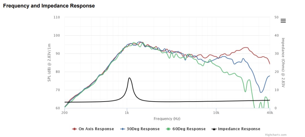

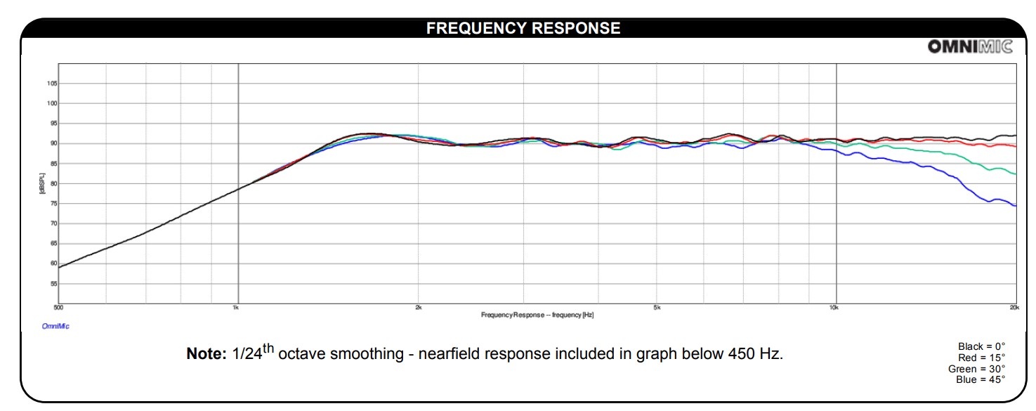

Don't mean to hijack the thread, but think this question is related.
I was looking at 3/4" tweeters and was comparing off axis frequency response of Dayton Audion ND20FB-4 other tweeters. See attached images. The ND20FB is very well behaved with clean sloping lines. Where as Peerless OX20SC02-04 has not so clean curves, if we only looking upto 20KHz. Other tweeters show same response, not just picking on OX20SC02.
Why would you pick OX20SC02s over ND20FB? Only reason I can think of power output 80W vs 15W. But if 15W is enough, then at least with respect offaxis response ND20FB is clear winner. Both tweeters are in similar price range.
Am I missing something?
