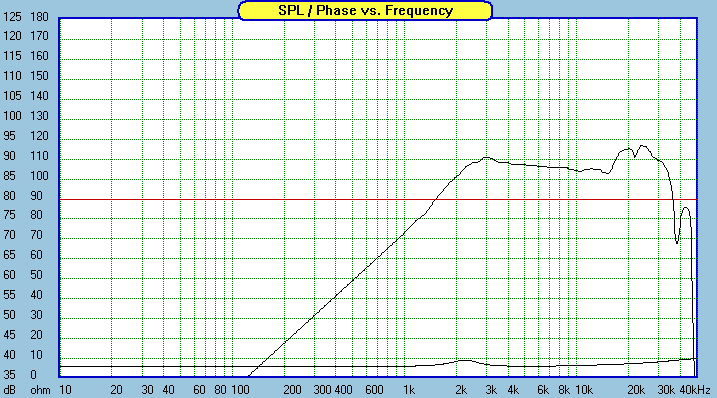

See tests here : http://www.zaphaudio.com/tweetermishmash/
Hi Sreten. Thanks for the link. The Seas 27TFFNCG ($32) looks super nice.

Thanks for the graph Sreten. Especially after seeing this, I would take the Dayton ND20FB ($8) or Seas 27TFFNCG ($32) if I wanted to go pricey.

Sreten, your graph of the Dayton Audio ND16FA-6 5/8" Neodymium Dome Tweeter got me inspired to do some testing. I have this tweeter in my speaker. The volume is adjusted by a L-Pad Attenuator 50W Stereo 8 Ohm and high pass is from, I think (didn't take the speaker apart), Dayton Audio PMPC-3.0 3.0uF 250V Precision Audio Capacitor
Just off the cuff, no serious documentation but I found 3 surprising things:
1) I thought the 3.0uf cap was supposed to cut off all high frequencies above 11kHz.
- But I was getting output at 6.3 kHz using Stereophile's test tone discs. This was easily shown by turning the L pad up and down and seeing the contribution made by the ND16.
- Could that be because the ND16 is 6 ohm and the L pad is 8 ohms?
- Is it because the cap makes it a 1st order where the attenuation STARTS at 11kHZ and rolls off at -6 / octave below the 11kHz?
2) The drop in volume was VERY sharp. More like 3dB per foot than 3dB per meter.
3) Like weltersys, while I could not hear it, the ND16 was putting out 80dB at 20kHz and after listening for a short while with my ear up the the tweeter, my ear started to hurt.
