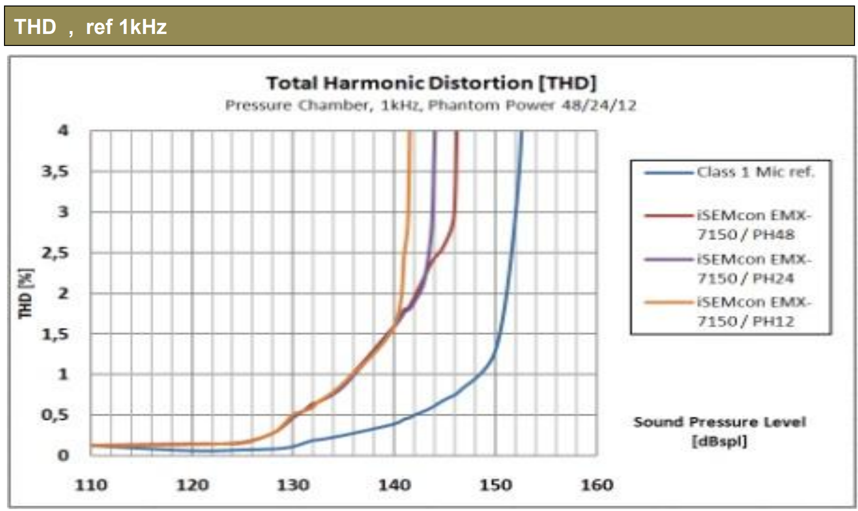

This is from the EMX-7150 data sheet. Note that this is just THD, so no information about HD2 and 3.
Seems to approach 0.1% = -60 dB THD at 110 dB but shows no tendency to rise towards smaller SPL and is actually a tad worse than the -65 dB THD given in the previous graph. Strangely, the B&K reference mic shows a shallow minimum from 120 to 130 dB with a small rise towards lower SPL, ending up at the same -60 dB at 110 dB.

Effective noise level may be slightly different for H2 and H3 in the measurement setup used for whatever reason, but I have little doubt that the initial decrease is entirely down to things being noise-limited. If you were to plot the absolute SPL of distortion products instead, things would start out flat until they begin to emerge from the noise floor.
The mic seems to exhibit textbook small signal behavior (described by IP2/IP3) until it begins to diverge around 146-147 dB SPL. Nominal max SPL spec would be 136 dB (1%) / 130 dB (0.5% THD). The relatively high level of H2 suggests that the electronics are the limiting factor.
I struggle to understand how noise at 3 kHz can be a whopping 20 dB different than at 2 kHz (assuming that a pretty narrow filter is used around 2 resp. 3 kHz to determine the harmonics). Maybe something strange going on in the analyzer?
The two measurements are in good agreement at 140 and 145 dB, wherease at 150 dB, ProductionPartner magazine reports -25 dB = 5.5% and continuing slope out to 160 dB wheras the data sheet just goes off the chart at 146 dB. Did they get improved electronics?

These graphs look like amplitude chirp tests at a guess. You need a long long chirp for both good power resolution and good frequency resolution - in other words the bandwidths for the harmonic detection will be wide to allow the chirp to progress across the range of powers quickly.
What transducer has low enough distortion to show the Mike distortion? I would want a lot more on those measurements to accept them. It's a difficult problem to check for acoustic distortion and even air nonlinearity will limit you.
Perhaps the distortion from the DUT is cancelling the analyzer residual, so the reading reaches a minimum at some magic level where the residual and DUT distortion are equal but of opposite polarity?
