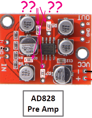

To all that expected me to have the details in the electronics, excuse me.
I am an DIY audio enthousiast and like to build and explore. But I am not educated or trained in electronics. Just hope for help and some advise.

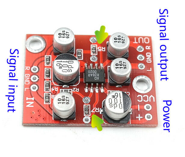

Concerning the AD828, I have unfortunately very limited information about this pre amp board. This is the PCB I have: DC 5V-15V 9V 12V AD828 Opamp Stereo Preamplifier Module Audio Preamp Amplifier 699914002363 | eBay

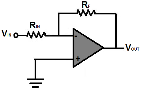

The gain of the preamp is set by two resistors. So, you can provide links all you want, but as long as you don't provide the resistor values, no way can anybody say anything about the gain.
Even with little experience, you should be able to check the board layout and figure out or measure the resistor values, and to which opamp pins they are connected. It should look like something like the attached. You can find the pin numbers in the opamp data sheet.

Start by getting/kludging +15V to feed that preamp board and PLEASE provide current R5/R7 values.
PLEASE.
get a good loupe, good illumination and read the values printed on them and/or measure them onboard with a modern multimeter; if the schematic is the basic one I IMAGINE 🙄 (since not even original manufacturer bothered to supply it 😡) , value should be readable in-circuit (with board unpowered, of course).

That seems an obvious thing to link early in the question. And it would have saved "me" the chore of marking-up the only image you gave. In fact the key resistors are called out in the listing as gain-sets (except they call it "magnification").
If you feel that the default magnification is not appropriate, you can change the magnification, magnification adjustment is as follows:
R7, R5 is the magnification set resistance (delivery default is about 5 times the amplification, you can change according to their own need to enlarge the resistance can be selected from 5k-47k, the greater the resistance, the higher the magnification,.....)
The next question: 5X gain is a LOT for most hi-fi line amps. Why is it "signal does not get amplified. At least not noticeable" for you?
