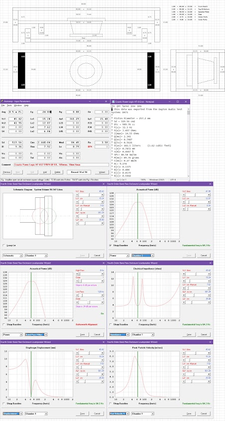

That's why SQ guys have sealed enclosures with a f3 of 40-50hz. TF brings up the 20-40hz to the natural box tuning levels.
1 of the great things about BP enclosures, you can add a hump to that 60-100hz rage so the sub sounds more "musical."
The Devastator line of enclosures on avsforum.com do that exact thing.

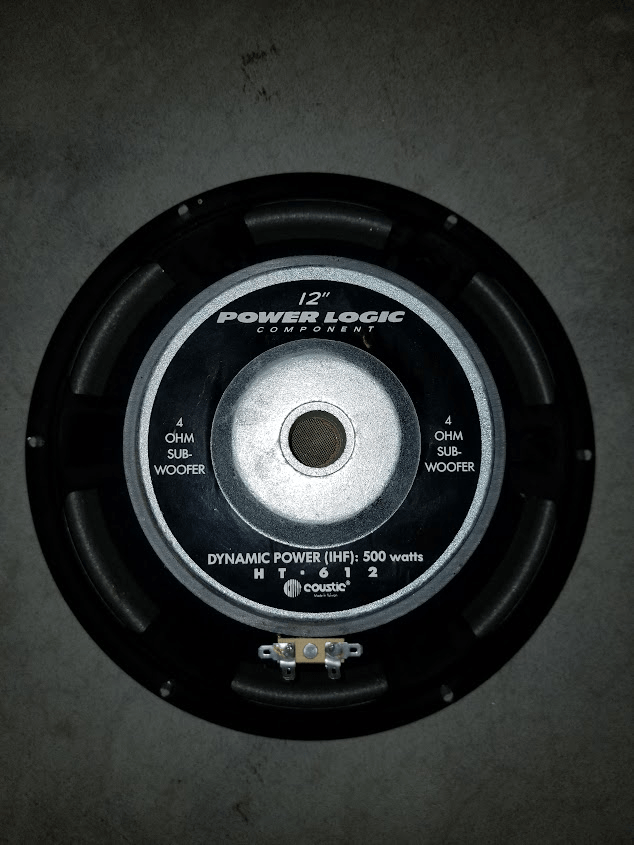

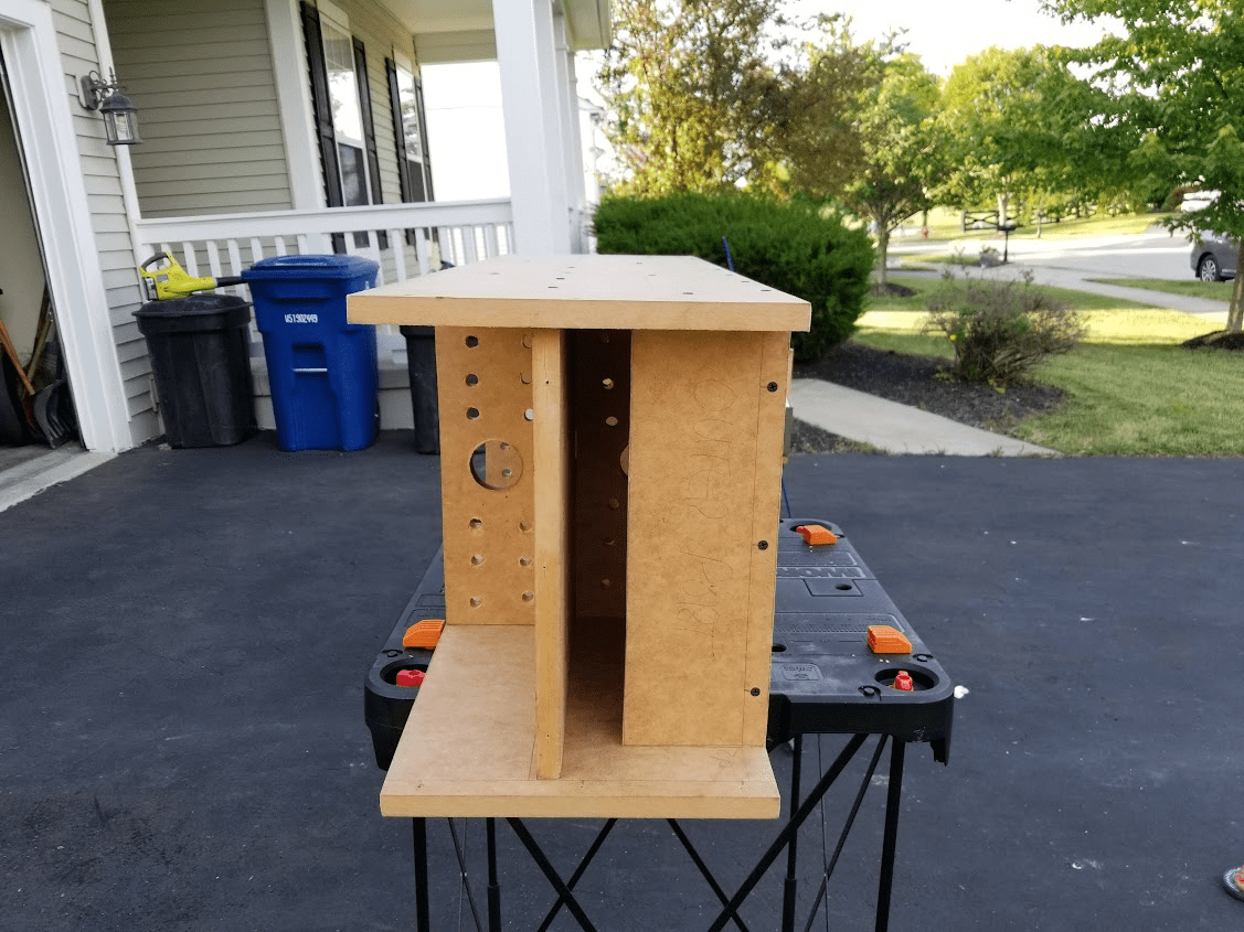

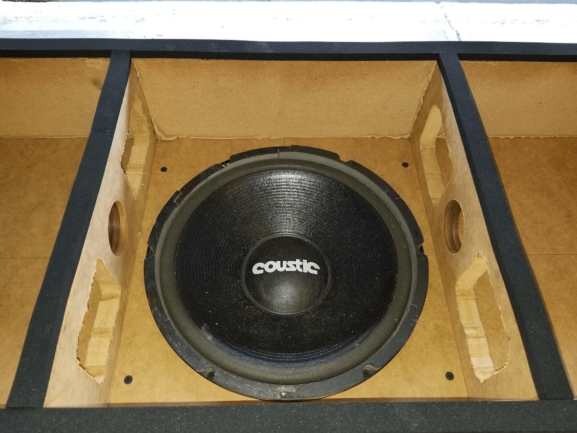

My personal car sub is an old school Coustic Power Logic HT-612 in a BP4 enclosure...interesting that is has HT in the model number. I run low pass filter at 120hz for more mid-bass. The 1st time my wife heard the system, she said couldn't believe how tight the bass is. It's the mid-bass level that is giving her that impression. I'm still running the factory 6x8 front door and rear deck speakers on an old school Hifonics 4 channel amp.

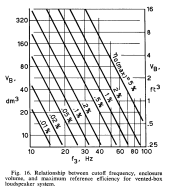

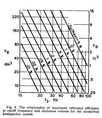

Hofmann's iron law is responsable for this. Low end, small box, an efficiency. Correct me if i am wrong, if you want midbass, you need to choose efficiency first
