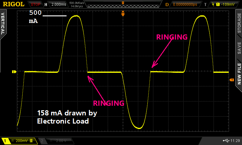

- 48 different diodes were tested in a high sensitivity jig, with and without CRC snubbers. These included slow, fast, ultrafast, Schottky, Silicon Carbide, HEXFRED, soft recovery, and Super Barrier diodes.
- All 48 diodes rang. Even the Schottkys, even the HEXFREDs. They all rang. Ringing amplitude is tabulated: the worst diode's ringing amplitude was 20X greater than the best diode's.
- (The very worst-performing diode, when used with a snubber), performed much better than (the best-performing diode with no snubber).

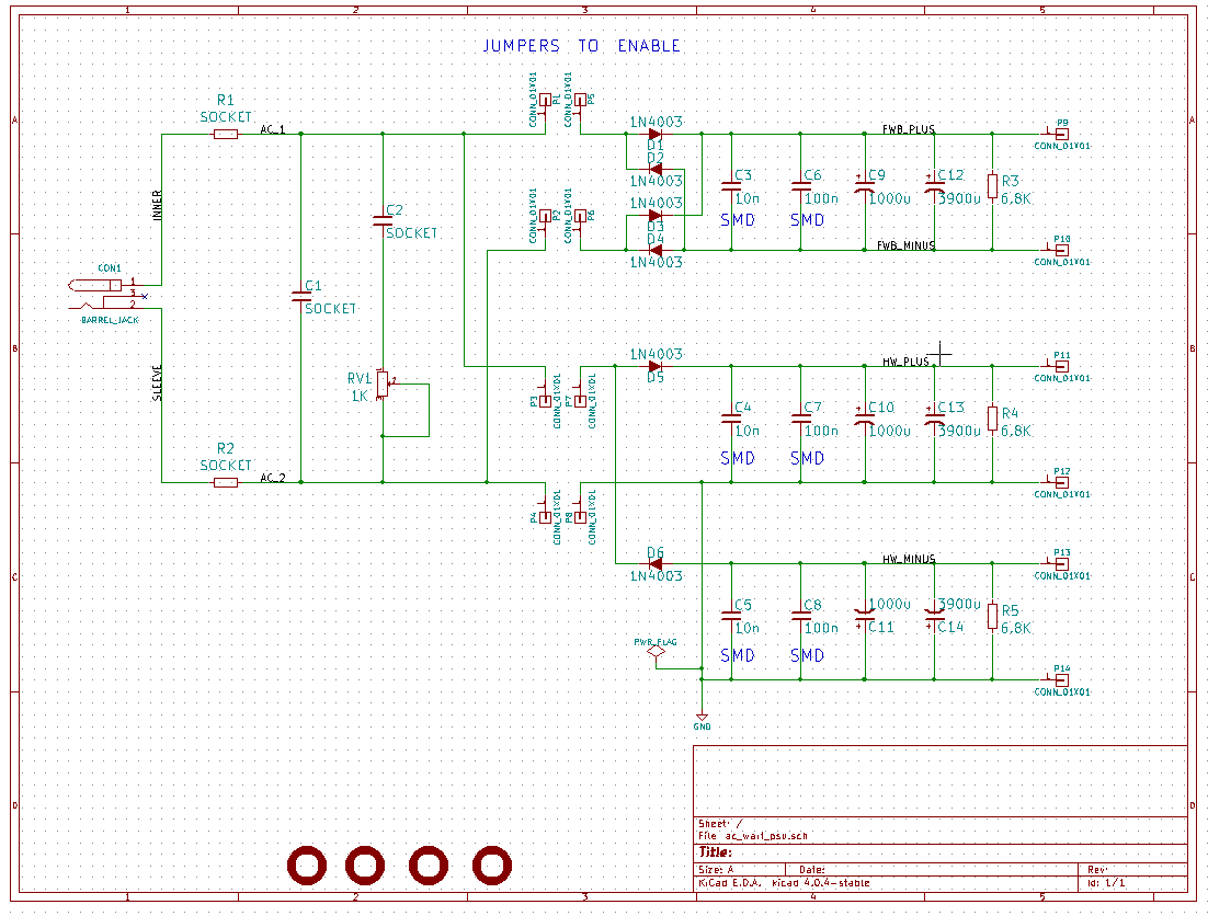

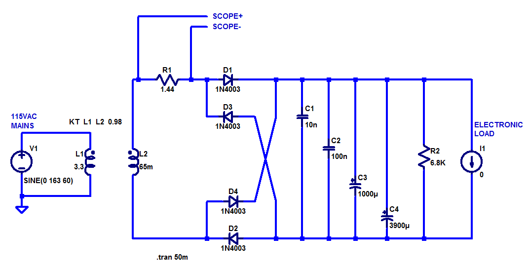

To show an example of the brave experimenter's approach, I have attached below a little test PCB (49mm x 99mm) that I built last month. Its purpose is to study the current waveforms in transformer secondaries, with and without different kinds of snubbers. You could design and build a similar board, which includes sockets for parallel capacitors across each diode, and then measure with / without those parallel capacitors. Voila, now you would KNOW whether parallel capacitors make things worse, make no difference at all, make things a little better, or make things a LOT better.
I've attached a .zip archive of the Gerber CAD files for my PCB layout, in case that helps you plan the layout of your own board. (If you're wondering why schematic #2 includes the oddball resistance value "1.44 ohms", that's the actual DVM-measured value of the resistor I used. It was marked 1.5 ohms.)
