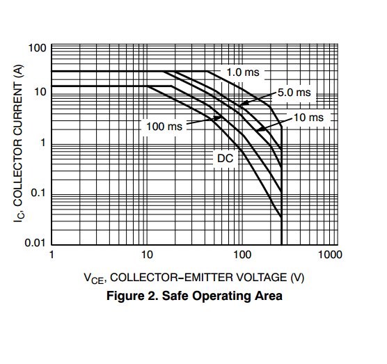

Assuming the PSU is able to handle the increased power requirements:
With linear output stages like AB, lowering the load impedance might cause exceeding the SOA rating. Althought linear mosfets have a slightly different failure mode than bipolars, both can fail due to high instant power dissipation. Think secondary breakdown.
With class D, there is no linear mode by definition, the mosfets could fail thermally due to high on state currents if not protected.
With bipolar power transistors there is a thing called "second breakdown". The transistor will self-destruct because the current gets concentrated onto a small part of the die.
With MOS-FET power transistors it is the dissipation. And, relatively speaking, the voltage loss over the devices is relatively tolerable to 8 ohms and 4 ohms, but grows in significance quickly.
Also, most parts are obtainable up to +/-100 V rails. Most parts can take 10 to 25 A of current. Everything more than that gets quickly more expensive.

This one is for the sake of curiosity. Coming from tubes, I want to start experimenting with a bit more power. Solid state being the obvious solution. One thing I cant get my head around is why certain amps and designs are spec'd with a minimum load of 4 ohms. Is there a clear reason for doing so, or could most amps be used into 2 ohms with and adequate PSU and the proper cooling? Or is there more to it than just the dissipation of the power stage and PSU strain?
No limitations ... a standard "slewmaster" output stage with 5 pairs BJT
will run 2-4R subwoofers .... provided the supplies are 50V or less.
For the common man , he has 8 ohm speakers ... and needs the headroom.
(higher rails). The OEM's will use 1 pair outputs and 60v+ rails with
a under-current "frail" power supply. This supply will collapse with
the load of paralleled speakers.
The "more to it" you refer to is the SOA (safe operating area -below)
of the semi's vs. power supply (SOA at X voltage for X time)
vs. cooling (the thermal de-rating of the SOA).
PS - any amp rated >4R would need a higher current / lower voltage supply
to run a 2R load. And most likely , greater cooling capacity. Do not
"obey" SOA , you get magic smoke or premature failure. 😱
OS

It is entirely possible for an amp to produce 15-20Wrms at 1R from 1 pair of TO-220 devices if the correct ones are used with the correct driving stage(s), and the correct power supply to match the output Z to 1R. The problem is when an amplifier is designed to drive 8R and is connected to 2R it will fail for the reasons explained above. Generally amplifiers are designed to drive typical speaker impedance that is available in market.
The MJ15015/16 pair are rated at 15A, but the gain drops above 4A.
To drive 8Ω at 200W needs 56.6V peak, about 7A (or 28A for 2Ω).
So, do you want to use 14 outputs per channel, 7 NPN, 7 PNP (plus rail switches)?
Various companies actually used only one pair of these in their 200W/8Ω amplifiers, and they would blow up their driver transistors when trying to drive 4Ω.

Xformer for +/-70V already in house, so I'll keep to 4 ohm minimum.No limitations ... a standard "slewmaster" output stage with 5 pairs BJT
Point takenPS - any amp rated >4R would need a higher current / lower voltage supply
