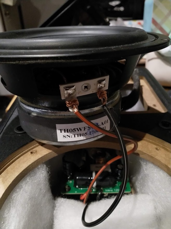

All useful info thanks but I now feel a bit stupid, dug out the photos I took and it was the woofer that was wired direct, the tweeter was to the crossover. Still a bit odd and I have never been totally happy with the sound, is wiring direct to the woofer a similarly bad or damaging?

The woofer needs to be hooked up to the crossover. I'm not surprised they sound bad with it wired direct.
You're "lucky" it turned out to be the woofer. Now you can simply rewire as it's supposed to be and should get the original sound back in place.
Possibly the reason for the funny sound is - without the woofer part of the xover in circuit - there was overlap between woofer and tweeter; some audio frequencies being output by both. Perhaps right where female vocals lie too.

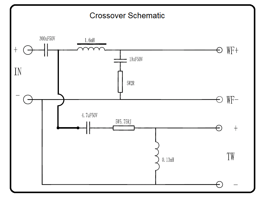

My guess as to why they did it, was to try and get more bass. Have a look at the crossover schematic, there is a 300uF cap in series with the woofer. Not sure what the rollof would be with that without doing some calcs...
Likely the bad sound was woofer breakup that was no longer being suppressed by the crossover.

Good find Tony, this would appear to explain the uncertainty.
That cap would be there to increase bass, but it's certainly counterintuitive. It's an old technique that wasn't used much.
Either bypass it or not, but definitely reinstate the rest of the woofer crossover 🙂
What Allen said, a big cap in series with the woofer, in a sealed enclosure, actually provides a bass boost. A trick to provide reasonable bass extension in a small sealed enclosure. I bet that in order to provide the same extension without the cap the enclosure needs to be much bigger and vented.My guess as to why they did it, was to try and get more bass. Have a look at the crossover schematic, there is a 300uF cap in series with the woofer. Not sure what the rollof would be with that without doing some calcs...
How does a component that conducts minimally at low frequencies provide a bass boost?
Capacitors conduct more as frequency increases.
Inductors conduct less as frequency increases.
It does so in cunjunction with the speaker's impedance. It causes a narrow-band lift at the cost of a little more current drawn from the amp over an also narrow frequency band. The other price to pay is a steeper rolloff than that of an ordinary closed box (3rd order instead of 2nd order). The trick can also be done with vented aliognments.

Check this out, Douglas: AES Journal Forum >> Closed-Box Loudspeaker with a Series CapacitorHow does a component that conducts minimally at low frequencies provide a bass boost?
