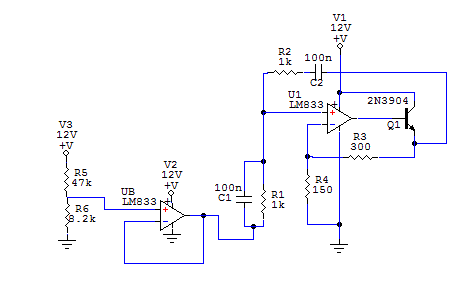

I am using a Radio Shack lamp rated at 5V, 25mA. I can see the "bounce," it's definitely doing something, so I'm not sure if it's part of the problem. I also have a 12V version which I haven't tried yet. My supply is currently 12V, single-ended.
I have rewired the circuit using the op-amp version instead of the 4QD version. My first observation is... it doesn't really work! 😀 I think I failed to consider the amount of current the op amp has to drive due to the lamp. My first try was with a LM833 and that does oscillate and the wave looks very clean, but it's only oscillating at about 2V p-p; that wouldn't really be a big problem except that I feel I'm overloading it. I also tried an NE5532 and a TLC2272; neither of those oscillated at all with the lamp. If I removed the lamp and put in place a 10K resistor and a pot for the feedback resistor it oscillated just fine. That makes me think it's a current issue.
So I don't know at the moment if I'll buy some higher current op amps, perhaps those Dick suggested, or if I'll go back to the 4QD circuit. Just thinking out loud here (so to speak) but I guess two other avenues would be using one of my life-time-supply of Silonex optocouplers in place of the lamp or some hybrid solution with some kind of transistor buffer between the output and the resistive leg of the feedback loop. Don't know if the latter's possible but I seem to remember seeing something like that.
As far as the single supply goes, I'm mimicking the circuit in figure 15-10 in this link:
http://www.ti.com/lit/an/slod006b/slod006b.pdf
I'm using a second op amp to generate a 2V reference voltage in place of "Vref." This is supposed to bring my output's midpoint to 6V.

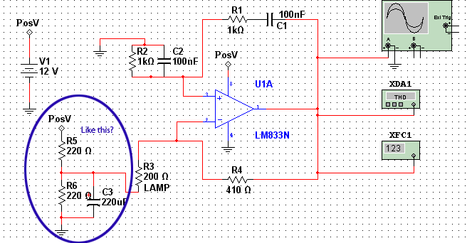

To use the single-ended version and get maximum output swing, return the bulb to a low impedance voltage divider at half the positive supply which is bypassed at the bulb by a large electrolytic cap for low AC impedance to ground.
I like this idea better because it's based on half the supply, but I can't get it to simulate correctly. I attached the circuit I _think_ you were describing but I may have gotten something wrong 🙂
Thanks for all the input guys!

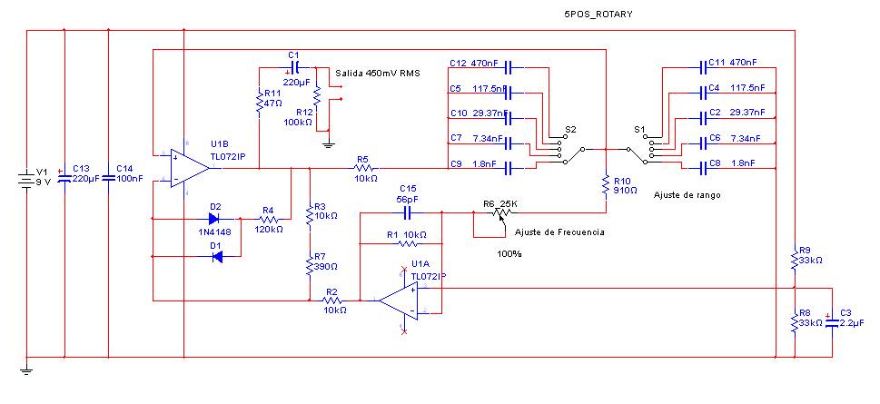

I attached my current circuit for the oscillator core. I added a transistor buffer past the op amp and it's helping a whole lot with the calibration. It's a lot more stable within a pretty large frequency range. It doesn't do well past about 12k so I'm thinking that has to do with current delivery from the voltage reference op amp as the resistors get small -- I've seen some voltage sag.
I'm really hoping to get this working without switching any caps, though, as I want to control the frequency with optocouplers driven by a microcontroller (see attached). I'm going to set up an AGC the same way, too, but that will be _after_ the selected waveform (square, sine or triangle) is switched into the next stage of the circuit.

You read my mind. I was just thinking about that! 🙂 I have tweaked and calibrated my circuit to where I am now getting my full target range of 100Hz-20kHz without cap-switching. This is using two optocouplers in the wien bridge sharing a current source and attached to a pot. But the last couple days I've been thinking about how I might go about swapping the lamp out for a third optocoupler. Especially, I'm thinking if I could reduce the output level to a smaller value, that would be better for overall distortion caused by the optocouplers; then re-amplify with an op amp. With a lamp, it has some pretty fixed properties and you have to work around that but optocouplers seem much more controllable as far as how sensitive you want them to be, what kind of time constant you want them to have, etc., since one piece is completely isolated from the other. I've only found one other similar circuit to this so this is a great find that I will definitely check out further.

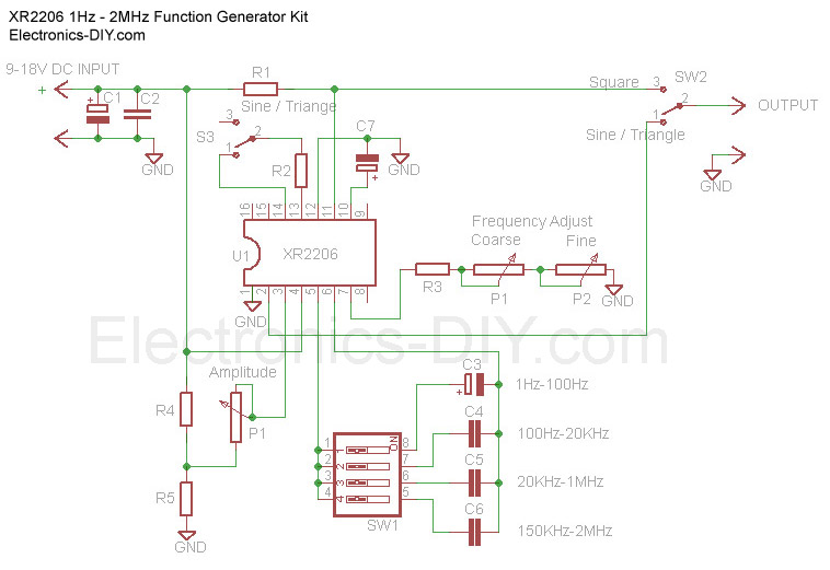

You know you can buy an IC that does all you want - a complete function generator. More than one mfr but here's one: XR2206. And a complete kit of it is available if you just want to get down to business and use the instrument.... but you wont learn as much...
Go to www.Electronics-diy.com
Such as this simple circuit ready made on pcb:
It wouldnt be too hard to design a ss variable R that would allow you to sweep the oscillator (maybe auto switching C as well). AND, a tracking BPF to reduce thd to very low number? Sorry.... getting carried away.
Thx-RNMarsh
Thanks! Yes, I actually have an XR2206 chip, but I am enjoying this project as more of a design challenge/learning experience. It's actually functional now and meets my original specs but then I started thinking about optocouplers. A "tracking BPF," huh? I googled it and it looks like something I will not be able to figure out 🙂
After a quick look at the datasheet of that chip, I don't think the sine distortion is low enough and it does it produce FM stereo?, kind of mportant, FM mono is nice but it is really L+R, L-R and such that you need for tuner work.
