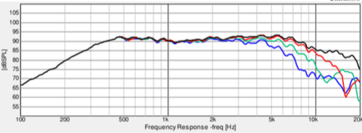

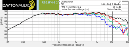

Here is an example of the dome midrange driver: https://www.daytonaudio.com/images/resources/285-022--dayton-audio- rs52fn-8-2-in-reference-fabric-dome-midrange-specifications.pdf
Look at its frequency response graph, it’s clearly seen that it has a natural corner frequency at about 300 or 400 Hz. However, the Fs is indicated at 394.3 Hz according to the table.
Regarding the conversation above that we can combine the electrical slope and the natural roll-off of the driver to obtain the steeper acoustical slope, therefore, the natural corner frequency (F3) of this driver is located at about 400 Hz.
Would it cause any problems as the F3 is located very close to, or maybe lower than, the Fs?
Presscot,
It's clearly seen (by me..) the -12dB per octave rolloff begins above 400Hz, at 300Hz response is near -6dB down.

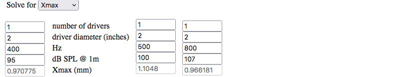

The driver has only 1mm Xmax, the excursion where harmonic distortion reaches ~10%.
If your don't mind that much distortion at a relatively low SPL, no problem 🙂
At 400Hz it would reach Xmax ~95dB SPL at 1meter using ~4 watts.
At 500Hz it would reach Xmax ~100dB using ~7 watts.
At 800Hz it would reach Xmax ~107dB using ~30 watts (half rated power).
At 1000Hz around 60watts (rated power) would be required to reach Xmax at 111dB SPL.
The usual practice of crossing around an octave above Fs makes sense if you want much output level, otherwise the "usable frequency range" suggestion of 500Hz is prudent, assuming 100dB@1m, (94dB at 2 meters..) with ~10% distortion is enough SPL for you.

So, if one’d like to cross any drivers where it could generate a steeper acoustical slope by means of combining driver’s natural roll-off and electrical slope (passive filters) as discussed on the original post, he won’t have to concern about the Fs location, correct?
Because the 500Hz point suggested in the example driver above is located fairly close to the impedance peak or Fs.
Well, that happens then is that you utilise the driver in more or less the range where the big resonance is - so if thats OK with your - by all means go ahead.
A resonance in the pass band will mean the same decisions as for a bass driver; closed or vented, what system Q do I want, xmax, GD etc...
Reactions: presscot
If your goal is to generate a steeper acoustical slope rather than protect the driver from overexcursion and attendant distortion, the Fs is irrelevant.
500Hz is more than 1/3 octave above the example driver's Fs.
1/3 octave is an 8dB change in a 24dB/octave slope.
Raising the driver's crossover point by 1/3 octave also reduces it's excursion by 1/3 for the same SPL.
