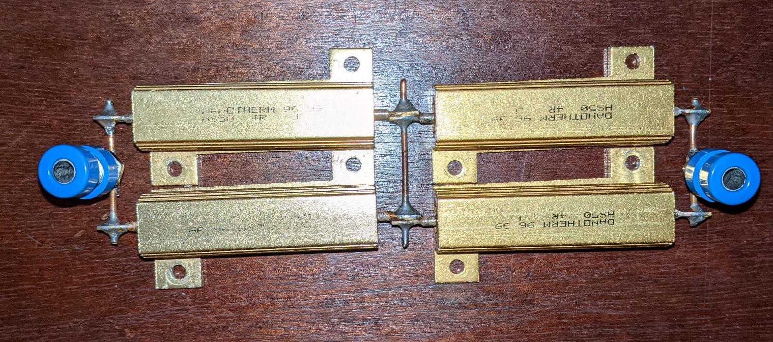

I use 4x4Ohm/50W to have a 4Ohm-200W resistor without heatsink.
For 8Ohms I connect a 2nd set in series.
Testing a class-d amp at 100W+ will get them piping hot of course and I have to watch out not to leave any burnt marks on the table but other than that they can take quite a beating. (in their datasheets quite often a max. temperature is mentioned which is often around 200°C!)

Here is a nice example of how to make a resistor array/dummy load:
Building my own noninductive 8R 150W load using wire wound resistors
I´d ignore the non-inductive part though. I personally think a proper dummy load should have some inductance and even more so: some capacitance but that´s another topic.

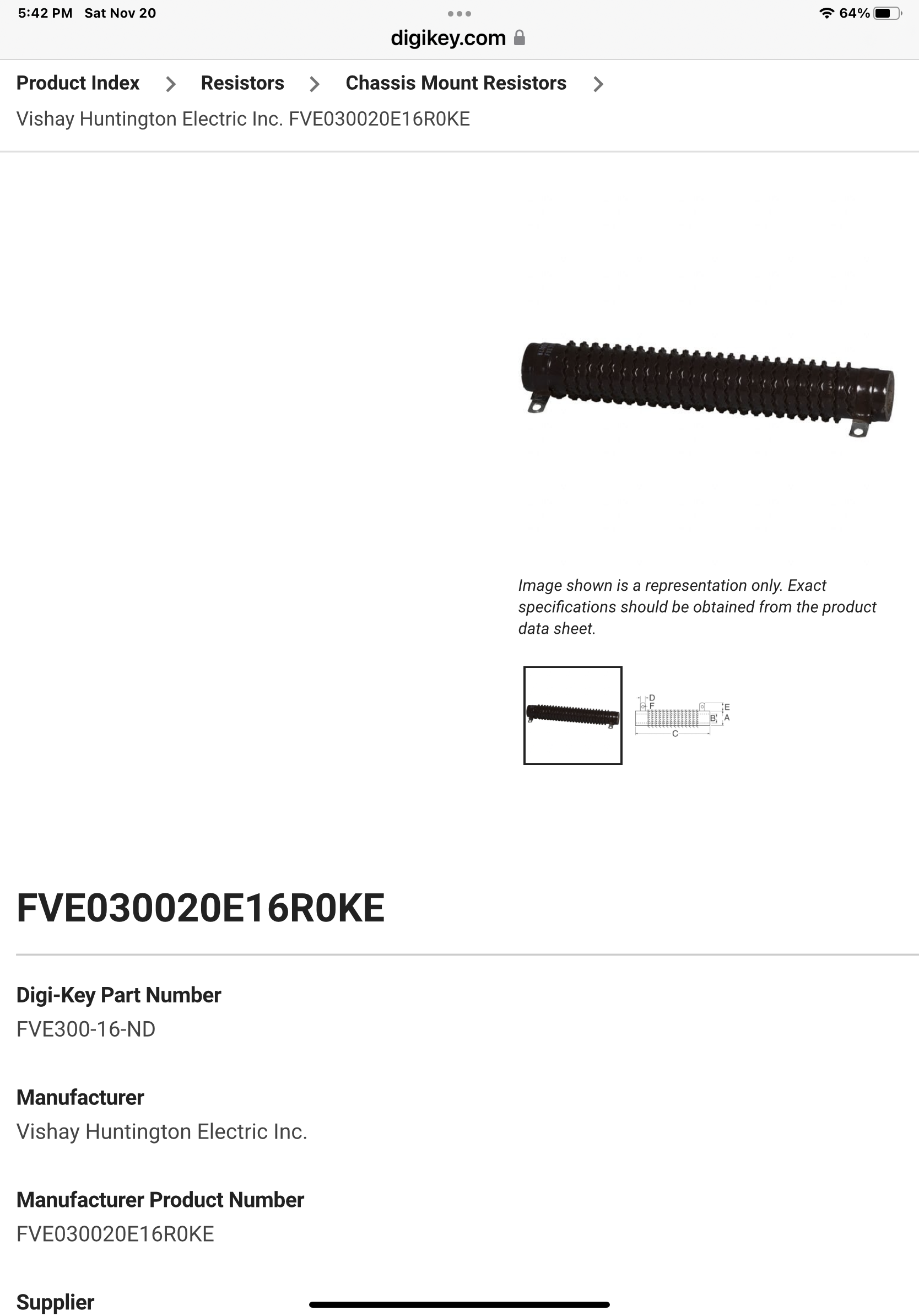

How do you decide how much resistor power capacity you want for a given load? If you wanted to run that 100W amp without risking burn marks, would you add more resistors? Add more heatsink?

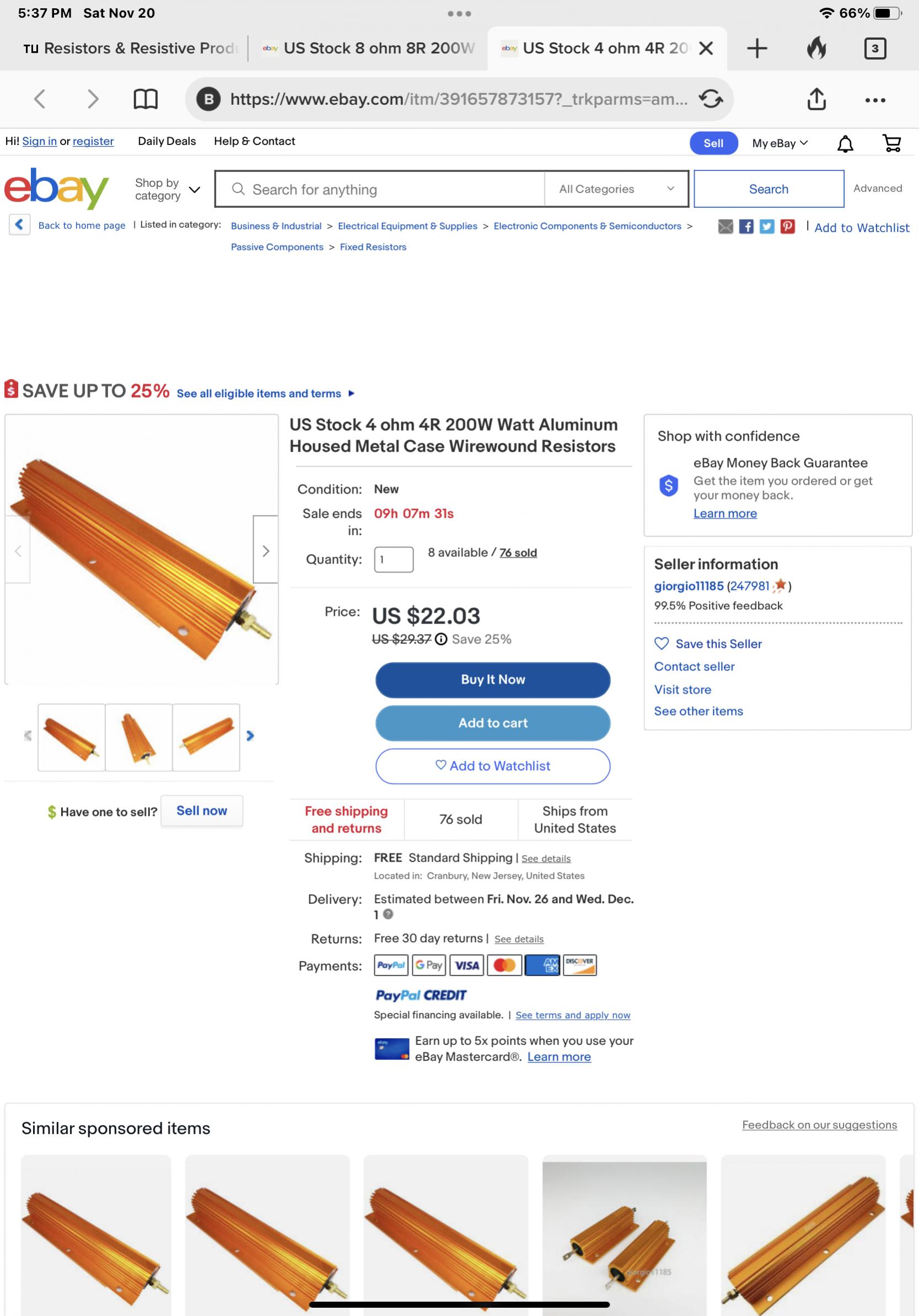

Because I was having trouble finding one in the values I need. I want to be able to run ~425W into 8 ohms. I figured 500W power capability would be enough. So I'm trying to find resistors that I can stack up to get to that value, since a 500W resistor is quite expensive.
Remember, you’re only going to get about 60 watts of dissipation at 75C and much less at higher temps. That means you’re going to need ten resistors minimum to be safe. Check with companies like Heatsinkonline.com to see what extrusion they recommend. It’s going t9 be big! Dale makes big aluminum cased 250w power resistors that are made for this kind of thing.

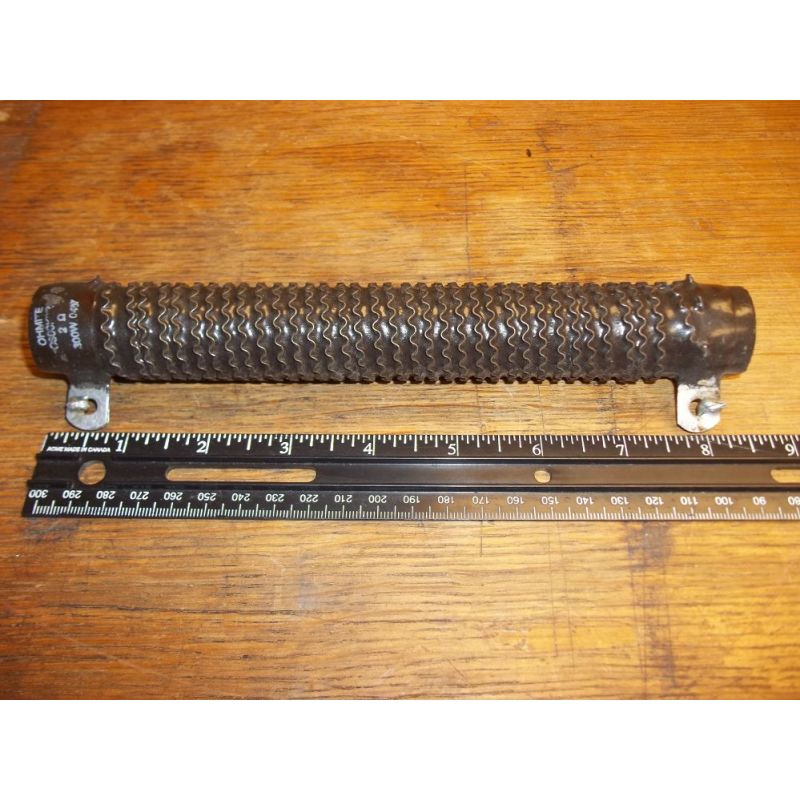

Search 225W or 300W on this page... They will be as hot as a space heater and easily cause a fire from curtains etc though... But for testing, they need no heatsink. Maybe a fan but that's free from the garbage.
40$ CAD for 900W power handling...
