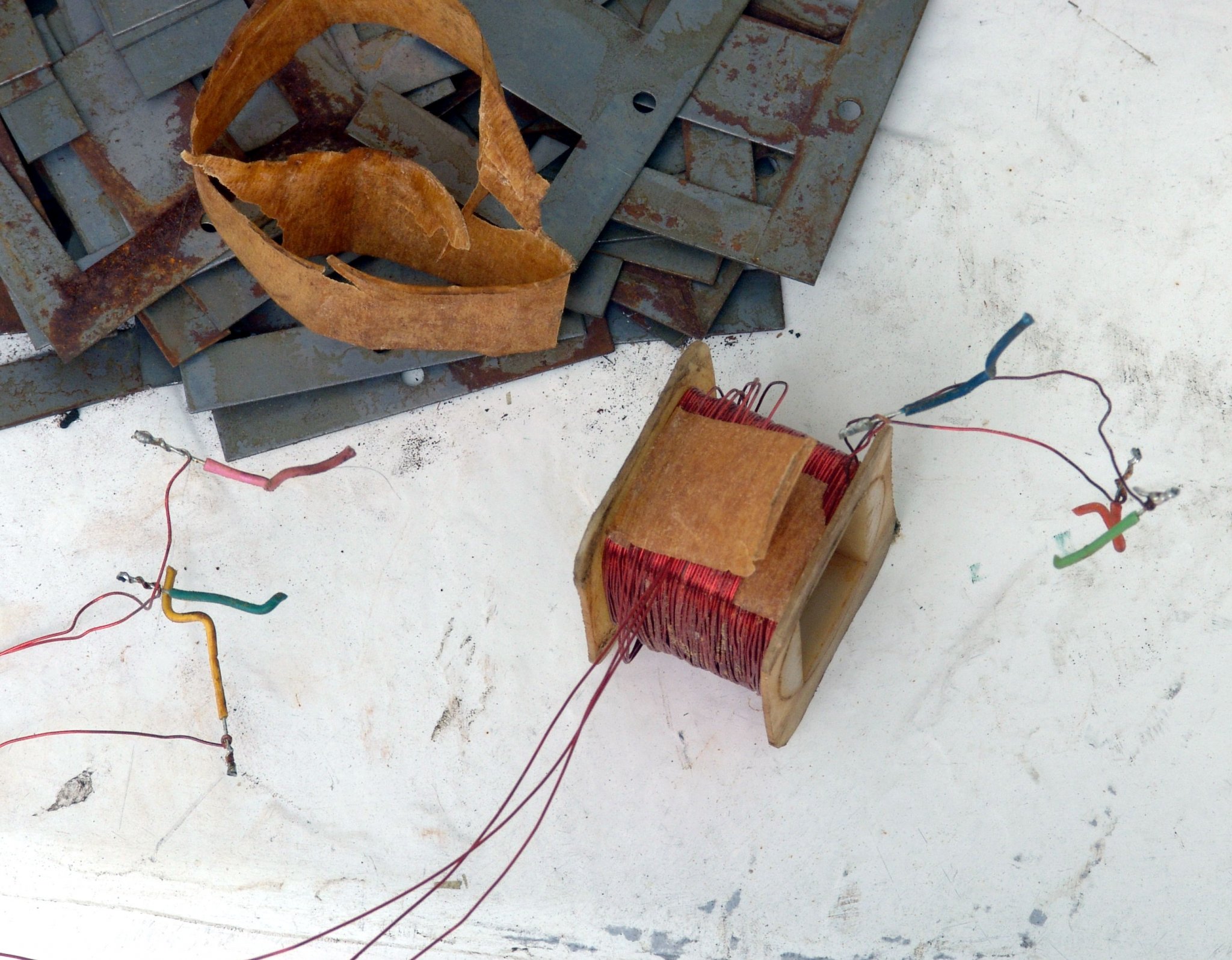

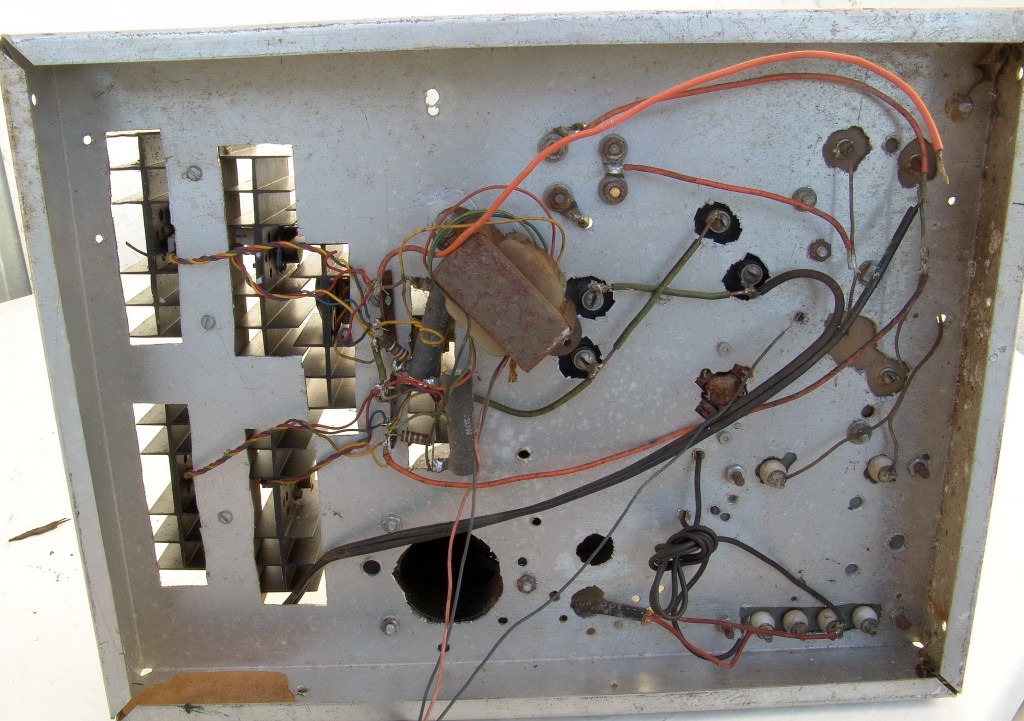

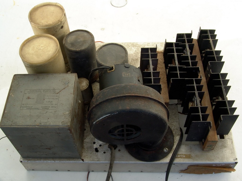

Many here know that I learned electronics by building and blowing up DIY tube amps made with parts from discarded radios and TV's. In the early days everything used tubes. By the mid 60's magazines like Popular Electronics teased us with DIY builds using transistors. The earliest one I wanted to build was the SWTPC Lil Tiger , but the kit was beyond the budget of a 14 year old kid. I did save enough money for the semiconductors and built one channel for a guitar amp using a series parallel combination of Radio Shack and other filament transformers for power. The amp worked, the kluged power supply did not. What to do now? I got the power transformer from an old B&W TV set, used a hammer to loosen up and remove the laminations, and ripped off all the secondaries leaving the original primary winding intact. The bobbins in those days were paper so one must be careful not to destroy it. had counted the turns on the heater windings to find the turns per volt, then multiplied that number to find the secondary turns needed for my target voltage. I wound a new secondary using ordinary masking tape for insulation. Then I reassembled the transformer.I'd be interested in just learning the craft alone, let somebody else do the math! If one masters the craft and materials and tools, starting out with power transformers then working up to OPT's. I would imagine the journey would cost money, time and mistakes, but hard to do things are valuable things.

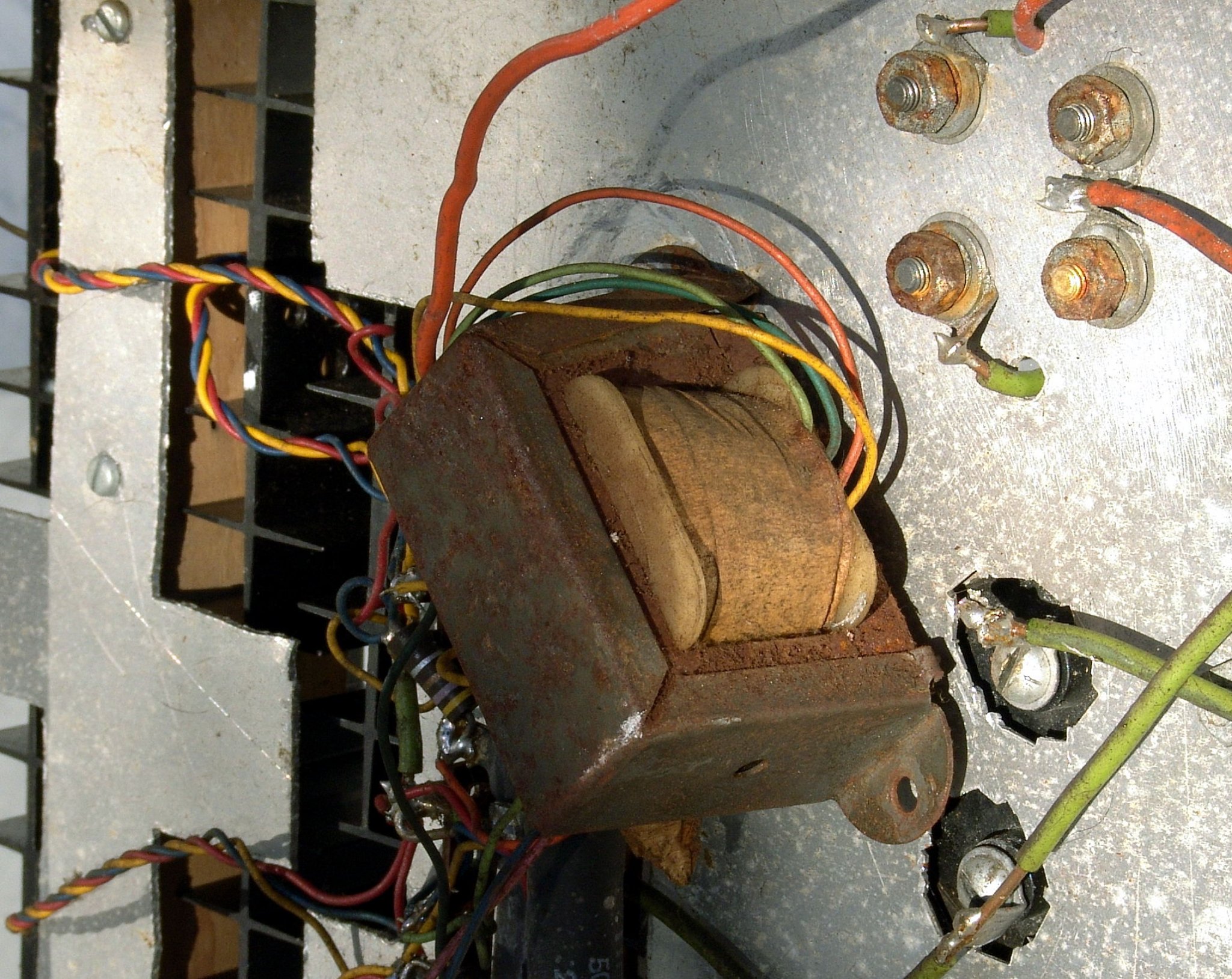

I never expected this thing to work at all, but it not only worked, it was still working over 30 years later.
In order to keep my title as having the most powerful DIY guitar amplifier in my high school electronics, I built this power amp stage in 1969. It used the totem pole circuit that was common at the time in HiFi amps. This circuit requires a driver transformer, so I wound my own on the core of a fried Radio Shack filament transformer. This amp was driven with a 5 watt tube amp and put out somewhere between 250 and 350 watts into a 4 ohm load. It used 6 X mystery transistors that I got from a local surplus store for 25 cents each. The amp was used to drive eight 10 inch speakers very loudly for several years. It wound up tossed in storage in 1974 when I left home never to see power again. A hurricane in late 2006 destroyed the shed that the amp was stored in, which was just covered with a tarp for about a year. Sometime in late 2007 I found the amp in the rubble. I plugged it in just to see what would happen, and after bypassing the fuse I got the expected venting power supply caps. I kept the heat sinks with transistors and trashed the rest, but I took the DIY masking tape driver transformer apart to see how it fared.
The transformer was quite rusty from life in a leaky shed in south Florida, but reasonably clean inside. The adhesive on the tape had lost its stick, and the paper was quite brittle, but the transformer would have worked fine if left undisturbed.

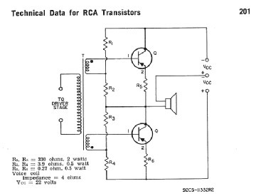

The output stage schematic is from an old (1960's) RCA transistor manual. I used this circuit with NPN silicon transistors on about 105 volts of B+.

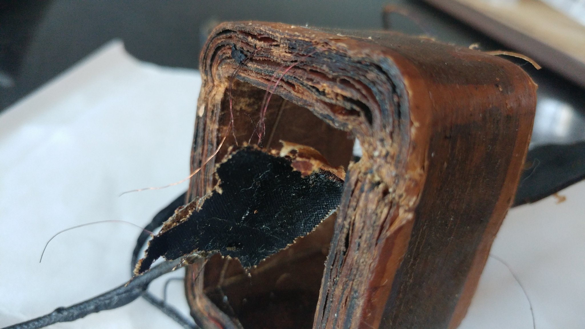

I used this technique many times over the years, but it was far less successful with vacuum tube OPT's. I still have a box full of failed OPT experiments around here somewhere.
Later on I switched to plumbing Teflon tape, then later Kapton tape for power transformers for better insulation. These materials have a far higher dielectric constant than paper so their use will increase the stray capacitances which is not desirable in an audio application.

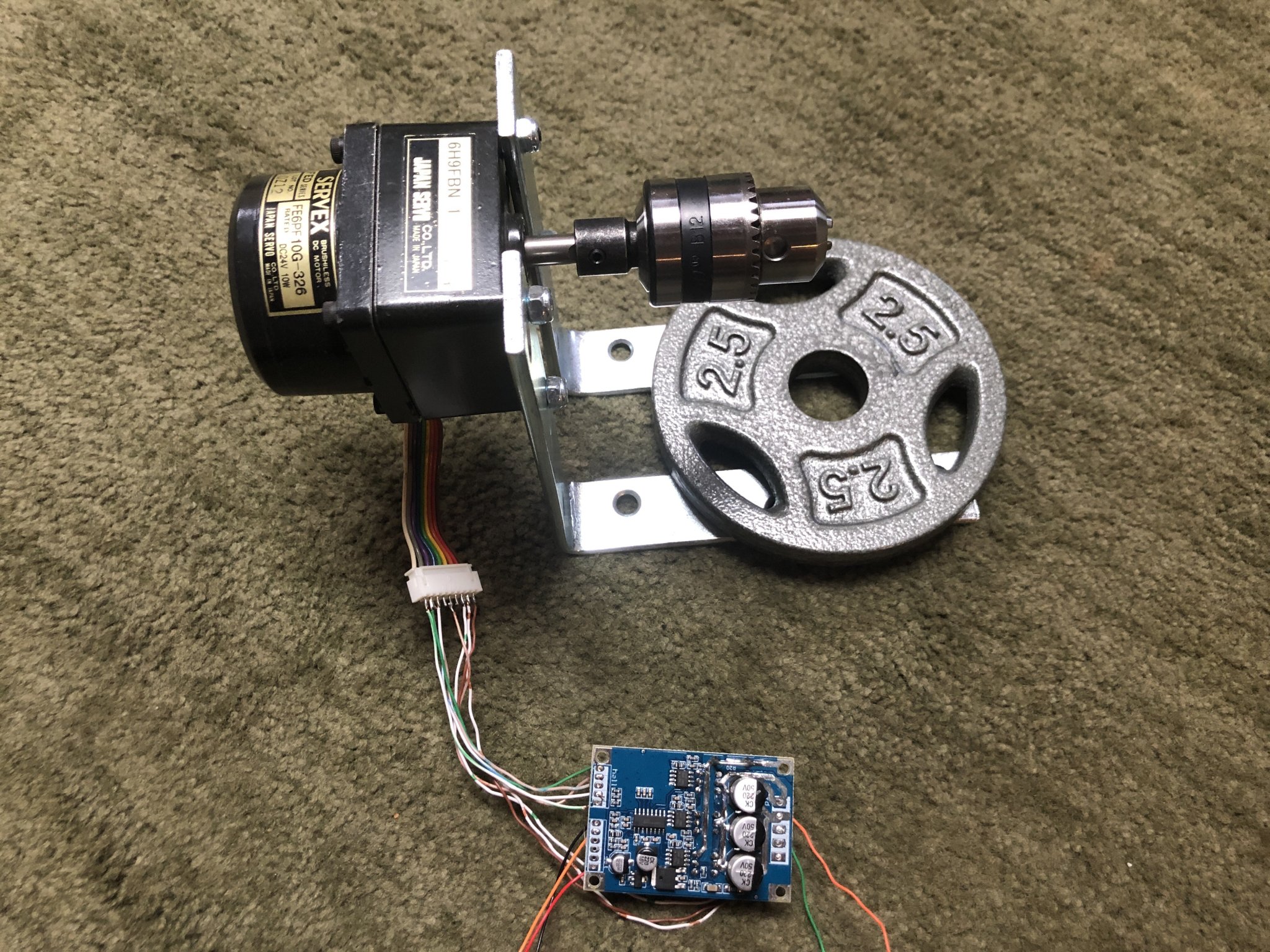

I built this coil winder for a project but never got around to actually using it. Found a nice brushless motor with a gearbox attached. It has hall sensors and an encoder but fortunately driver boards are cheap on eBay. I used this as an excuse to write some arduino code to count turns using the sensors. You can find cheap little foot pedals that give a 0-5v signal to control the speed.
