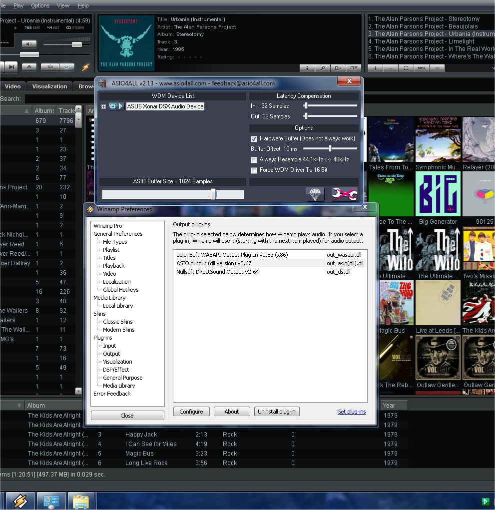

Ok -
Software -
-Winamp V5.666 ... most of the included plugins are bugfree.
Winamp 5.666 Released (Build 3516) - Winamp & SHOUTcast Forums
Respected source for it ....
-ASIOforAll driver - to replace the sound card's ASIO driver.
ASIO4ALL - Universal ASIO Driver
-Otachan's ASI😵ut.dll for winamp
WINAMP5? ASIO??????? (dll version) - ??????MIDI/Audio???
-Adionsoft WASAPI output plugin
adionSoft Winamp WASAPI Output Plugin - Freeware
These 3 output plugins (plus the native directsound_out ) will allow
you to interface with ALL soundcards. I have 6 systems , I can get all
to do ASIO .... some better than others. None crash.

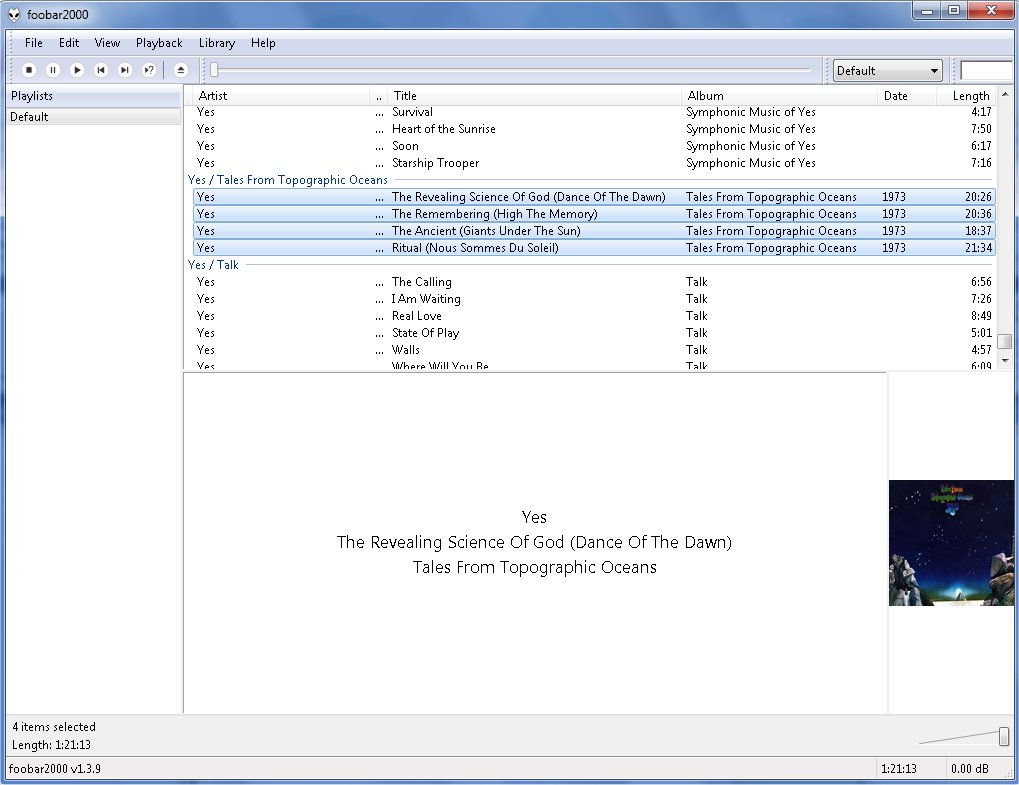

Why not Foobar ??
I went with the "columns UI" for foobar.
(below attachment 1)
-no clickable art to play
-columns UI defaults to a playlist type operation.
Now Foobar is good , many of the ASIO output plugins for
winamp have Foobar equivalents .. often by the same plugin
authors.

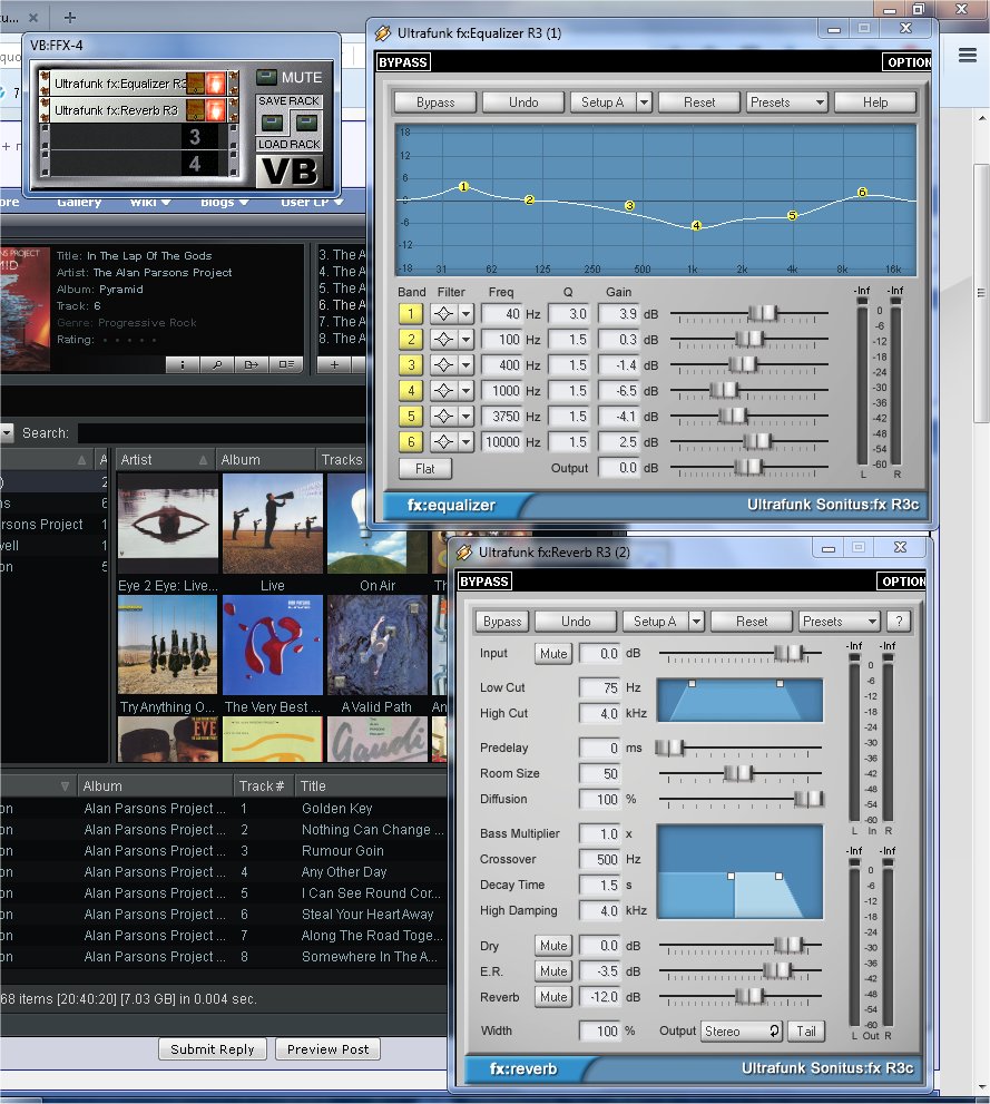

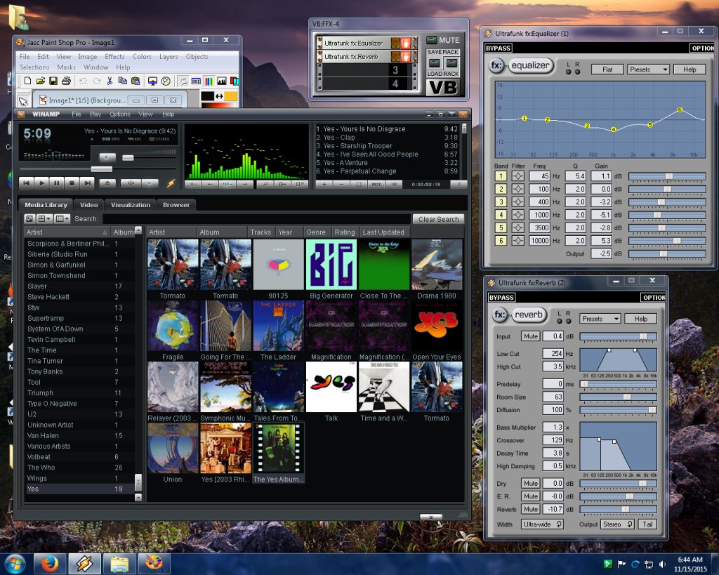

I can even port DX-FFX-4 -
DX Rack series.
(at the bottom -freeware).
to foobar OR winamp. Any DX DSP can now run between the FLAC/MP3
decoder and the ASIO output. These DSP's run hidden by default (cool),
just click the FFX4 rack for any particular DSP.
This gives major DSP capability, (below 2).
All these have been run/tested for 3-10 years !! I started uing the oldest
"Sonitus DSP's" in 2004. Cakewalk and Steinburg bought it out in 2010
because it is so good ! Older V2 sonitus is still available online. V3 (like mine)
is 32 bit perfection - far exceeds the Foo or Winamp EQ.

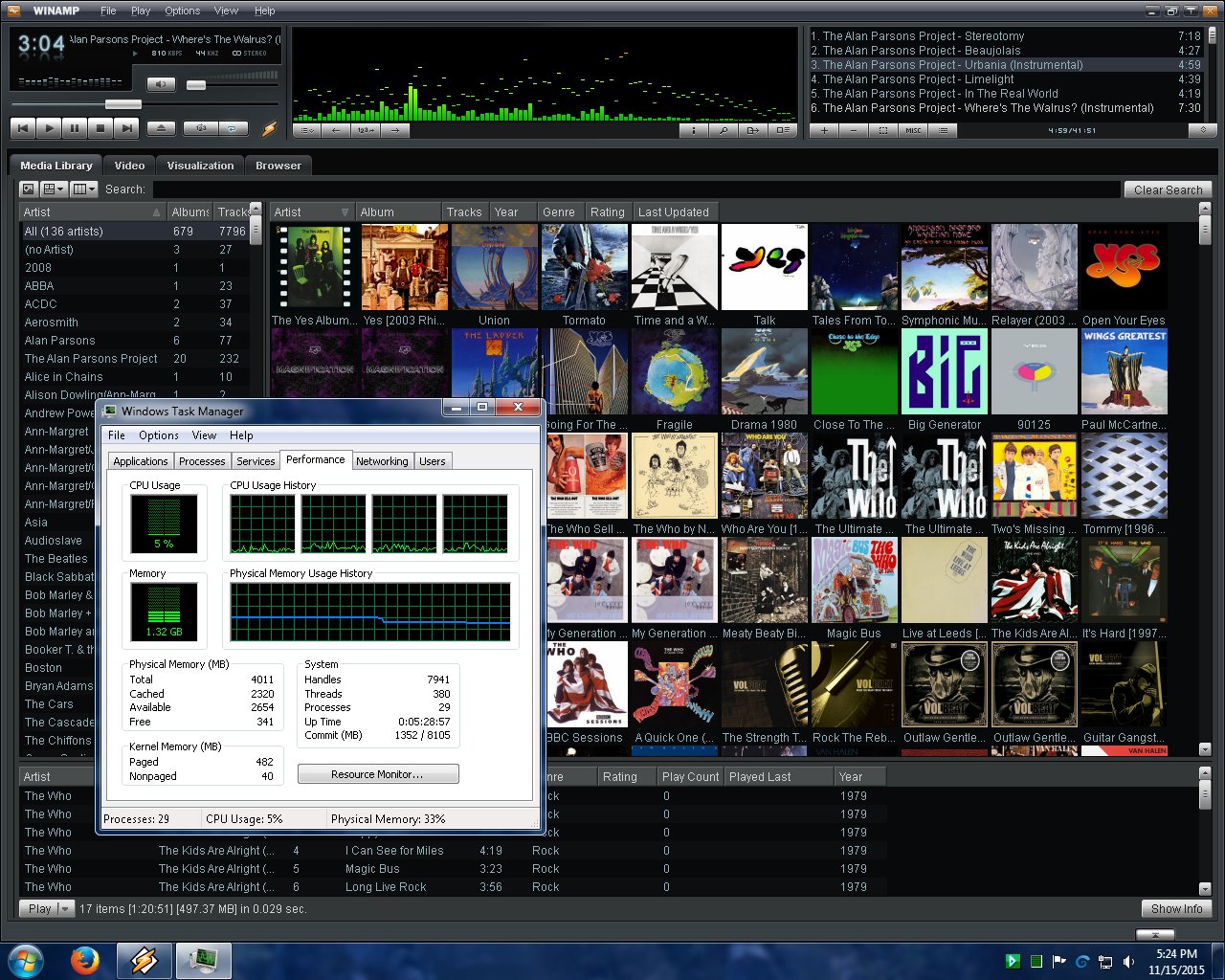

PS - I added this same setup to foobar = >10% CPU vs. winamp 3%.
Foobar is just nowhere as mature as Winamp (15 years development).

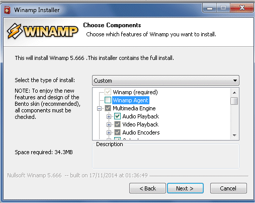

Setup ... (winamp)
Yes , AOL "bloated" the newer 5.xxx installation.
I use the " winamp5666_full_en-us_redux " only 9.6MB !
When you get to the components list (below).
-NO- (uncheck)
-NO !! "agent" (bloated chatty junk).
- sonic ripping burning /signal processor/or audio encoders.
- In output , to keep it lean .... no wave writer/waveout (just default directsound).
- (core media library) all the "core library" but uncheck the rest.
- user interface - No extended jump to file , tray control optional.
- Lastly , NO included visualizations.
Install , winamp will be a 21MB installation in program files/winamp folder.

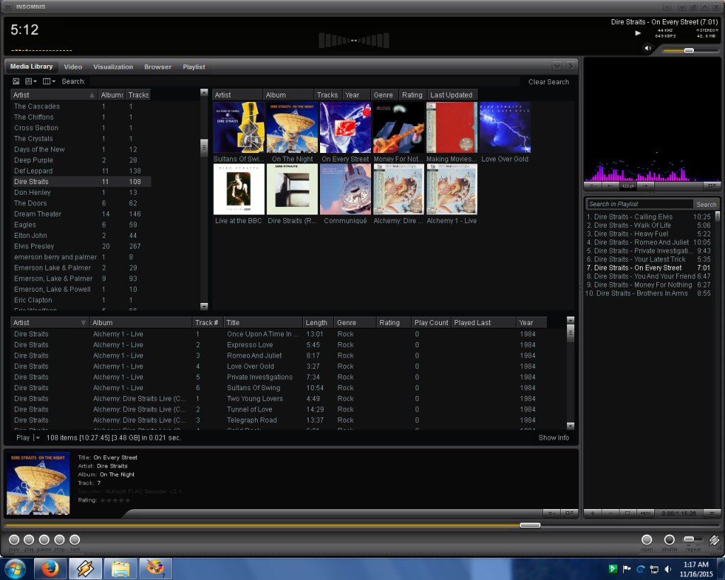

It will ask what skin - (Big Bento) keeps the library/playlist all in one
compact window. Default is close to what is pictured in post #1.
It will try to communicate , abort.
(it's elevator.exe can not make a firewall exception).
And , the main winamp.com is gone ... as well.
"send data" entries in "error reporting" and "general preferences"
options -->preferences) uncheck any comm. boxes.

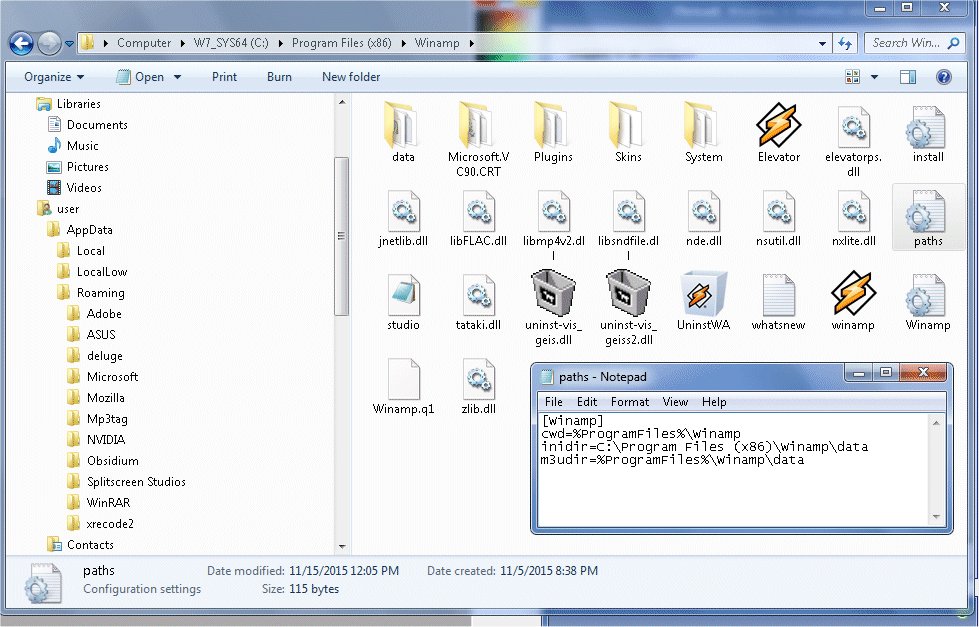

Next - fine tuning .....
Winamp went the "APP" way with its playlist/data folders.
It puts it in -
your other 3'rd party stuff (FF and chrome).
Once you compile your media libraries ... nothing much changes.
Why not have everything in one place ?
Program files/Winamp is a good place , take all the file/folders
out of the default "app" folder .... edit "paths.ini" (below 1)
example :
paste the "app" files/ folders there.
Attachment shows my finished setup.
You now have all things Winamp in one easy to access folder ...
(the main winamp folder). Winamp will no longer use "appdata" as a cache.
Before you establish your album database , you will still be <25MB
total.
Edit - Winamp is now "portable". The only registry entries deal with install/
uninstall. working paths and operation is NOT registry dependent.

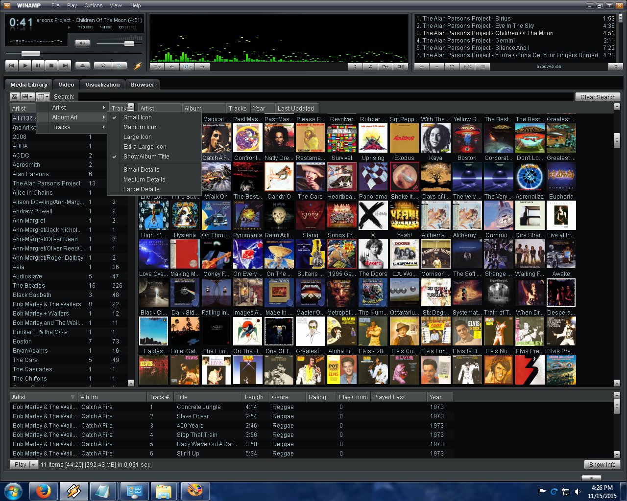

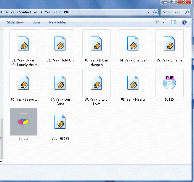

Create a database ...
Album art is any folder.jpg , I have found a 500 X500 jpg. is good for
HUGE databases. "folder" goes in the albums root directory.
PS - find >800x800 covers , reduce to 500x500 .... better than most
default cover art.
(below 1 example).
Art is put in -
1000 albums of (art) will create a 50MB "art" folder.
FLAC or MP3 works the same .... "folder.jpg" 500x500 pixel in the root.
Then you will have all the genre/artist's in one pane , album art in
the other (below 2).

Audiophile - ASIO
Found the right chain ... in_flac.dll --> otachan out_ASIO.dll -->ASIOforall .
(below 1)
This is a healthy chain . I can't break it. I can up/down sample while playing ,
(96>44 or 44>96) .. adjust the buffers , use hardware buffers - anything.
Main windows volume is active if you have the asioforall selected in the
otachan output plugin.
ASIOforall is just a windows install. the otachan out_ASIO.dll goes in the
"C:\Program Files (x86)\Winamp\Plugins" directory.
Some winamp plugins have installers , some you manually place.
In_Flac.dll is included with winamp.
This chain is quite efficient , CPU wise (below 2). Can't beat that !
The SQ is just phenomenal with either this chain or the adionsoft WASAPI
output. Both are under 5% , worst case (with visualization).

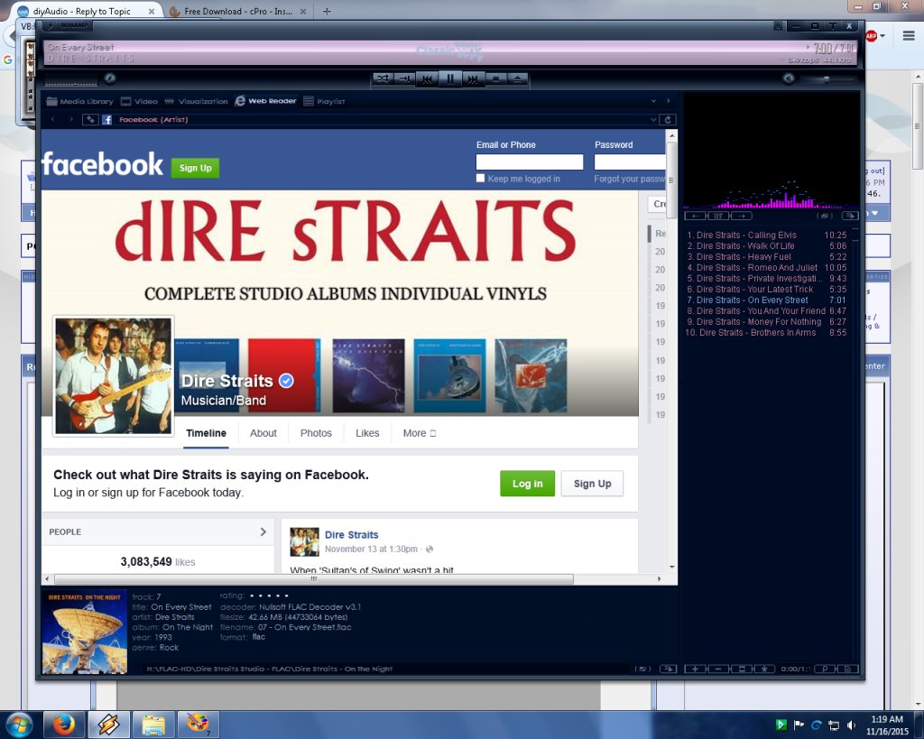

Found it !
I have not seen anything like this !!
You install this update to the media library/skinning.
ClassicPro - Skin Consortium ClassicPro
Adds some
XML , updates ML.dll , and adds a few more folders. Don't let it
alter any path.ini / winamp.ini stuff (it asks you).
It comes with skins that have more or less "power".
Free Download - cPro - Insomnis v2 - Skin Consortium
"Insomnus" skin has 50 color variations and can search album and
title on the bottom art/info panel - kind of manual. Still , stable
and good looking. (below 1)
Free Download - cPro2 Dark Aluminum - Skin Consortium
The best of the best - this one will even ....
-pop up lyrics in it's browser , facebook pages , or wiki results for either
song or artist.
This can NOT happen , if you don't toggle the browser tab.
Fully tabbed search , folder/tree view , playlist , and album art -
just about everything. 50 colors. (below 2).
Strange to see a skin actually leverage more functionality out of
a program. There seems to be a lot of "unharnessed" features deep
within Winamp. Some of this is actually ported out to W7's existing
IE7-10 ... but Winamp itself gains scripted functionality.
Networking is next - I already have my 5 workstations going (easy and
flawless) ....
