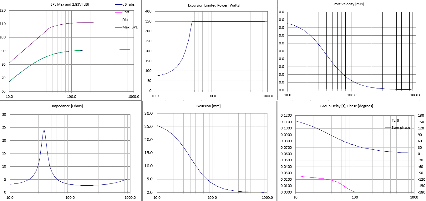

There are some that do. Margolis-Small presented some hand calculator methods back in the 80's that sorta work
They predict around 50 liters lined and 37 liters if stuffed for this woofer.
A sanity check for any "calculator" is always the old Qtc/Qts=sqrt(Vas/Vb+1) I would never trust a program (Bassbox) that told me stuffing could reduce the volume by half.
My sim shows a Q very near 0.5 with 45 liters Qa=Qb=20 Changing these values a fair amount doesn't change things much except for impedance.
FWIW, This woofer is very much a ported woofer, in 50 liters tuned to 25, it digs pretty deep and handles a lot more power down to 20Hz, but needs a long port, or a PR.
