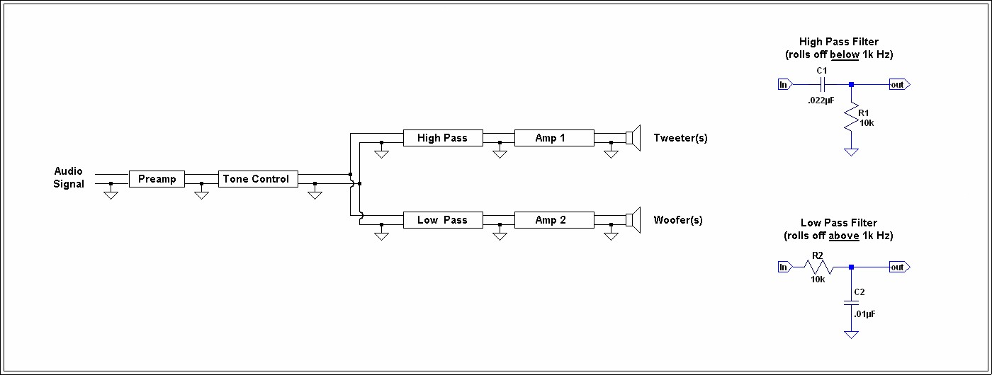

It seems you're talking about running 3 separate amps, one amp for tweeters, one amp for midrange, and one amp for bass.
Then you're talking about 3 entirely separate systems, the only common factor being the input. The sequence would be:
Highs: audio source ~> high pass filter ~> preamp ~> amp ~> tweeter(s)
Mids: same audio source ~> band pass filter ~> preamp ~> amp ~> midrange(s)
Lows: same audio source ~> low pass filter ~> preamp ~> amp ~> woofer(s)
All of which is a pretty complicated setup. Unless you're running pretty expensive speakers I question whether you'll get a return on your effort and expense. You might be better off with a simpler, single 20-watt amp. You might be interested in the "Typical Applications" circuit on page 2 of the LM1875 data sheet, which is here: http://www.ti.com/lit/gpn/lm1875
Also I'm posting the below illustration, which might be of interest.

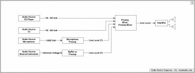

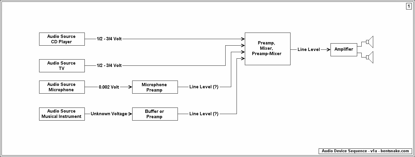

Explanation:
In audio the ruling concept is "line level." It rules in the sense that preamps, mixers, and similar are expected to have a line level output, and amplifiers develop their full rated wattage with a line level input.
Unfortunately, in these multinational times there are several definitions of line level. However, you won't go far wrong by using the classic definition of line level = nominal one volt.
"Nominal" means approximately. Line level has to be an approximate figure because audio voltages actually vary all the time, to produce very soft or very loud audio at the speakers or headphones. But there has to be some kind of planning figure, and "line level" is it.
It's worth noting that usually headphone jacks work at about line level. Nearly always headphone jacks can be used as line-out jacks, which connect to line-in jacks.
It's also worth noting that audio sources such as CD players, Blu-Ray players, TV sets and similar usually have an output voltage close to line level, and don't need a preamp before they're connected to an amplifier. But the only way to be certain of this is to look at the manufacture's specs, or to just connect the device and see how well it works.
Because most audio sources output something close to line level, preamps and mixers usually don't have much gain. They might have a gain of around 5 (14 dB), intended to just bring various unknown inputs up to the required line level output to run the amplifier or other devices.
(Amplifiers might have a gain of around 20, which is about 26 dB.)

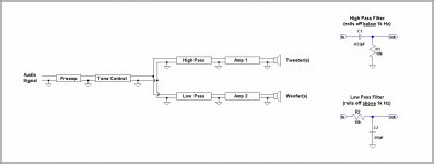

...for tweeter should i use another amp? or just crossover from the already build system?
The whole point of biamping is that one amp drives the tweeters, another amp drives the woofers. The two separate amps don't feed each other in any way, and there are no crossovers.

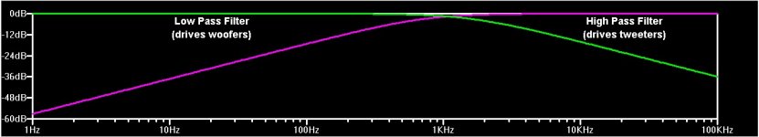

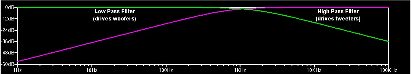

There are no crossovers, but there are filters. The high frequency amp is driven through a high-pass filter, the low frequency amp is driven through a low-pass filter.
The image below might clarify. It's only one possible arrangement, others will work just as well. Values shown are representative, actual values would be matched to your needs.

Then the crossover network controls which frequencies are sent to which speakers. So clearly the crossover network must be in balance with the speakers, since that's the whole point in the first place.
The critical item is the frequency response of each speaker. If the retailer can't supply this, then look it up online. If the information can't be found online, then it's impossible to balance the crossover network with the speakers.
In which case, well, you hook up some random crossover network and hope for the best. What else can you do?
For every 100 people swearing that active crossovers are better, there are 100 people swearing that passive crossovers are better. In electronics and audio there is no "best," there's only as close as you could get under the circumstances. PS: simpler is always better.
