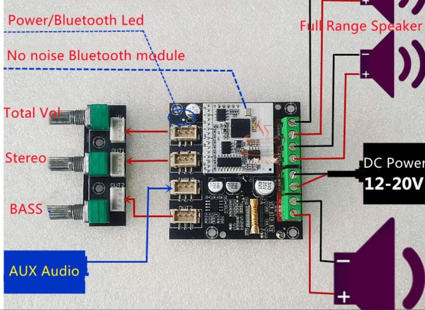

1. I have a BUSTED Roland 20Watt Guitar Mono amp. So I am gutting it and re-cycling the casing.
2. So I am using the casing and 4 OHM speaker to re- use the casing.
3. one of my inputs will have a stereo signal so Since I purchased a bluetooth 15 Watt Amp module, that has stereo inputs and outputs. I wanted to just combine the left and right channels .. not looking for perfect sound, just so the Roland Box can be reused.
I just want to mix the left and right channels, I am not looking to increase the power. So I guess a parallel connection should work. just looking for something functional.
There is NO SPEC on the amp chip, so when I receive it I will post later
Original Roland uses a TDA2050 chip.
I am suspecting its probably a "TPA3110 "

The amplifier module referenced at post #14 is a 2+1 amplifier. The third "30W bass channel" is a mono combination of left and right stereo inputs, so it may already be the desired solution. Sometimes this channel is low-pass filtered, but sometimes is not because it is cheaper to skip the low pass filter. Just connect the speaker to the bass channel output and try. If high frequencies are missing, the solution may be as simple as removing a capacitor from the circuit related to the "bass" potentiometer. By the way, as JMFahey wrote at post #8, class-D stereo chipamps aren't common on guitar amplifers. Clipping on class-D sounds unpleasant, I am not a guitar amp expert but this may be a reason. You have to try and decide. By the way, next time you do a Youtube search and the result is a video from a channel with a huge number of subscribers but the number of views of each video is less than 1% of the subscriber number, it means that something has likely been done to manipulate the search result and the quality of the content may be questionable. That hack may be harmful to your board. If the bass channel trick does not work, just bridge togheter the left and right contacts of the main volume control cable and use either the left or the right channel. You don't even need to buy power resistors.
