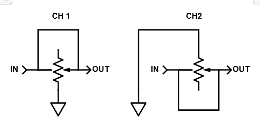

I'd like to replace the dual mono volume pots in my HV V2 with a stereo volume pot plus a balance pot. I know there are varying opinions on using balance pots; I'm not interested in that debate... Let's just say there are WAF considerations...
Anyway, I have the Alps BX2 balance pot pictured here. It seems to be uncommon, and I can't find any info on how to wire it in a preamp. The pot has 4 pins per channel, and I've included a schematic. I'm just having a hard time wrapping my head around how to wire it to attenuate one channel while leaving the other channel unattenuated. Any suggestions?

If you want to use your existing 10KBX2 with center tapped potentiometer, my suggestion would be to try wiring it up as per the schematic below, just an idea, not sure if it's actually feasible.

AX(2) are logarithmic potmeters.
BX(2) are linear potmeters.
The one in the picture is indeed a balance pot. Although a special version with a mid-point.

anyhow, best balance pots are those having zilch attenuation in mid position, then involving resistance if moved from mid

in short - use gglmojo, find datasheet for actual pot.......
some starting info here... or option, if show ALPS goes nowhere

There is a detent at mid rotation, and there is indeed zero R between 2 and 4 at that position. That suggests to me it's a balance pot. I think Chris's suggestion might be the solution. Should be easy enough to try out.
