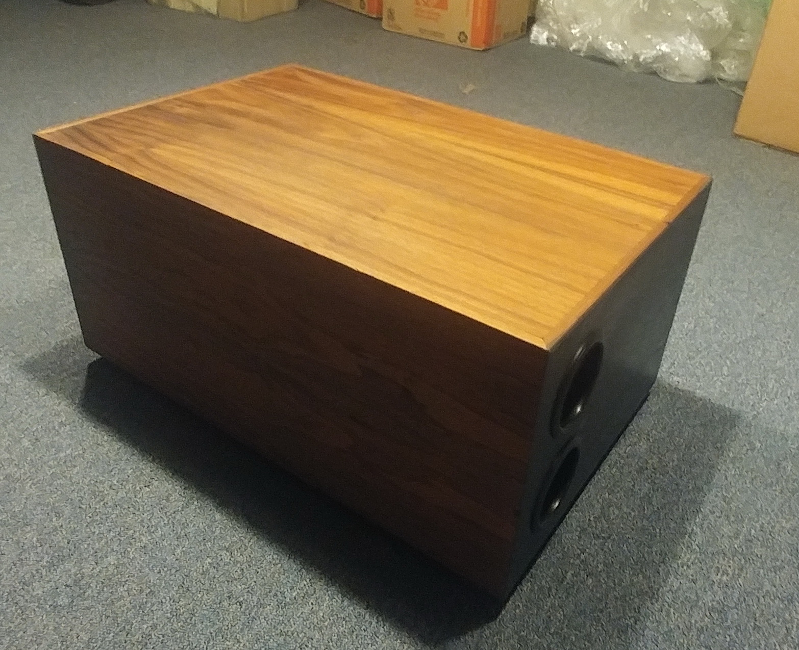

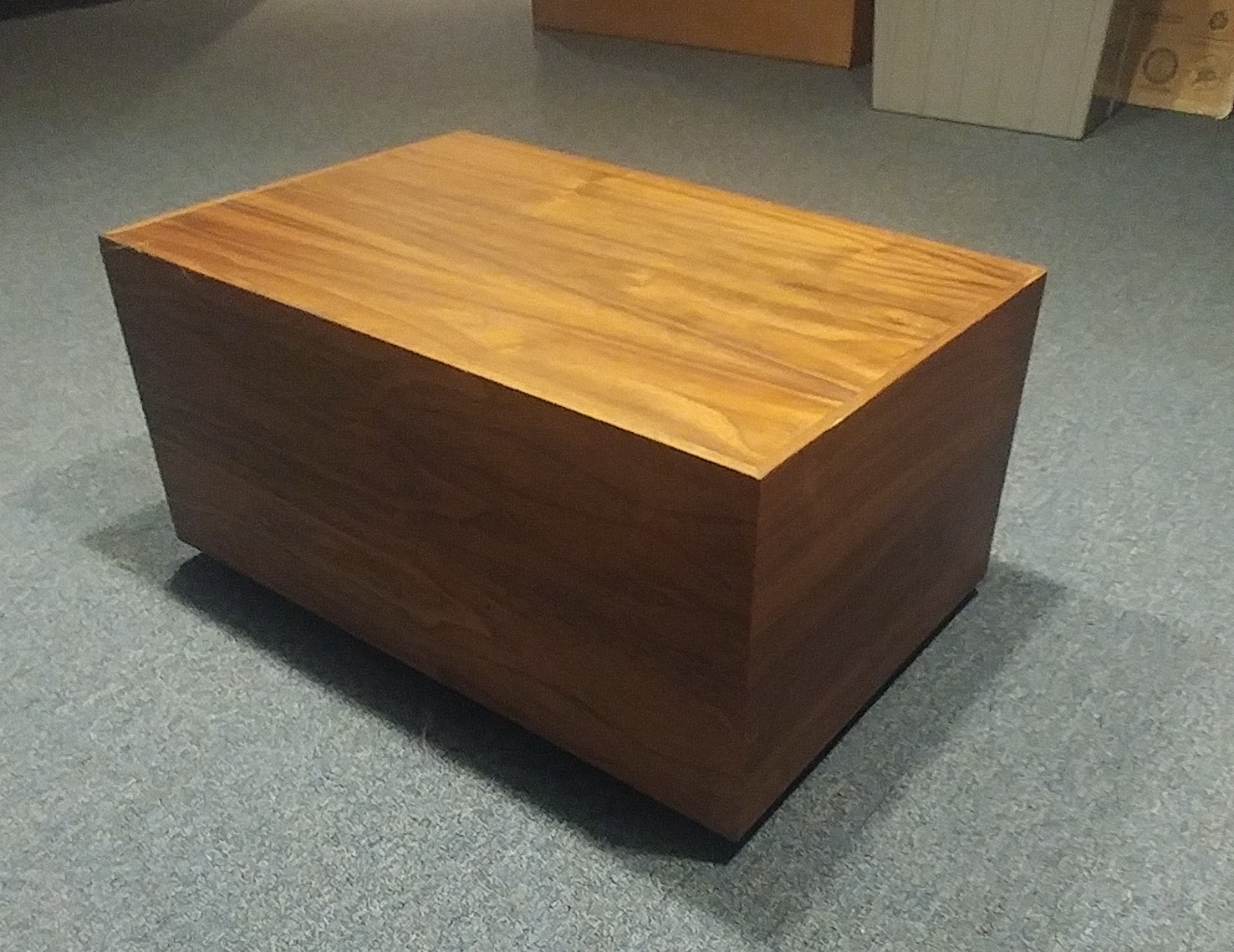

So I have an old Klipsch KG SW sub-woofer I've been schlepping around the country since I bought it in the early 90s, along with my old Pioneer Elite VSX-52 AV receiver I bought at the same time. The sub is a passive pass-through dealy made to be daisy chained between an amp output and the left and right speakers. An early attempt at a home theater LFE, when plate amps we kinda garbage and Dolby Pro Logic (I) was only really sending any sort of bass programing to the left-right mains and center and backs were just really crippled steering speakers, generally supplied by significantly less wattage. Anyway, wired as intended, in never was a very impressive box, it was rated to put out 38-150Hz and always seemed like it was less efficient and didn't go much lower, if at all really, than the speakers I had in line with it so it's internal crossover seemed like it was, I dunno, just moving the same level of bass from one place to another at best with a muddled up gain between the 2.
Quite some time ago, well a few years, I bought a Sony STR-DH850 7.2 AV Receiver and have been gradually filling up the channels with matching vintage speakers (Ohm Acoustics Model Ls), I have 3 pairs now in a surround system, sounds great actually. So I decided to re-look at the old Klipsch after it'd been staring at me from the corner in the basement where it's sat since my last move, more on that in a bit. I bought a power amp off of eBay, a Sony TA-N55ES to power the Klipsch. It does bridged mono, but at 8-16 Ohm load. The Klipsch has 2 dual 4 Ohm voice coil woofers in it and the funky pass-through crossover, which I've never really been sure how the impedance math works with that. Anyway mathematically I should just be able to bypass the crossover, as I'd be using the electronic low pass of the AV receiver, and just wire all the voice coils in series to get to 16 Ohms. However I've seen dozens and dozens of diagrams of wiring multiple dual voice coil drivers together and have never seen one show multiple multi-coil drivers with all the coils wired in series. Is there a reason for this? I mean other than it being kind of a trend to go as low in resistance as you can, well just because?
I know the receiver is a 7.2, with the .2 being key here, and I could just feed both of those into the amp in 'stereo', even though it isn't, and run each driver as a series coiled 8 Ohm, and the sub will only be 5 or 6 feet from the amp. However... I have to go the long way around the room to get there so it may only be 5 or 6 feet away but it's 75 feet of wire in-between, so it's not an insignificant thing to do, I have to buy a whole 100' spool just to get one cable and it's just all the more bulk running around the room. The 75 feet part is also one of the main reasons for keeping it passive, the loss over speaker cable is far less than signal cable at that distance.
The box is about 40 liters, and is a 1:1 bandpass configuration, though plugging the measured dimensions into WinISD I can't see how the 'design' is anything but a wild guess. The ports are pretty much standard, unaltered, off the shelf PA parts 3" Diameter by 5" long, 2 of them. Which based on the two 8" drivers, almost regardless of the specs, just don't mathematically work with the ports. But to be fair the box was made when Sound Blasters were a new product, so I'm guessing simulation software wasn't really a thing yet. The box does seem to have potential to be a better performing bandpass box or even routed out to be a dual driver plus dual passive radiator box. It is well built and tight.
Anyway, the sub has been moved back and forth across the country many times, it was just painted black and looks kinda like a road case and has been treated as such, always just been treated, for moves, like it was it's own crate. So I'm reading this thread on a Klipsch forum and find out these subs came in a bunch of different finishes, not just the utilitarian black mine is. So I though well maybe the wood grain you can see through the black paint is some sort of hardwood plywood, I can stain or something, or at the very least I should just sand it down to repaint it, because it's looking pretty sad these days. So this is what was hiding in plain sight under the black:

I just figured using one signal for both channels since both subs are in the same enclosure.
Yes you can wire everything in series. Won't be a problem but you may only get 150W @ 16Ω bridged.
...and that's fine, I plan to rebuild this sub sometime fairly soon, at which point I'll build it for 8 Ohms, I just want to see how it does, as is, playing on it's own, on it's own amp without the loop through and without the weird crossover. As built, and used as intended, this thing has so many variables going on. But like I said I've not seen a single example of a diagram of anyone attempting to do this, the wiring in series bit.

The amp showed up yesterday, so I got to work on making it all happen, opened up the sub and de-crossovered it. Interestingly, because it was setup as a feed through device, it has 4 sets of binding posts on the bottom, L+R IN and L+R OUT, and internally it has wire leads from the binding posts to the crossover. OK That's easy, each coil can just have it's own set of posts, and that's how I wired it. Clip the leads in the right place and there is no soldering involved, and since this is really a temporary configuration until I rebuild this, I just wire nutted the leads together, it's not audiophile quality, but it's not a permanent solution. So now I can just configure it externally. I looped it up for 16 Ohms, tested it with a short run from the amp, and everything worked pretty well, though gotta say I had to bump up the attenuation on the amp some to really get anything out of it. Then I made and ran the 75 footer, hooked it up, success.
The way it's wired now I could also easily run it as 2 x 8 Ohms, or even 4 x 4 Ohms if I felt like running 300 ft of cable, though I guess technically out of spec for the amp, as that would require using A+B which is again limited to 8-16 Ohms. The amp will drive 4-16 Ohms A or B (Stereo), 8-16 Ohms A+B (Stereo), 8-16 Ohms A or B (Mono), or 16 Ohms A+B (Mono).
Next step, hack the couch so it fits underneath it (not as tricky as it sounds, I don't think anyway). It's one of the advantages of this sub is that it should fit up underneath the couch, the couch is pretty high and empty underneath and the sub fairly low. I should just have to readjust the bottom fabric 'cover' to create a well for the sub to sit inside. Kind of a shame since the sub is all gloriously walnut now to hide it under the couch, but hey I'll know it's there.

Since you have two dual 4R subs, wire the terminals on each sub in series and then wire the subs in series. This gives you 16 Ohms. Use the amp in bridged (mono) mode. Just use mode "A" and speaker terminals A. Each amp channel sees 8 Ohms.
The other way to do it is to run stereo subs. Connect the terminals on each sub in series so that each one is 8 Ohms. Put the amp into stereo output mode. Connect one to the right A and the other to the left A and choose mode "A" via the front knob. You will need either a mono input signal and a "Y" cable, or stereo left, right input cables for the right and left inputs. Each amp channel will see 8 Ohms just like the bridged configuration above, but you will have stereo bass.
The sound will be about the same either way. This is about the only way to safely use this amp with your speakers.
