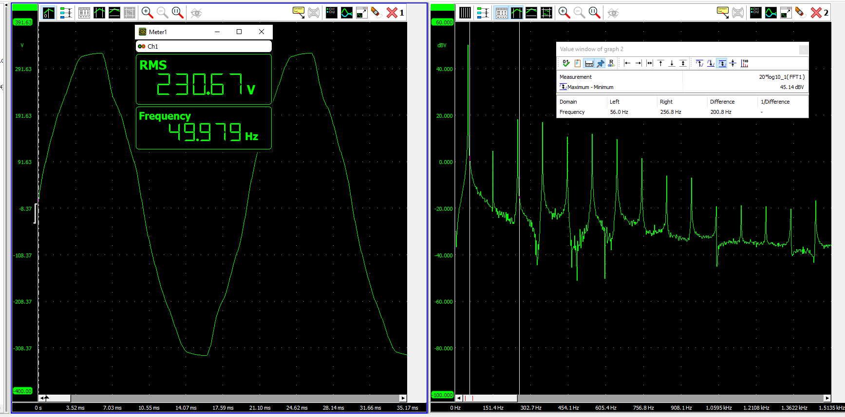

Jan, that's a pretty nice mains voltage monitor.
Good to show what the local mains is like before and after anyone turns on their behemoth audio amplifier with its mains rectified power supply.
It has dc coupling and so appears to be usable across rectified secondary and B+ supplies when kept within the 450V working limit. And the frequency response is not too shabby, even for the base model's 25kHz max span, so should also be a nice tool for measuring ripple voltage attenuation through valve amp filtering stages.
It can also indicate what high frequency attenuation of mains noise can be gained when using an isolation transformer.
