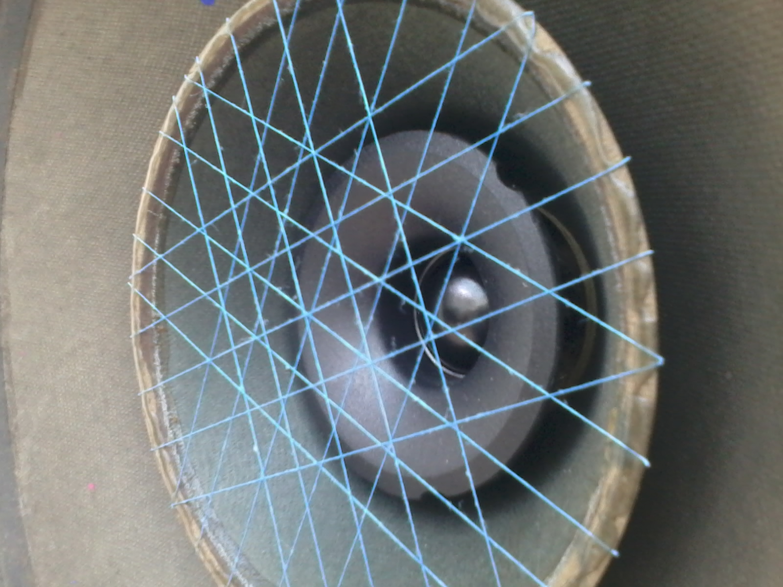

If you are worried about the whizzer cone flapping about, you could try this:
Has anyone else tried criss crossing cotton thread across a whizzer to stop the bell mode resonance?
I stretched cotton thread aver a soup bowl in a very open weave to give hexagon shape 1cm holes (it was a big whizzer), painted it with PVA and let it dry. I then put a bead of PVA round the top edge of the whizzer and stuck it on. Stopped the bell mode completely on mine. Reversible too at a push. I have a photo somewhere and will try to find it.
from here: http://www.diyaudio.com/forums/full-range/185012-whizzer-intelligibility-5.html#post5003456
I also made these coaxial using a dome tweeter, but that is another story...
Brian
Hi there Brian: Re😛ost #12, Restrain the wizzer with threads is a neat solution. I'll bet that the glue around the wizzer rim is adding to the effect. Maybe gluing the strings* with "glue dots" would further enhance the effect? *(restrain the wizzer directly, then glue the strings with applied dots, "enhanced enable process"...? ...regards, Michael
