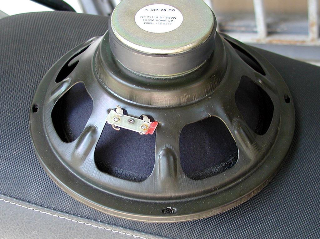

Would you consider this pictured woofer that has ideal design as a metallic common type?
To be honest, my woofers needs new foam surrounds, but I am making second thoughts of getting something more wiser designed.
From the other hand this is a Philips made in Belgium and today things are different with all this manufacturing in Asia.
And I have nothing against Asia, but it supposed that engineering makes the difference in sound and I have doubts that generic woofers could have the a wider bass response as this speaker does.
Basically my woofer is designed for operation in sealed cabinets, and even if I look for replacement in the specifications it is not mentioned if a specific woofer is designed for open or sealed cabinets.

Couldn't find any data on that particular Philips woofer, but by the size of the magnet I would suggest a closed box of about 20-30 liters. It is very likely a highish Qts design with low Fs, so it is well suited for sealed boxes. Yes it is your typical "cheap stamped frame", so it could benefit from damping and applying absorbing pads.

very wise decisions about the Philips drivers. they are almost irreplaceable. usually very high sensitivity and good quality sound (paper cones, coils and magnets).
if you want leave them behind, I suppose they are working, and design or choose a new speaker for DIY. State your objectives like vintage look or sound, sealed, size of frame/cone, 2 or 3WAY and internal volume or dimensions (int. or ext.) for the interested speaker application.
