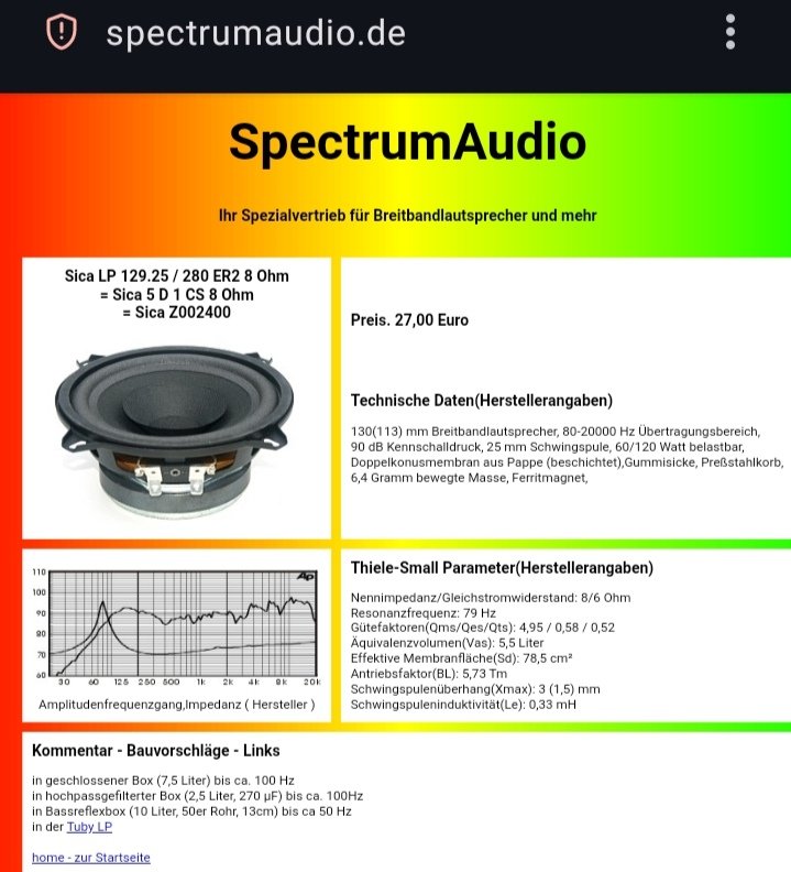

Ideally but not necessarily, 8 ohms with a sensitivity around 80 - 83db.
Why the "ideal" requirement for such low sensitivity?
The Dayton driver has a sensitivity of around 88 dB (sensitivity figures are sometimes overstated by manufacturers).
Attenuating the driver to 80 dB would require a high power series resistor that would not only waste amplifier power, but decrease the amplifier's damping factor with the effect of raising the system Q.
