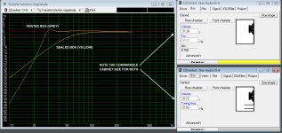

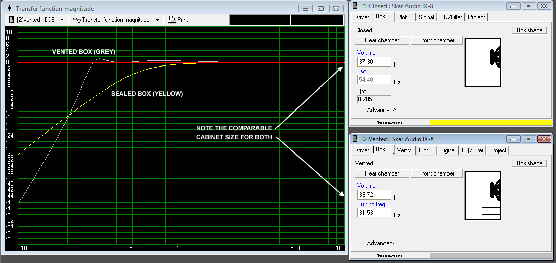

I can go vented instead. I was going to go for a bigger sealed box.. I am going to use a DSP to eq once I put the monitors in his room. He will use them near field mostly but crank it listening to final productions.
Well, in that case, make sure that the DSP has a 2nd order highpass at the port tuning frequency.
Sealed would make a good choice. Also make sure there is a good woofer in it. There should be enough output over a wide enough range of frequencies and your amp should be able to drive it, especially allowing for EQ.I was going to go for a bigger sealed box.. I am going to use a DSP to eq once I put the monitors in his room.
Then thechemist needs to know that vented may not be a wise choice when EQing, and that EQing a closed box can give you the same response anyway.

Well, that's true as long as Xmax allows, as I already mentioned earlier. Looking at nearfield reference SPL requirements (85-95dB), there shouldn't be any problems with the sealed method either.

I'll build both boxes and see which one sounds better
