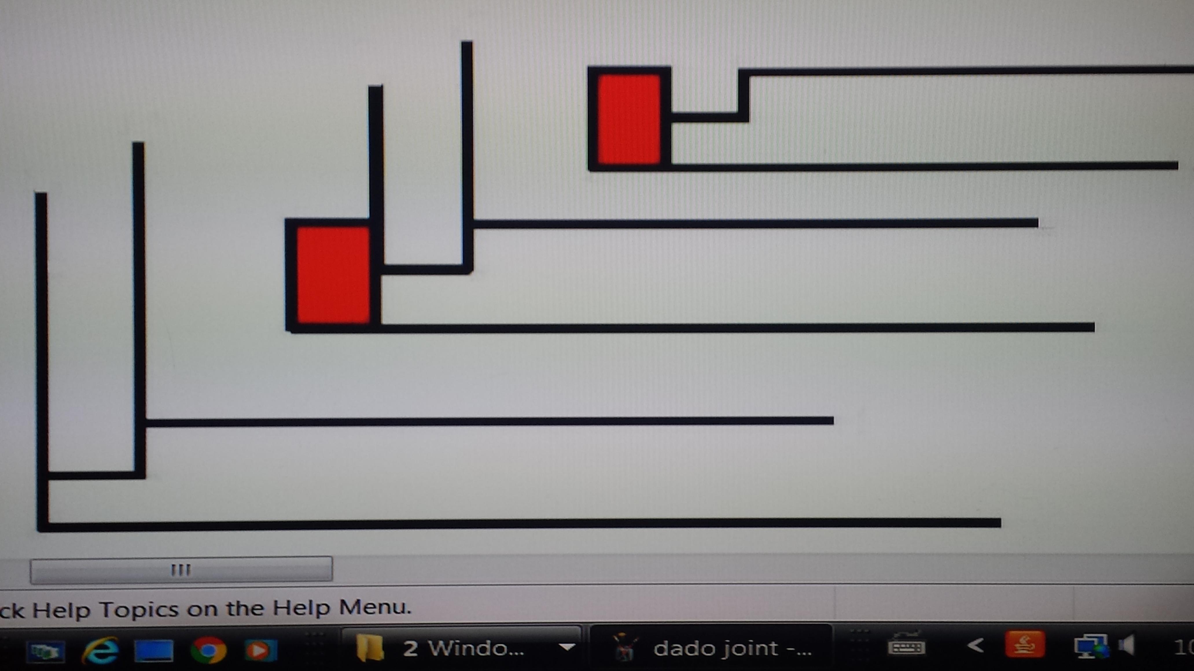

For some reason the prog wouldnt save in larger form so I improvised a pic 😱 Top view of where Im going with it.
Ill form the dados leaving a bit extra to sand flush with fenced sander. That gave me much cleaner finish on other jobs. this time I figured with it higher chances averting disastrous chunk flying off by the router, have had that happen lol. As you can guess Im not Mr trick with them, keeping it basic.
I do miss the saw while its broken. I also wanted to dado to inlay vertical strips of dark wood every 3 or 4 inches around the perimeter. I wont press my luck this time.

Sorry, but what is a 'dado end joint' ? Not a term I've come across here. I can only surmise it to be what I would call a half lap corner. We are Suffolk though 😱
It looks like what he means by a "dado end joint" is what is commonly called a rabbet joint. It looks like dischoe wants to cut a dado, glue up the pieces, then cut/sand off the part represented by red in the illustration, leaving him with a rabbet joint. I've actually used this technique before; it simplifies glue-up if you're not well equipped with clamps and/or you don't want to use nails or screws to hold the joint tight while the glue dries.
If the dado is cut cross-grain, then simon's idea of using sacrificial pieces to avoid tear-out is a good one. If the dado is parallel with the grain, then this step shouldn't be necessary.
