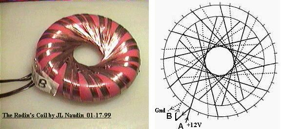

I'm using Google Translate and it's misunderstood. It doesn't matter if you connect a speaker or not. There's sound coming from the device body. You can hear it in the video.
I use it to drive Rodin coils.
Perhaps a Rodin coil presents an inappropriate load to your amplifier.
