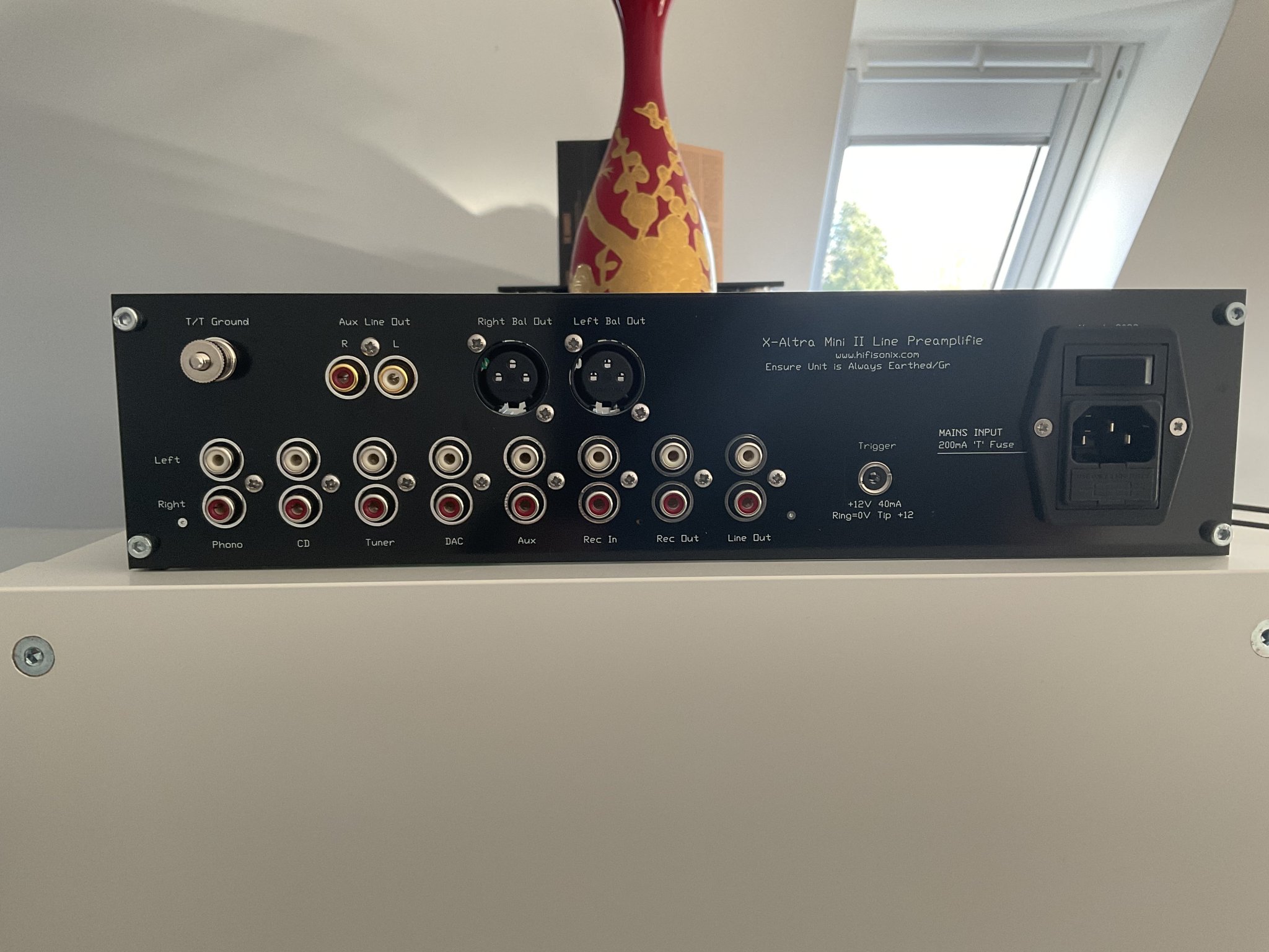

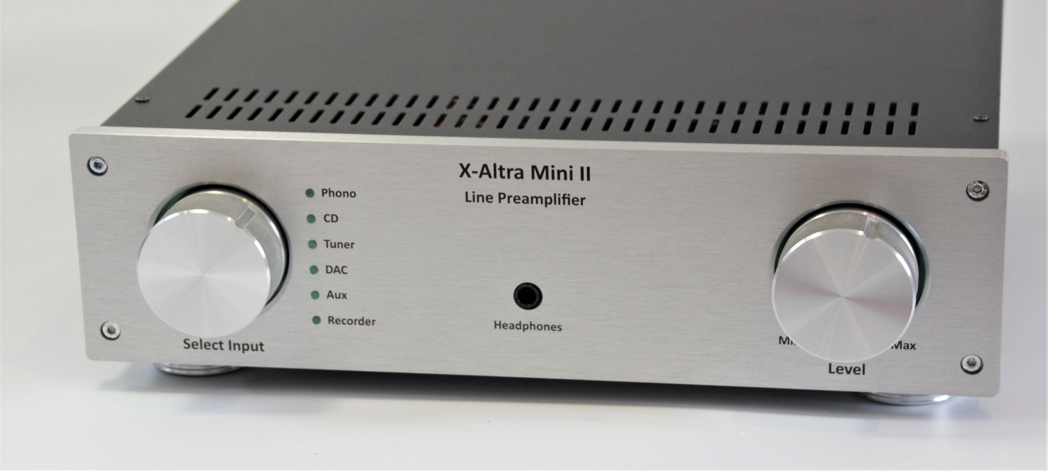

The X-Altra Mini II preamp is now completed. I've updated the webpage on my site with the final measurements. All the PCB's are now available and the BOM is also up on the website for those interested in building one.
Gianluca at Modushop has kindly agreed to supply Galaxy Housing Kits with a machined and laser printed front plates, base board, sides and top and bottom plates. The rear panel follows the same technique used in the X-Altra Phono EQ amp from 2020 and uses a PCB - so no drilling and filing required. The result is a professional looking final product that wont look out of place in any system.
The standard X-Altra Mini II uses manual control for volume and input selection and is referred to as the 'Classic' and the housing from Modushop is here 'X-Altra Mini II Classic'.
A remote-control board using the Apple TV Remote is also available for the X-Altra Mini II with an optional front panel that incorporates the IR window cut out along with the Plexiglas IR filter from Modushop here: 'Modushop X-Altra Mini II Remote Control Housing'.
If you want remote control, you have to upgrade your PCB set with the 'Remote control' option - details on the Hifisonix website. The remote-control board is shipped with the NXP LPC1114 32-bit ARM controller preinstalled and programmed. Builders will have to source an Apple TV Remote - these are available worldwide from your local Apple Store for around $20. Do not use cheap plastic imitation Apple TV Remotes as these will have problems.
Here is the link to a pdf presentation that gives the full technical detail and the measurements: X-Altra Mini II Main Presentation
To build this preamp, you will need good SMD soldering skills down to 0805 and a temperature-controlled soldering iron with a needlepoint tip, a pair of good quality needlepoint surgical tweezers and 0.5mm diameter solder.
Here is a link to a document that gives the dimensions of all the PCB's with mounting hole requirements for those people that want top use these boards in their own projects X-Altra Mini II module dimensions
As always, any questions, please feel free to post them up here.

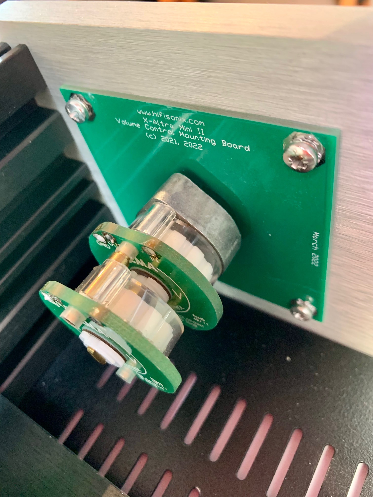

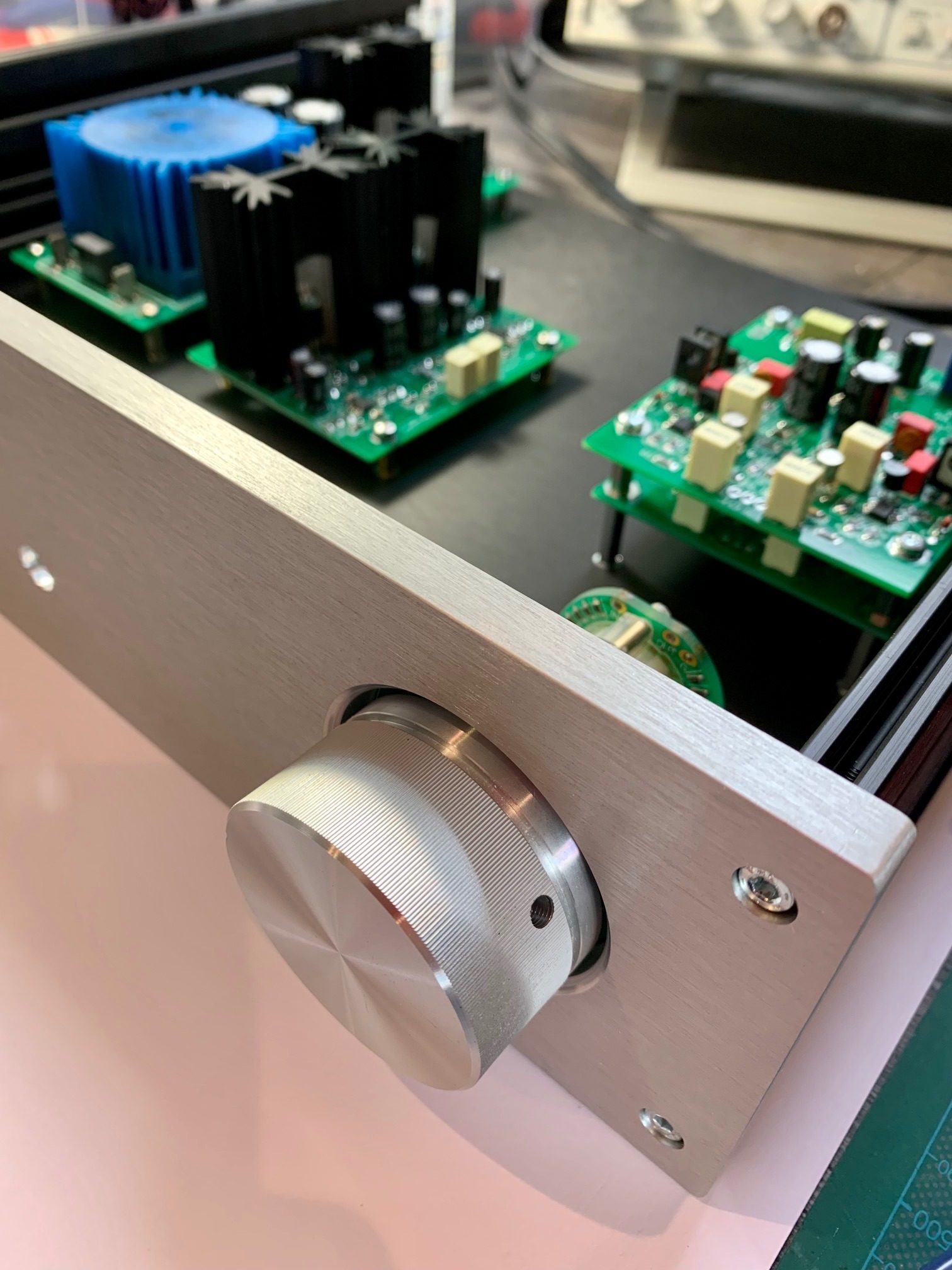

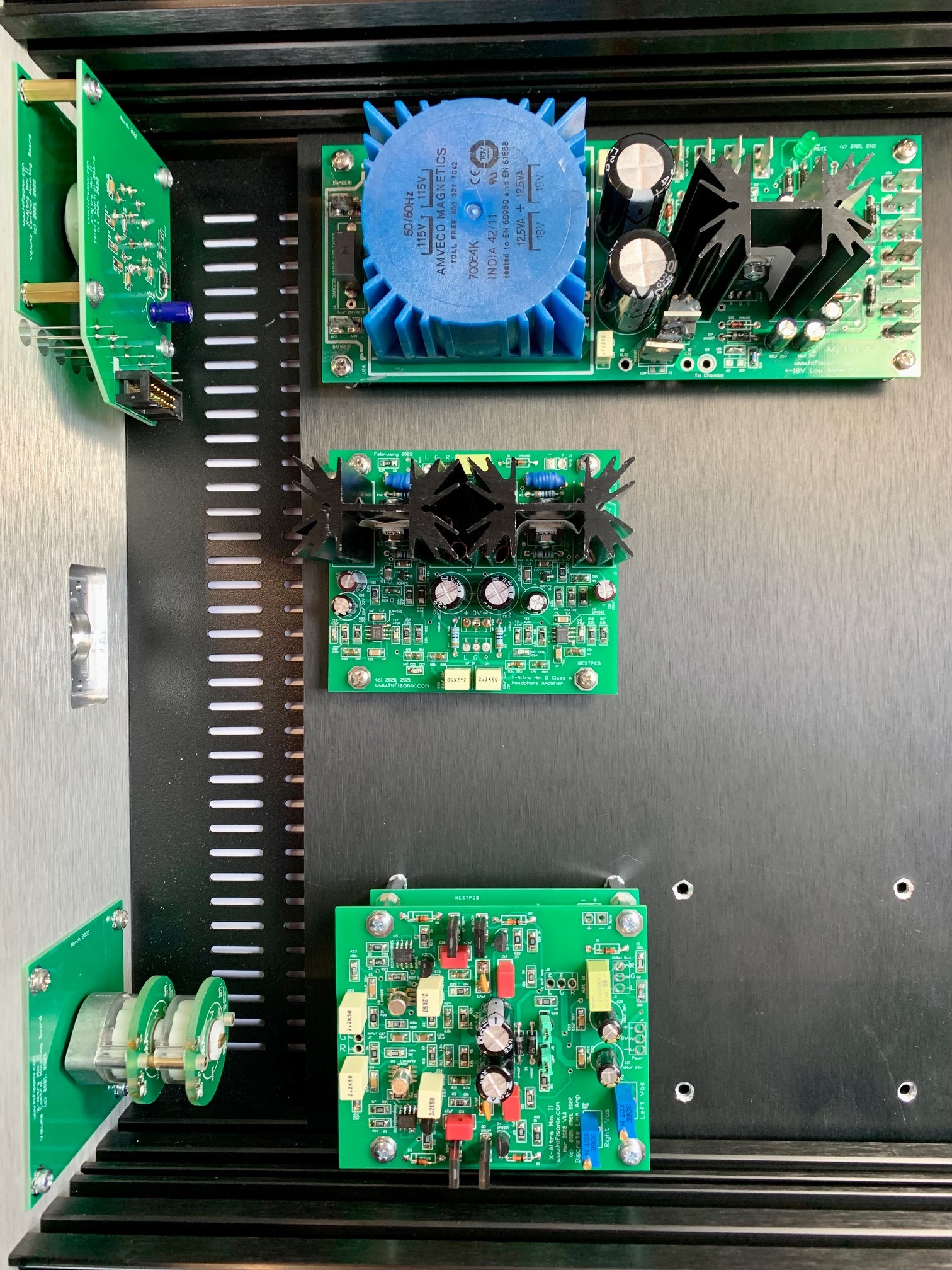

Mounting boards on the base plate today and got the input select mounted and set up as well
Input select
General view of the module layout. At the bottom is the discrete line stage and under that the balanced output _ aux output opamp based line stage. Above that the headphone stage and at the top the 25W PSU. The phono stage (spin 2) and rear panel still getting made - probably only get that mounted week after next
I'm using the 20k log Goldpoint level control salvaged from the Symphony preamp.
Input select

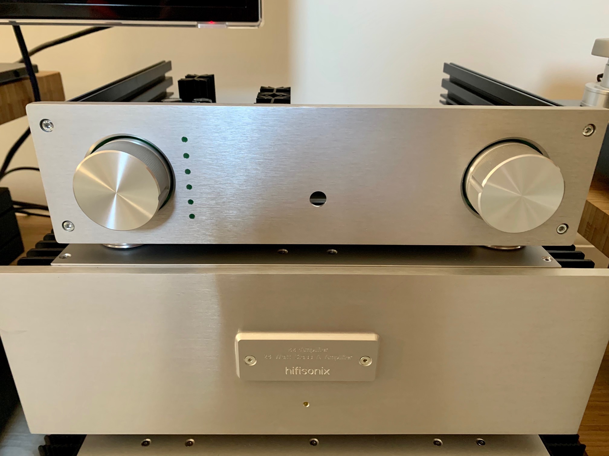

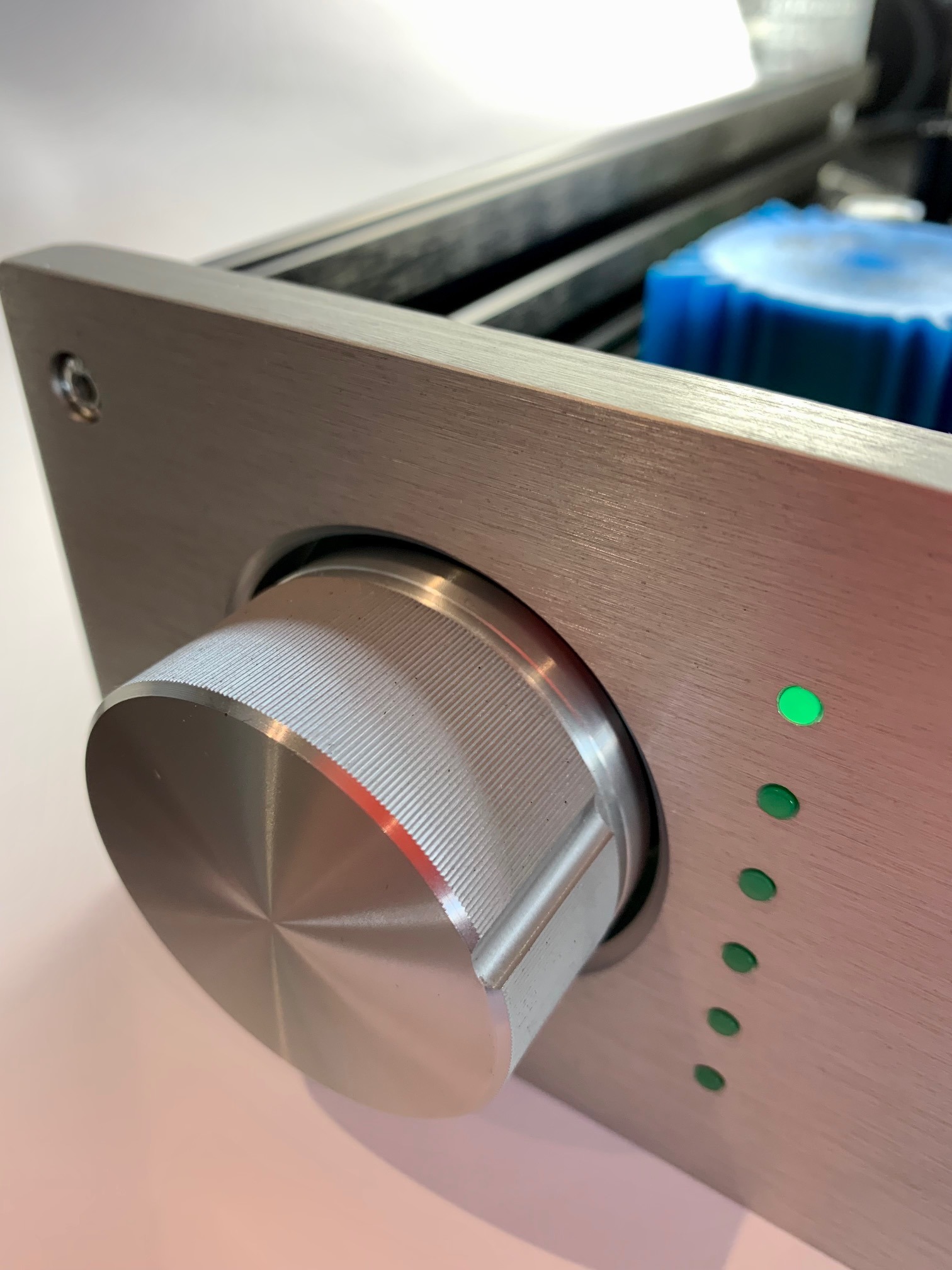

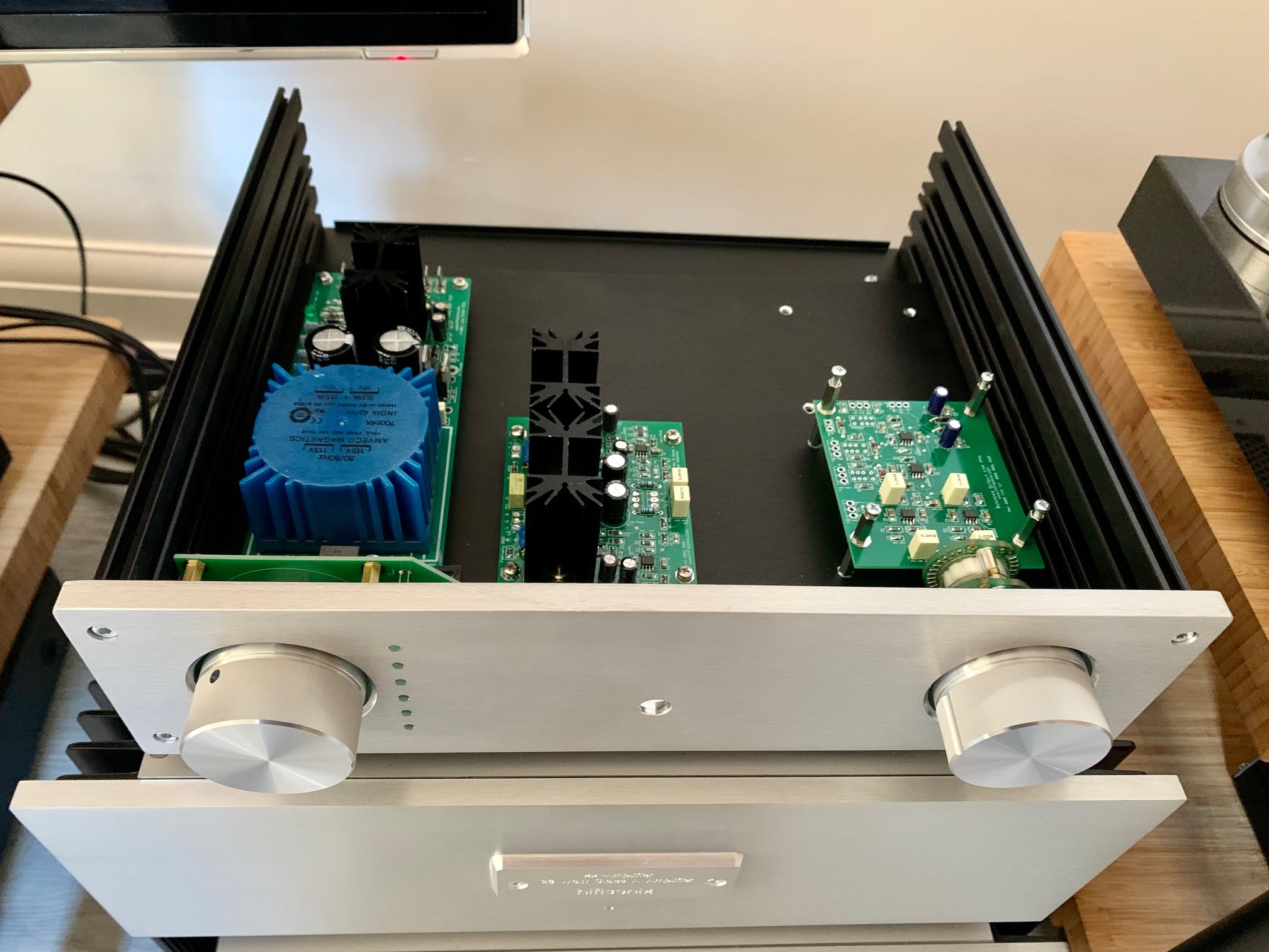

Last pictures for a while until the MC/MM board and the back panel arrives. Today I assembled the final version balanced output line board and mounted the feet on the preamp. Once the rear panel arrives, final assembly and wiring can start and then onto measurements.
Sitting on top of the kx2
Tomorrow, the H/phone socket will be mounted.
