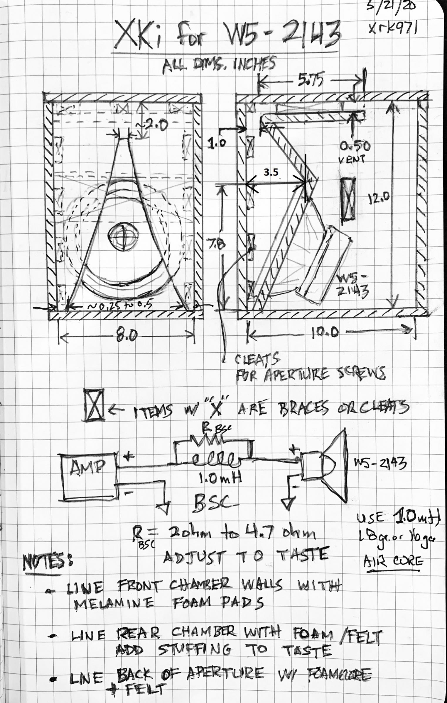

Update (5/21/2020): My Plans for XKi W5-2143 here.

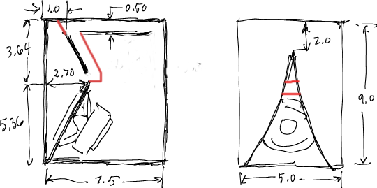

As a test case, I designed a box that can reach 50Hz using a nominal 3.5in driver - the Dayton RS100P-4 (paper cone). This driver has a suitable moderate Qts to allow fb to set below fs and has good xmax of 4mm and a relatively powerful motor. The 6th order bandpass design was a 4.0 liter rear chamber and 1.0 liter front chamber with a 0.5in x 5.0in x 9.0in long vent, and a front chamber vent consisting of a 5in dia aperture.
I converted these volumes and vent dimensions into a box that has internal dimensions of 5in wide x 9.0in tall x 7.5in deep which then provides the correct volumes once the vent volume and driver volumes are subtracted. The front K-aperture is sized to have the same cross sectional area as a 5in dia hole, which was approximated by the area of a triangle that is 5in wide x 7in high, accounting for the curvature and offsets near the bottom.
The box design looks like this:
Here is a photo of the inside during construction showing the bracing and folded vent arrangement leading to the top of the front chamber (although not ahown, there is a piece of open cell foam on the bottom and I put a wad of pink fiberglass in the main large volume to damp the HF's from reflecting back onto the rear side of the cone):
Here is the completed speaker - still retains the look of a very small K15:

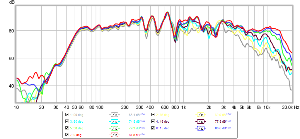

And here is the measured frequency response about 0.5m away along the axis of the driver centerline - it has the characteristic Karlson "W" dips and a falloff near the bandpass followed by the direct radiator output which lets it reach up to the HF limit of the driver (about 14kHz in this case). The measured f3 is 51Hz! An amazing concept for anyone who has ever tried to scale a K15 down will realize. Predicted max SPL at 4mm xmax is 98dB in 2pi space:
How does it sound? Very nice - sound clips attached below. Dispersion was very good as evidenced by the polar data showing very little variation in the response from 0 deg to 45 deg (or 90 deg full cone, and even out to 60 deg the variations are quite small). This is one of the biggest advantages of the Karlson aperture is a uniform polar response:

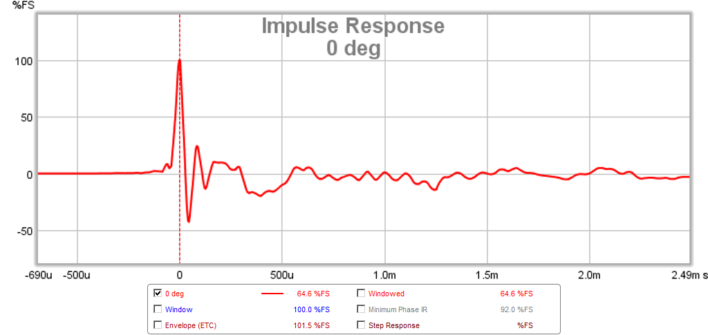

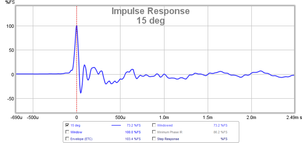

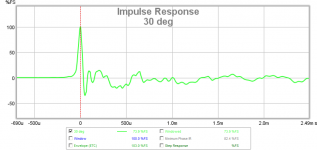

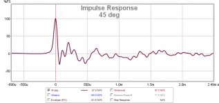

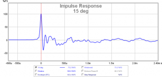

The transients are also clean as you can see from the measured impulse response. Furthermore, because the polar response is so uniform, the impulse response is also uniform along different angles. Many open face speakers will exhibit vastly different impulse responses because they have beaming or cone breakup modes that are angle dependent.

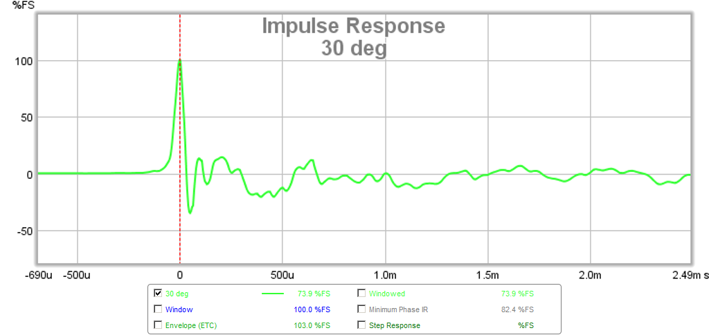

Here are the IR's for 0 deg to 45 deg (note the similarities from 0 deg to 45 deg):
This is a tiny speaker with a tiny driver, but it sounds quite big. Now, the neat thing about this methodology is that if a 3.5in driver can hit 51Hz, a 6.5in or 8in can probably do 40Hz. This can also be used for a sub woofer with a good pro audio 12in driver like the Faital Pro 12HP1030 and achieve 120dB SPL and mid 30Hz...

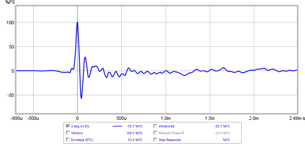

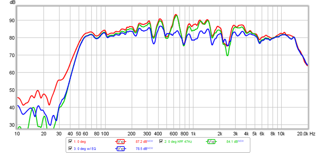

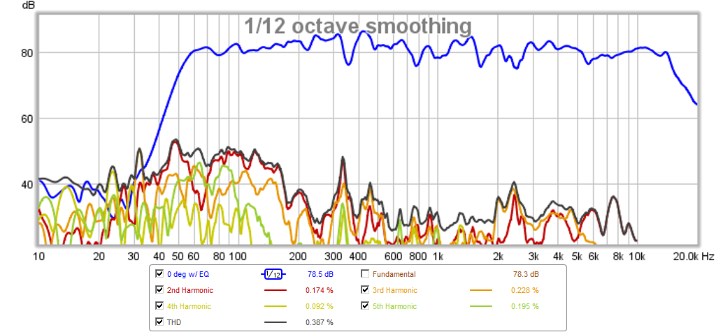

I applied a -24dB/oct high pass filter at 47 Hz to reduce cone excursion and some EQ to see if we can't make the response less bumpy. Here is the result of the HPF and EQ:
Here is the impulse response after the EQ has been applied - a little cleaner:
Here is the harmonic distortion - a lot of this is the result of the foam core cabinet vibrating. CLD can knock this down quite a bit but I have not done that yet:

Edit Jan 25, 2015: effects of EQ, high pass filter, and aluminum vs paper cone - aluminum cone seems to have more bass.

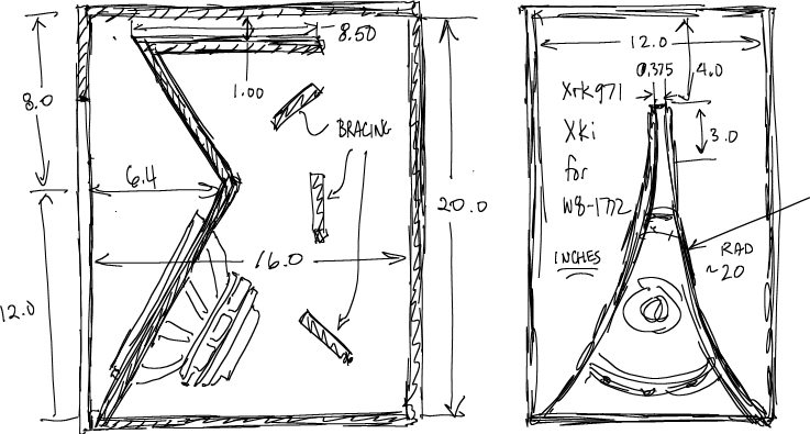

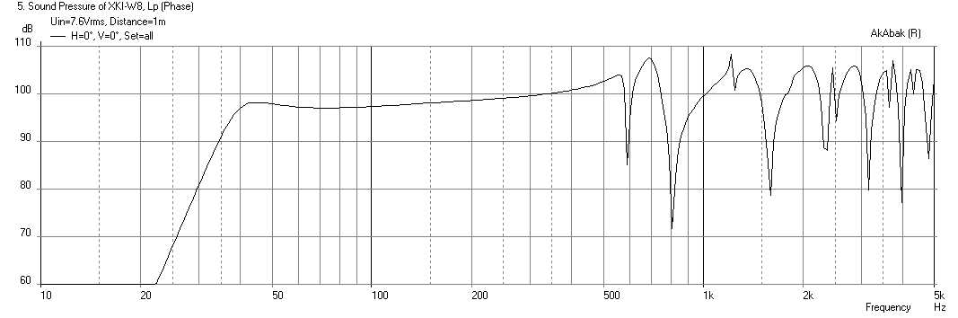

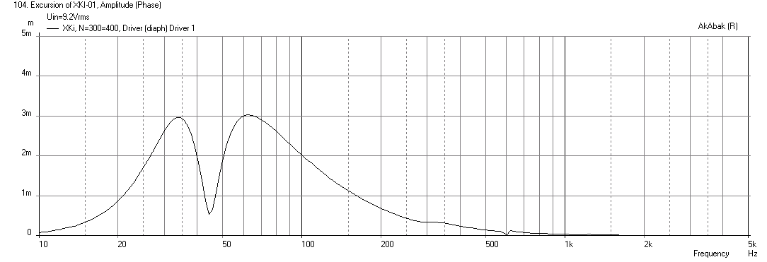

XKi for W8-1772

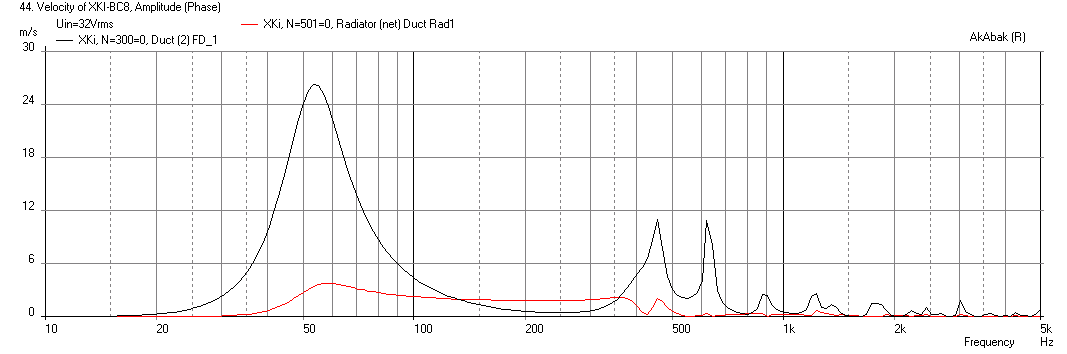

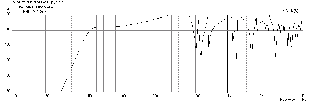

Here is what I came up with for the XKi with a W8-1772. The Vas on this driver is rather large so the cabinet is rather big, in my opinion for something that has an f3 of 43Hz.
The design ended up at 60 liters of active volume for the front and rear chambers with a vent of 12in wide x 1in high x 8.5in long. This translates to a box of internal dimensions of 12in wide x 20in high x 16in deep. Is this size still suitable for you?
Here is a sketch:
Here is the predicted bass extension and max SPL at 9.2 volts to hit xmax - ignore the peak at the upper bandwidth - that goes away when you have the Karlson aperture, I think 103dB is a respectable number for the 1772 and should be great for home listening. Additionally, the beaming normally associated with a 8 in full range will be greatly reduced with more uniform polars due to the K-aperture:
Here is the predicted cone displacement with a -24dB/oct HPF at 37Hz:
So, what do you think? I think keeping this speaker small will require one to use lower Vas pro audio coaxials.

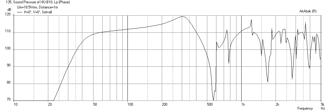

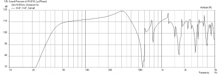

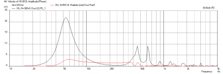

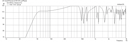

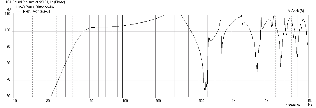

XKi with Beta 10CX
The Beta 10CX can go into the same 60 liter box that the W8-1772 uses but with slightly longer vent of 9in. Should hit 110dB at xmax and f3 of 44Hz. In practice, I think the f3 goes down maybe 5 to 10Hz when actually used with a Karlson aperture.
Here is predicted SPL at xmax without Karlson aperture. The peak will flatten out and the HF's bandwidth will be higher.
the size is good enough - how does power handling compare to W8-1772 in say a 2 cubic foot reflex/MLTL? I also have Beta8cx which might make something.
For a direct comparison, if I remove the front chamber and K-aperture and let it operate as a bass reflex with the same vent, you can't drive it as hard. max SPL is now about 98dB at xmax.
As a comparison, from earlier post as a BP6, you can drive up to 9.2v and get 103dB:

Here is an example of this cabinet for a PA application using a B&C 8CXN51 coaxial driver. It makes for a pretty small cabinet with internal dimensions of 10in wide x 16in tall x 9in deep. With 0.5in ply, the external volume is exactly 1 cu ft. I modeled it using 18 liters active volume and added vent volume as well as driver volume. With a 10in x 1.0in x 15in long vent, the tuning freq fb is 56Hz with an f3 of 52Hz. This little box is capable of 112dB when driven by 32 volts to hit an xmax of 6mm.
Here is the sketch:
This is predicted frequency response of the just the band pass 6 before the Karlson aperture is added to smooth things out and allow HF's to escape:
Here is the vent velocity at max SPL in case you are concerned, just at the limit of what is acceptable - noise will be reduced as it is shaded by the K-aperture:
I think this may be a nice unit with even polar response over 90 deg full angle. This SPL is also suitable for use in THX certified HT applications.
Here is the sketch:
