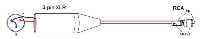

XLR to amplifier board input wiring.
I m making a 2 channel amplifier that has 2 wires for each channel for the input that is used for RCA. Now I also want to use XLR along with RCA inputs but I’m not sure on the XLR as it has 3 wires Hot, Cold and Ground, how would the wire to a amplifiers board that has only 2 inputs for 2 wires not 3?

RCA sleeve (-) should go to pin 3, pin 2 is "hot" (+). Although sometimes the rules are broken by manufacturers and problems arise and one has to figure out what is wrong and then build suitable cable.

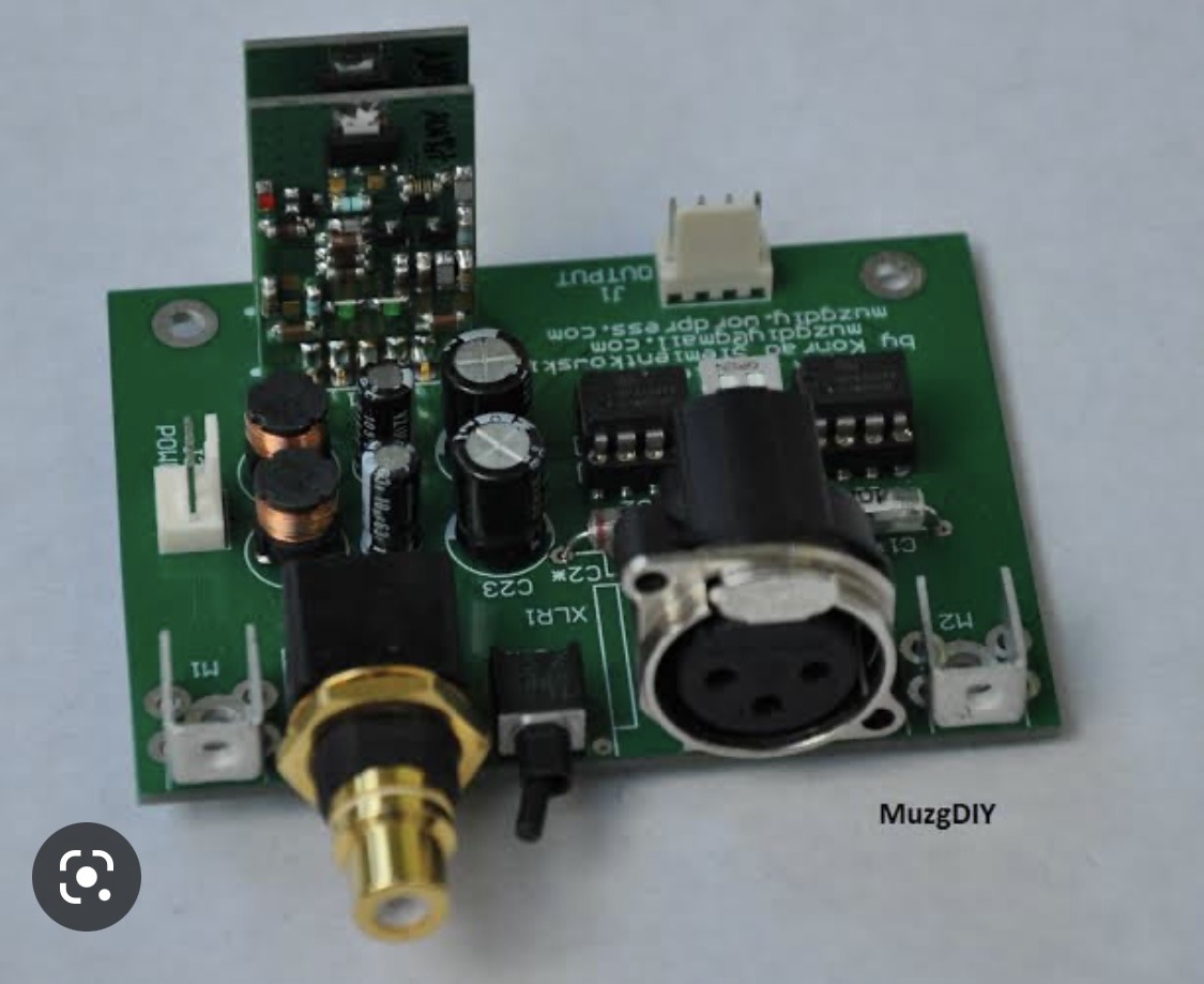

Like this but where you get it from
The XLR signal pins are 2 and 3, you would connect pin 2 to the RCA hot and pin 3 to the RCA shell.

It would be better to use shielded twisted pair cable instead, connect RCA to the twisted conductors and to pins 2 and 3 on the XLR end. The cable shield should connect to pin 1 on XLR end only. Now the cable shield would work as extension of the Haffler chassis protecting the unbalanced connection (cable) from stray electro magnetic fields. More importantly noise current of Haffler chassis (pin 1) would not be connected to its own input (pin 3). The DAC ground is now still connected to Haffler audio circuitry via pin 3 but no can do so its as good as it gets without transformers / balanced output.
This is connection # 17 from Rane docs https://www.ranecommercial.com/kb_article.php?article=2107
