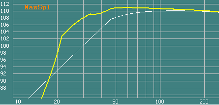

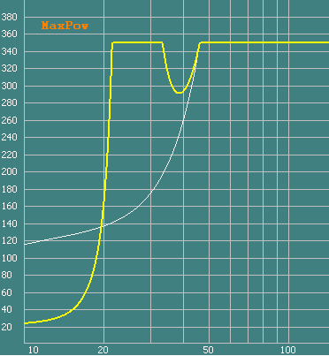

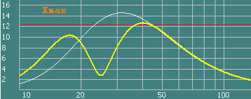

Hi, i don't know you've opened a new thread ?
My Sim with that driver with both a Closed "White" & Reflexed "Yellow" box of 1.5 ft^3 The reflex fb = 25Hz. I used a 24db LR HPF @ 20Hz for both
Reflex box vent Int round size = 102mm x 847mm whose area needs to be added to the Net box size. Doesn't have to round, change the shape in WinISD.
The reflex seems ok to me 🙂

... does that mean that the driver in the 1.5 ft^3 box would be playing just as loud with 150W supplied as the driver in a 0.5 ft ^3 with 350W supplied? Would I only need an amp rated at 150W?
Thanks!
Yes and yes. I think that's the 5th time I've answered that now.
