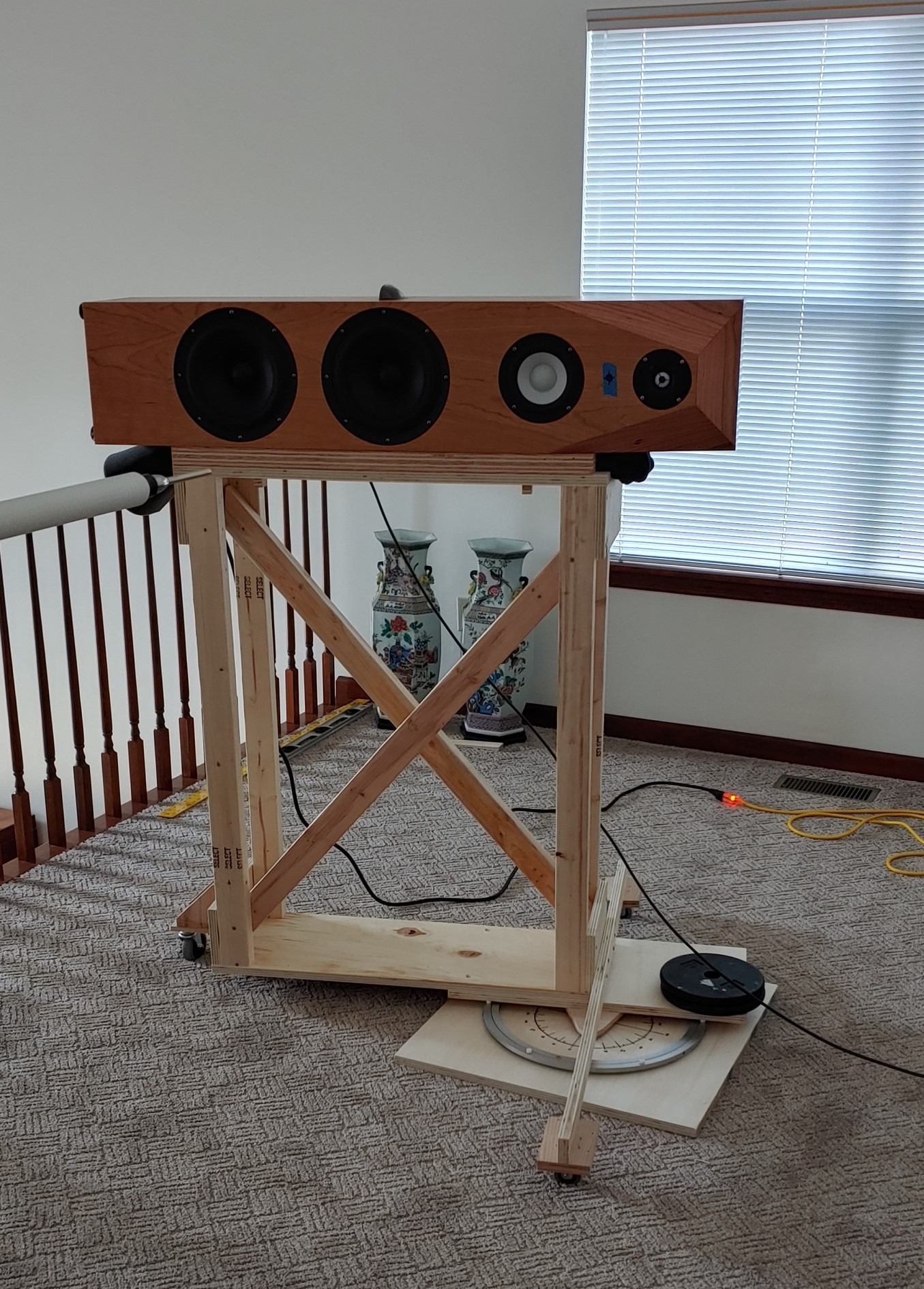

Actually once you start to think about moving the mic (instead of the speaker), for the vertical plane measurements you could make a template from card or ply with the appropriate angles and mic locations. Then, maybe with someone holding the template for you, you move the mic to the next location. They just have to hold the template at right angles to the baffle (vertically and horizontally).I feel your pain but its the dodgy sound card that is the root cause. I new/better one would have two channels and provide phantom power for the mic. Laying a tower speaker on its side at the top of a tower is indeed a challenge. laying it flat on the ground not so much if you have a large flat spot. then you can move the mic along a radius a calculated chord length and do ground plane measurement...
At this stage, for the vertical plane, I'm really only thinking about measuring 5 and 10 deg. up and down.
It's possible. I move the mic when measuring corner speakers as the room corners are a part of the speaker.
However when you use an acoustic timing reference it's necessary to move that extra speaker the same amount as the mic, which can be a challenge. Also, as you go close to the floor or ceiling you get a shorter reflection free time.

It is a real challenge to do this. The speaker must be positioned on its side, elevated, and then rotated about a fixed vertical axis. For a tall speaker, the only real option is to build (or buy) a rotating table or stand. Attached is a photo of what I built.I am dreading doing vertical plane measurements. It's easy to rotate the enclosure for horizontal measurements, even without a turntable.
But rotating the enclosure (it's 1240mm high) around the X axis to get vertical plane measurements sounds very difficult to me.
Someone suggested laying the enclosure on it's side, but that would still entail a completely new setup with the mic as well as the enclosure.
I'm just not sure if it's worth the effort.

Where I propose to take my outdoor measurements, the ground (driveway) drops away from the test location, and any other objects are around 30 metres away.It's possible. I move the mic when measuring corner speakers as the room corners are a part of the speaker.
So the idea of being able to keep the speaker fixed during vertical plane measurements is very appealing.
However I take you point regarding the importance of keeping the timing reference uniform throughout the measurement process.
