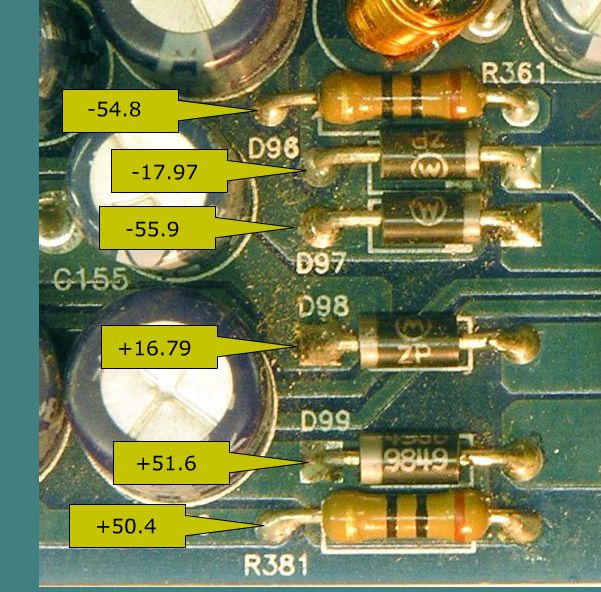

Are +50 and -50 rail voltages? I see rail +, rail - as well.
Assuming the schematic is correct blown R109/11 mean the output is at +rail voltage. Is this the case? Also, I take it +/-rail is something like 40 V?

Regenpak, X604 power supply appears to be identical to X604. Attached is the picture showing the rail voltages Perry shared in another thread (X603). I am not seeing a short on the output (Ohmed out amp outputs between positive and negative rails). Though I did discover difference in impedance between R110 and positive reail. On the bad channel I measure 1.03kOhm and the good channel 5.9MOhm. The problem went away when I removed Q65 that was also shorted. Looks like the same part as Q51.
I am open to any suggestions what else to check. Will continue poking around.
