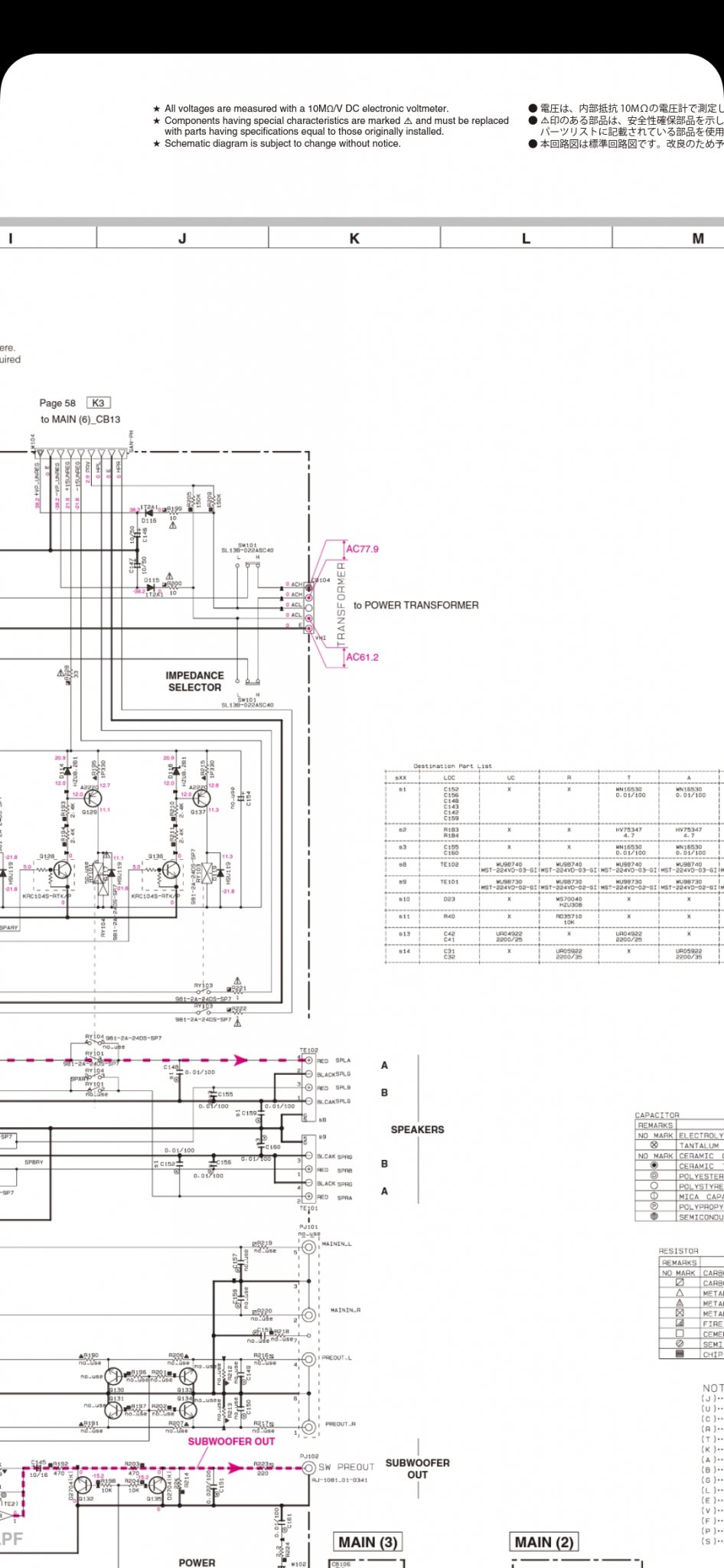

I think it's secondary dead,no 77.9v & 61.2v AC on CB104....

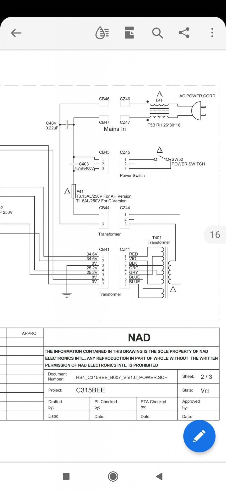

Please help me if a can to adapt the transformer of NAD C315 for Yamaha.

SM NAD
https://www.manualslib.com/manual/1186901/Nad-C-315bee.html

Schematic shows thermal fuse on primary. A Blown/open thermal fuse would not cause other
downstream fuses to blow.

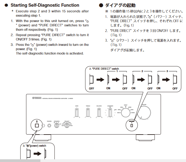

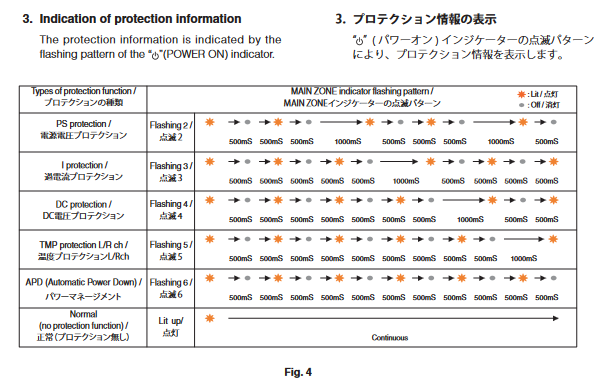

Amp is probably in standby/protect so main transformer may not be energised. You probably
have a failed power supply, blown outputs or... Refer to the self diagnostic mode in the service
manual.
Check for charred/discoloured resistors around the power supply and voltage regulators also any signs of stressed capacitors (unlikely in a "new" item). Possibly a short to GND, you could try diode testing each regulator looking for a short????
