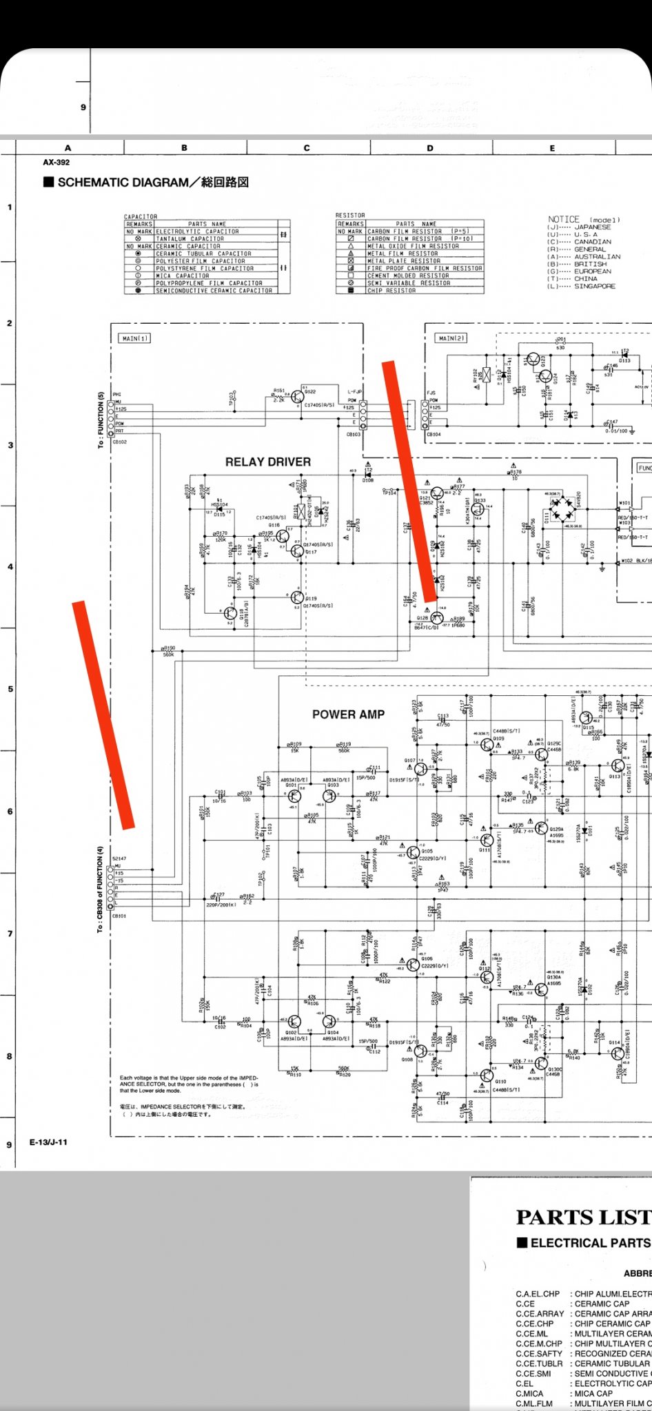

Hello.
Need help for Yamaha AX 392 integrated amplifier.
The power amplifier works fine.
Preamp problem, distorted.
Problem for -15v....only +6.6v.
+15v ..ok.
Where I need veryfied for -15v.........Q128?
Thanks.
SM

So the polarity is also wrong: positive instead of negative. Checking the collector, emitter and base voltages (with respect to ground) of Q128 would be a logical step.Problem for -15v....only +6.6v.
Thus start checking common parts: PSU, biasing networks, multiple units switch(es), etc. May be two simil faults, but more readily that a common fault offending both channels.
Check surrounding parts. Usualy a semiconductor goes difunct with several other parts: diodes, resistors, and other transistors.
Its +40v on collector of q117 & q116.
Diod zener d106....ok,but +40v on both sides.
Resistor R171...ok...681ohm.
On the base and Emitter of q117....q116... negative voltage -2.4v.....
I desoldered q118 q119 ,not protect mode, Amplifier works with only one channel.
2 transistors are ok

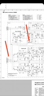

Hi Lynyrd,
Would you post a PDF of your service manual or a link to it? I've downloaded a manual but it must be a different version, as I can't spot the devices you mention in your posts.
Thanks!
Thanks!
Thanks. First link I tried, but my access is very erratic. Finally got it!
Have you tried procedure on manual page 4 to reduce idle current?
