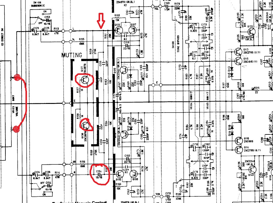

A typical DVM possibly may be usable on its lowest AC range but you would need to be sure it could read low level sine test signals with some repeat-ability. Typical these might be just a few 10's of milli volts. You would also need a mono test tone of around 400Hz which is easily made using Audacity and can be an MP3/WAV/WMA file as desired.
I'm tempted to say that you should just try shorting the inputs together which would guarantee equality. The circuit also seems to have an error, an omitted coupling cap on the input to one channel.
Its also possible one of the muting transistors is leaky which would cause a reduction in level.
If you short the wipers of the volume control as shown then that forces an equal signal at that point. If the level is still different between channels then remove the two muting transistors and retest. If its still different then change the two caps Jon mentioned.
If that's still no good then you need a scope to do more thorough testing 🙂

Ah, thanks for that comment Jon, I now understand the response from Mooly and the annotations on the wiring diagram.

I have also found the Q137 and Q138 muting transistors and have looked at performing the test that Mooly suggested. I haven't done that because I am not confident that I have correctly identified where to make the short, whether on the main board or the front board which is still behind the cover panel.
By the way, the SM I downloaded shows the corresponding R155. I'm not sure what the etiquette is for uploading that, but I would be delighted to share that back with you.

Another quick test if your meter is up to it would be to apply a test tone as I mentioned earlier and just measure the AC voltage going into each channel. Measuring on the left hand end (as drawn on the diagram) of R113 and R114 would be ideal for that.
You should see the same AC voltage for each channel. No need to have speakers or headphones connected for that. Just start with the volume on minimum and turn it up a little. You should see a few tens of millivolts AC.
OK, newbie question, I have found the resistor on the schematic, where am I testing the voltage difference between. From the resistor to another connection, the chassis or across the resistor itself ? I'm happy with vehicle electrics and mains testing,where's the corresponding neutral /earth to use the -ve probe on.

PS: I assume you have re-seated and sprayed all connectors. Connectors (and pots) oxidize and cause noise and loss of gain.
It's certainly signal path, not power supply caps.
As yet, other than removing the residues from the MOFSETS I have not done any remedial work. I did set about removing the main board this morning, but came to the conclusion that would not be possible without desoldering connectors and cables, so I simply removed mounting screws to get better access.
This is 1980's construction, so no removable connectors - or they are so stiff I dare not exert any more force.
Even the extended selector push buttons onto the switches seems to be firmly attached and there seems little point breaking things unnecessarily. It's a nice touch that the ventilated base plate is removable, meaning it is possible to replace components with the board in situ.
