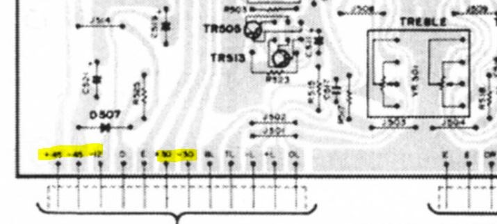

Measure AC voltage at the following test points on power supply board, +/-45, +/-30, -12
with black meter probe connected to chassis. If you get 0mV then test with black probe with
red probe connected to chassis.

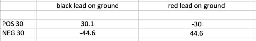

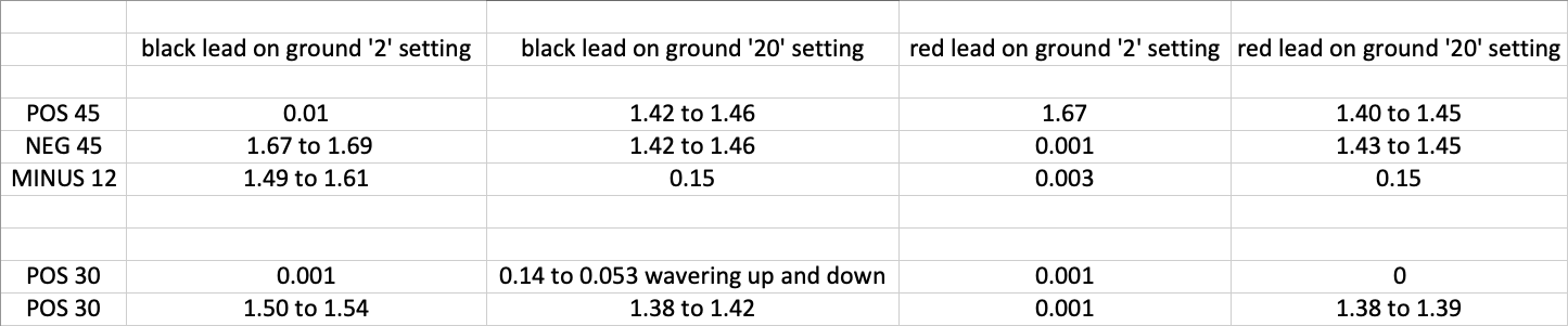

Hi MBZ.
Attached on this screenshot are the readings from my DMM, a Tenma 72-7925.
Different readings occurred dependent upon which AC setting was selected so I’ve provided both sets.
Please let me know what you think.
On the Neg 12 connection I tried the 'continuity/diode test” and there is perfect continuity, is that correct?
Also noticed that the amp’s power lead has a burn mark on it which has been taped over. I need to replace the power lead in any event but could a compromised power lead be a cause of this hum?

The MM method described is very week to say the least, the next step is trying to
interpret the results. My take is that the +/-45 unregulated supply looks ok with
some symmetry in results depending on probe orientation. The minus 12 is also
unregulated, and results in same ballpark as +/-45 so looks ok.

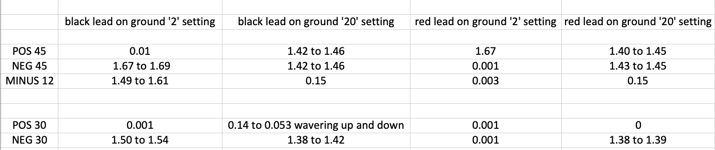

You have listed "POS 30" twice, the second entry looks suspect since magnitudes are
in same ballpark as unregulated, suggest redo the measurement to confirm. Also need
to know if the second entry is for + or - 30.
Measure DC voltage at +/-30 pins. Consider replacing caps C315,6,7,8, C321,3,4 if
they are still original.

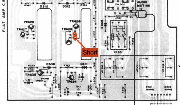

The -30 supply is off spec at 44.6V possibly TR626 has failed short c-e so unregulated power (extra ripple, so hum) is being supplied. Suggest diode test TR626, TR628, try in-circuit since looking for a short.
- Yamaha C4 preamp.
