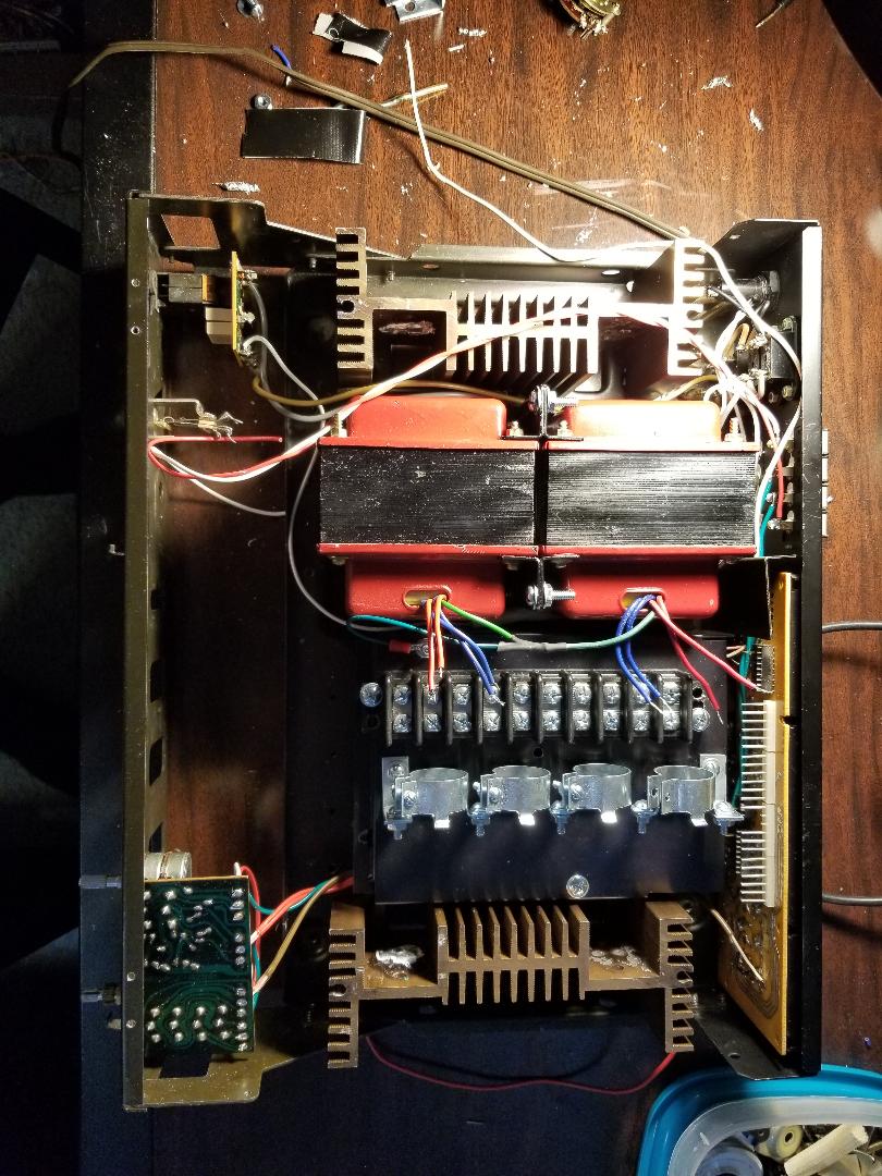

I thought I would make a thread on my CA 800, a little back history first. I got this amp with the intention of fixing and restoring it only to find out the transformer died when the class A/AB switched failed (a common issue when fixing these and as I already have 1000 I wasn't too impressed with the sound I imagine the 800 would be similar. 1000 doesn't come even near my Sansui and they have both been recapped and restored. So I decided to part out the boards to someone who needs them and build an integrated amp using the Gainclone idea. Although my original thought was to go with a class A design like a JLH but I was worried about cooling. I still may go back to that in the future depending on how I like the LM3886's.

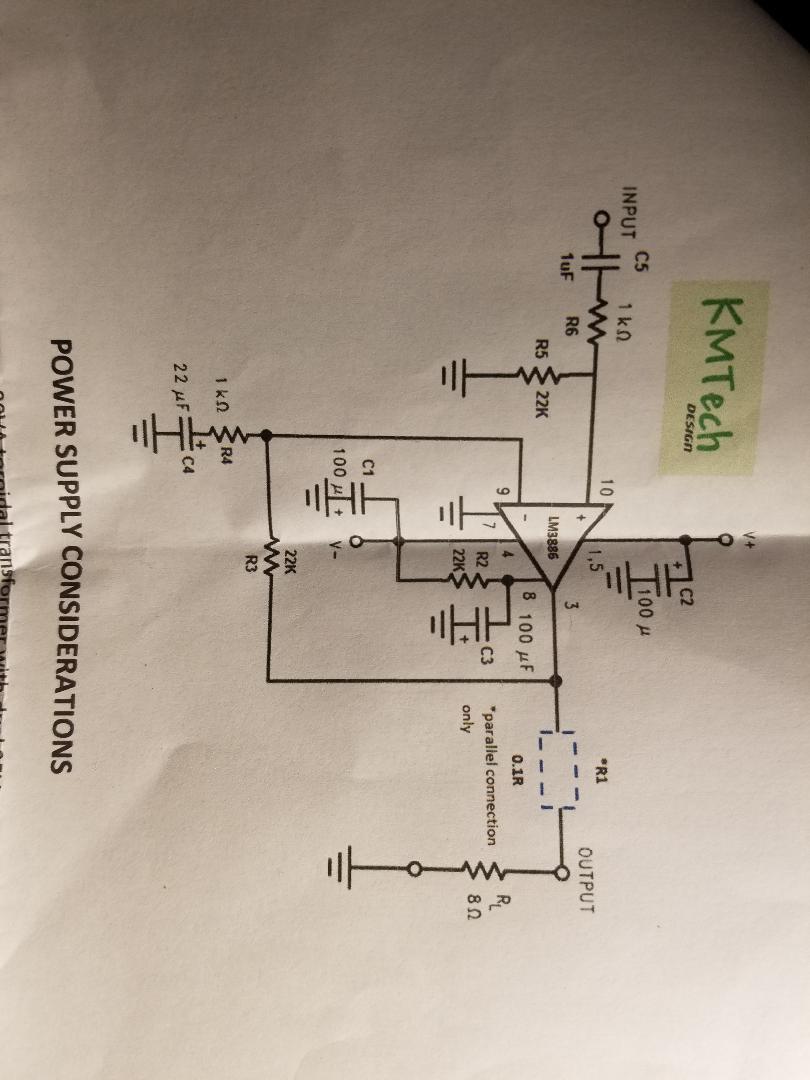

I'm using a single LM3886 per channel with the circuit being the attached schematic below. For the transformers I'm using a pair I have from some Yamaha CA 600's for a dual mono design. I might try to get the existing CA 800 preamp to work with the amp not sure how I will do that yet or I might just go with a passive tone control board and have a switch to bypass making sure input impedance and the 20 DB reduction is matched between passive and bypassed tone controls. Ignore the ugly paint job on the Bell covers, I was gonna use them in another project but opted not to and they'll be painted back to black or if I can to match the heatsinks.

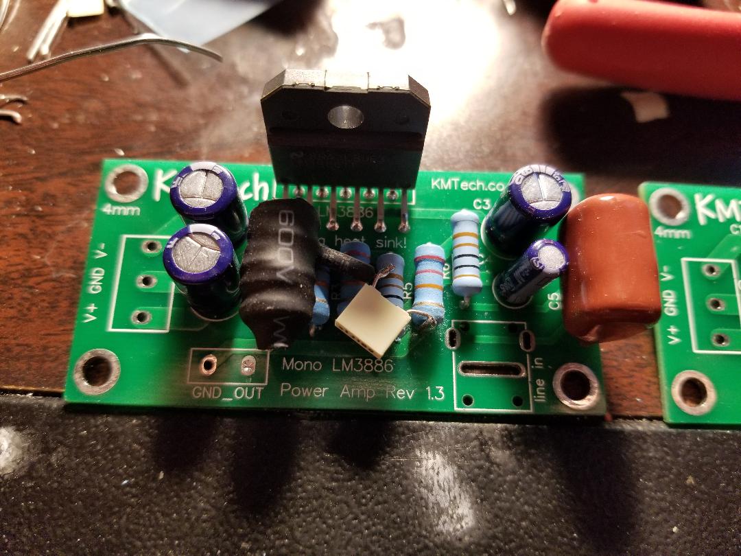

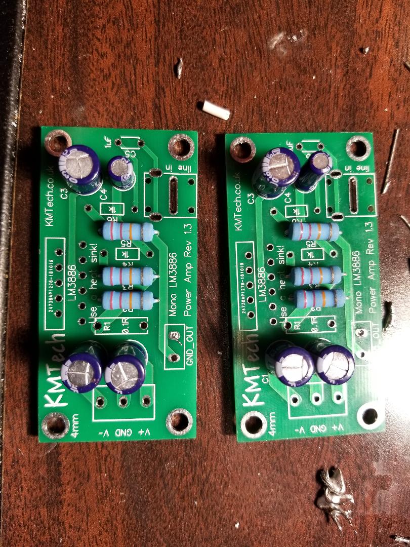

So I opted to go for a board instead of point to point. It's difficult for me to not damage the chip and keep the pins separated. The board is KMTech. It's missing the output stability components I plan on adding those at the speaker selector switch. They also tied in the power ground and signal grounds together so I'm only using a power ground on the board and separately Ill run all signal ground separately to signal ground. I might add some filter for a signal ground but ill know later. Should get parts tomorrow and then I can power up. I should mention that all parts that I've sourced except the PCB boards are digikey or mouser, none of this fake/used bs.

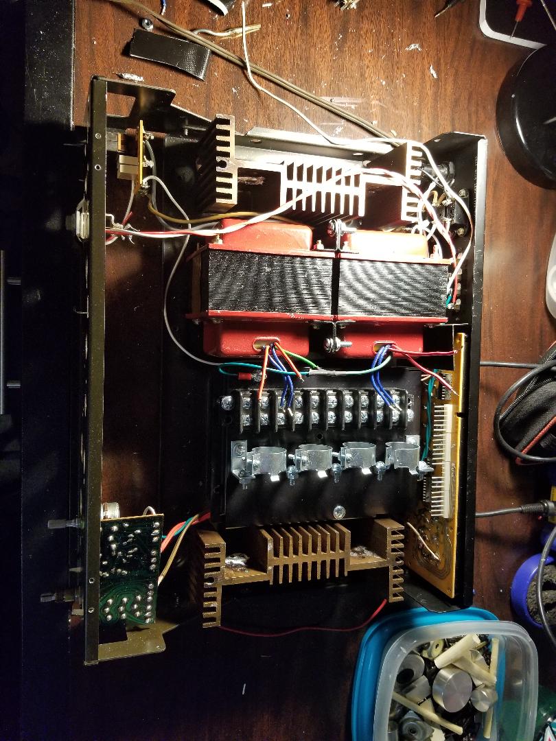

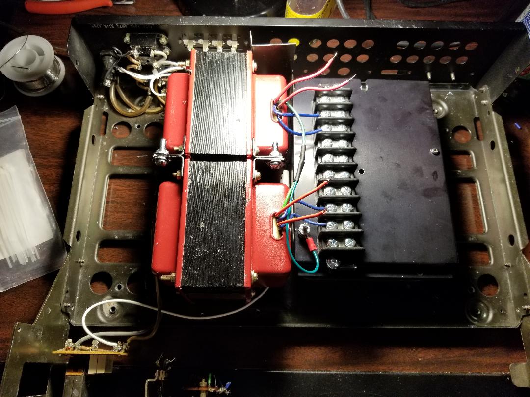

I'm also trying to separate my rails from my signal/preamp boards. All power supplies are up on top as you can see. I have my speaker output close to the mains in wiring which bothers me so I may end up wrapping that wire in aluminum foil with heatshink over it and of course, the foil with have a wire attached to ground. Not sure if that will work but I figure it can't hurt. I also got a bit of AC on the black layers of the transformer not sure if this is whats called eddie current?

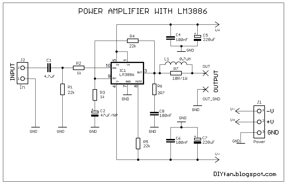

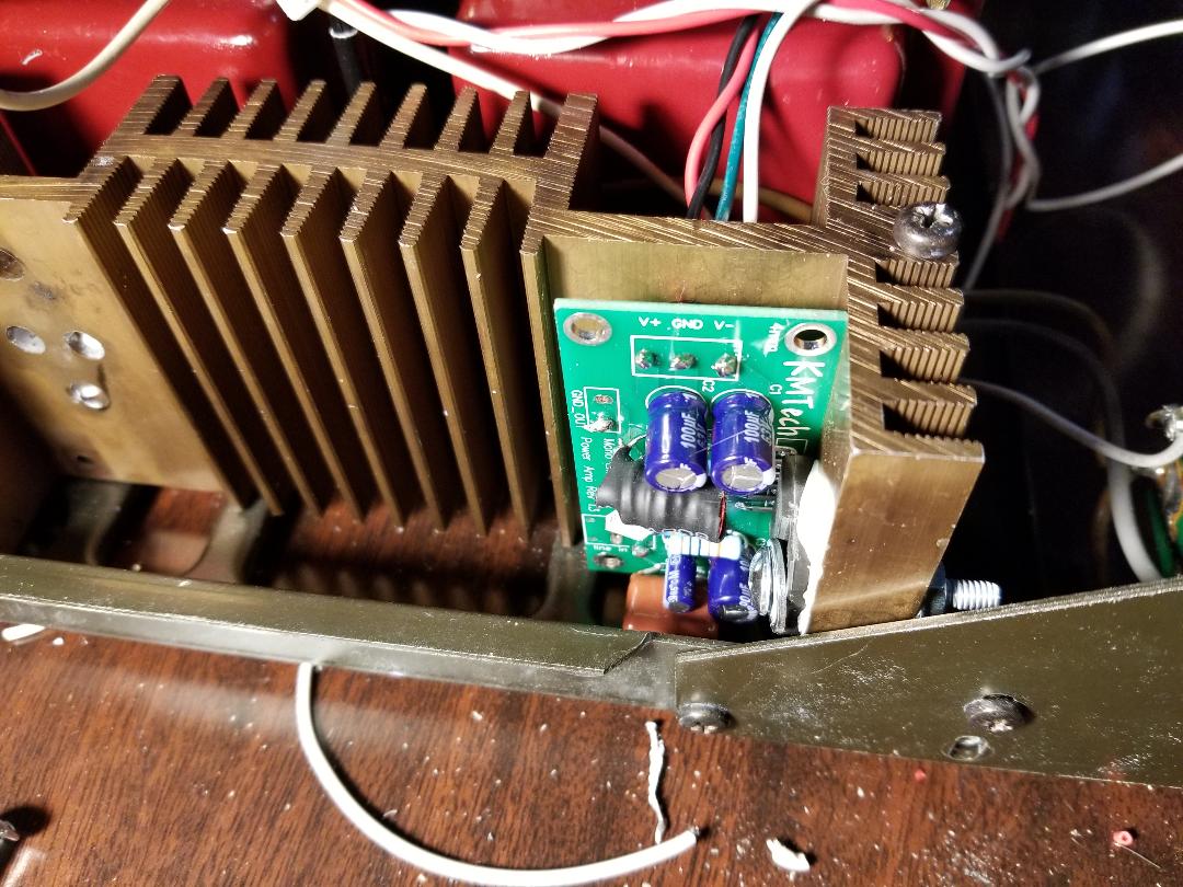

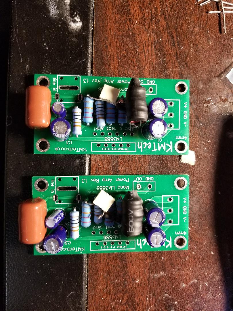

Played the amp for about an hour all seemed well. I got the original tone control to work passively but there was not enough adjustment to make a difference which makes sense looking at the schematic. I mounted the output stabilizing filter on the LM3886 boards. I figure the closer to the chip the better? idk. I also wound my own inductor which I'm not happy with so ill end up remaking it and I only had 1-watt resistors for the 10 ohm and 2.7 ohms. I would like to use at least a 5 watt for the 2.7 my reasoning is it's connected to ground and if that went then it could take out my L100's. Not sure I should rely on Spike to protect it.
Also, my unregulated rails are 40v. I was able to bring it down from 43v by adding diodes after my rectifier and using a 3k 1 watt bleeder resistor. I might try a thermister in there as well.
