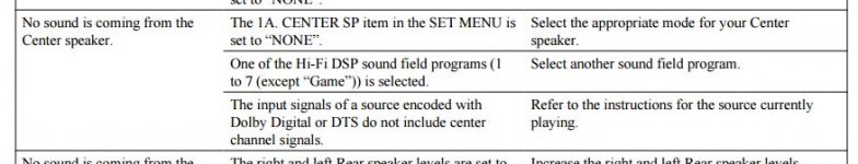

Are you 100% sure the centre mode is not set to Phantom?
I don't know actually. I bought it used, like this. When I search the pdf manual for the word "phantom", nothing comes up? What is that and how do I change that setting on the AX2?
Btw, if there's a Phantom mode set as you say, does it make the center test tone silent to? Because there's no sound from the center in test mode either.
Check the speaker settings in setup to ensure centre is not set as none. Should be small or large. I'm not familiar with this amp, but that's how the HT amps are setup, none/small/large are the options.
Other than that, reset the amp to factory settings.
It was set to large before, I've tried it on small. No difference.

According to the DSP-AX2 user manual, centre channel is not available on HiFi DSPs. Check the centre channel operation on movie DSPs.

I understand about the no center on HiFi DSP, but should I not get a test tone either on the center? There's no test tone when I have the center channel selected. All other channels work fine.
Test tones can be presumed to be digitally generated. Hence those won't work if the center channel out of the DSP section doesn't operate.
Check DC voltage on both output pins of opamp IC527 for a start, and make sure the signal actually makes it from R689 to R590 near IC512 on the Function board (continuity). It could still be a number of things, but possibilities are finite.
