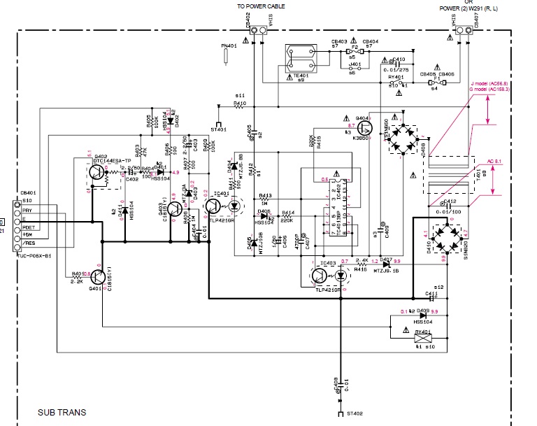

Had a look at the circuit diagram and did some meter readings.
Two test points are labelled on the diagram for the sub trans area T401, I get the 66v input but no 8v output so I'm guessing the stepdown transformer for the stand-by supply has gone down.
Attached a copy of the sub trans area. All help welcome. Even if its just to say im doing something wrong or in the wrong area 🙂

That 66v on the primaries ...Where is it coming from? are you sure it is suppose to be 66v and not 110v?
Sorry on the primaries of the standby transformer im getting 56v just re measured it and on the secondries 0v. Would I be better taking an actual picture of the circuit board and highlight where I am metering?

It looks like the small transformer isn't run straight from the line, but via some sort of pulse width modulation like an SMPS on its primary. Seems total over kill to me where a regular line-powered transformer would have worked!
Hm, having carefully read, it seems you should only have 56V on the primary in Japan, where the voltage is 100V. There should be 158V there in Europe on 220-240V. My guess is that the circuit around IC402 is trying to detect line voltage/frequency and getting it wrong. Too low a primary voltage means too low secondary voltage = nothing works.
Look at page 75 for a diagram of the sub transformer PCB, page 81 top right for the schematic. You'll see a parts matrix below it. Check the parts on that list in the "G" column. My gut says check C405, R412 and C406.
C405 should be a 22n X2-rated capacitor, such as this

You're welcome. You didn't mention the fuse, but I assume it's OK.
I've been trying to get my head around the PSU of this amp, but it gave me a headache. On the plus side is that the schematic has links (the yellow boxes) so you needn't scroll until you're blue in the face...
The way I see it is that the subtrans powers the microprocessor (uP) via S10 to IC501 to +5M/+5S/+5BU and is checked by the very same uP (PDET might mean Power DETect). At power down PDET becomes low quickly (before the main PSU caps have drained) and the uP will probably switch off the speaker relay te prevent strange noises and thumps.
C402 probably creates a slight delay after power on before the uP gets reset (/RES).
If subtrans power is up, than the uP activates PRY (which I assume means Power RelaY) and that switches on RY401 to connect the main transformer to the mains.
I agree with jaycee that the subtrans is the place to start measuring. It is on page 86 (not 81) top right. If it doesn't work, the rest of the amp can't work either.

Sorry, but because of my job in electronics, I don't agree with replacing parts on a hunch. Measure first.
My job is electronics too.
I repair Hi-Fi's for a living. I repair lots of Yamaha Amplifiers, Sound Bars etc etc.
C 405's value changes and does not pass as much AC through it to IC 402 as it should preventing the Standby Circuit from operating correctly.

It's the function of X- and Y-rated caps to prevent damage to equipment and injury to persons (link).
For obvious reasons these should never go short circuit in case of damage. That leaves decreased capacitance as a failure mode. Those spikes may well have caused damage to the caps, esp. if the malfunction occurred shortly after. Replace only with the same type!

Fixed
A big thank you to everyone who helped with my issue.
On Sunday I replaced C405 with a new one purchased from Maplin (N38CN / 89p)and unit fired up perfectly. The original cap look fine and had no obvious signs of damage, but when tested, was only reading 6.6nF and not the stated 22nF.
The new capacitor is rated for 1250V, a lot higher than the 630V specified.
Do you guys recommend that I change it again for one of the correct rating, like the one linked to by Jaycee in an earlier post?
