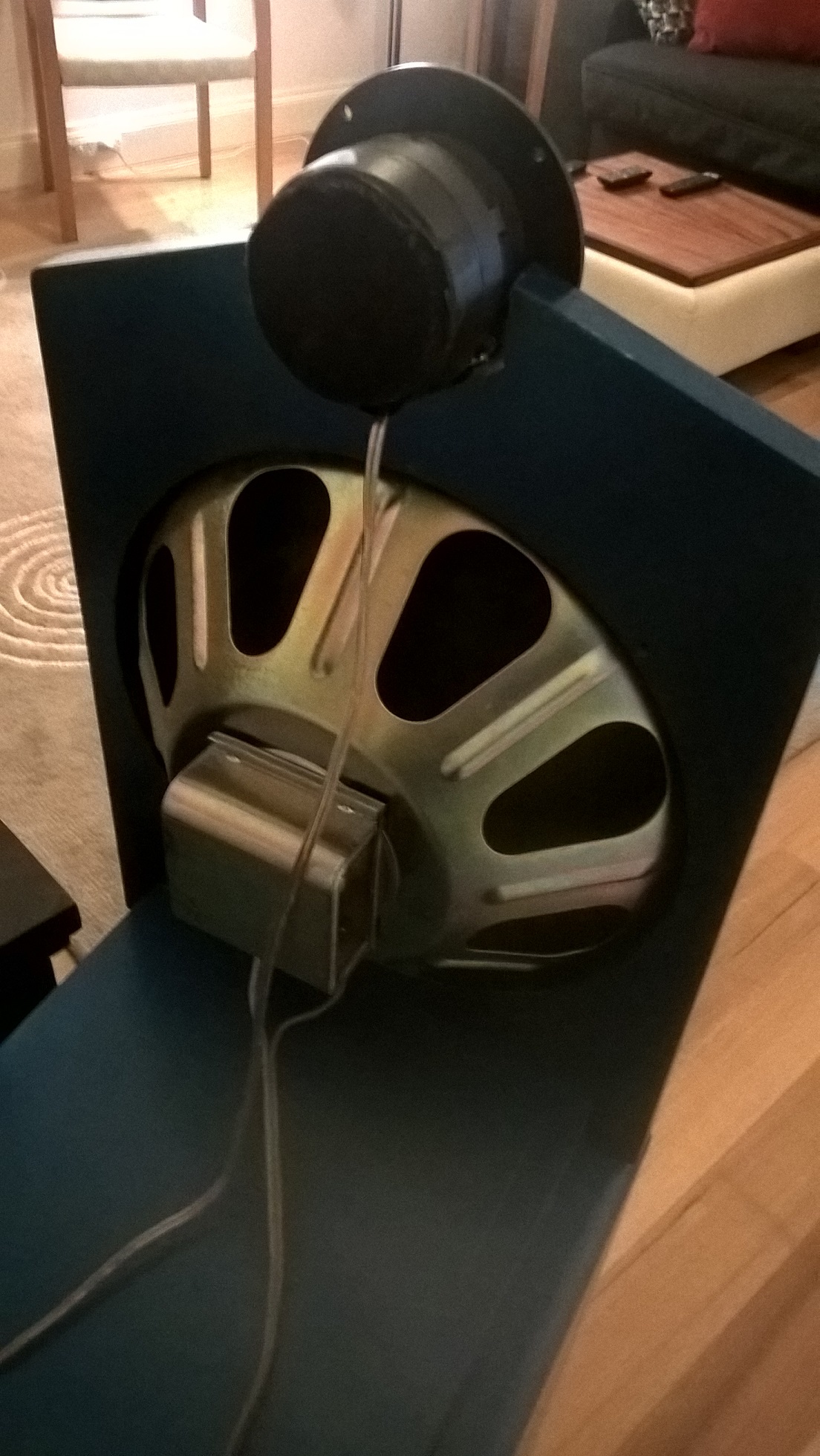

There are plenty of old organs around that are no longer wanted and offered for free.
Most of them contain at least one high SPL wide range speaker, some organs have two and more. Quite a few of these drivers are with Alnico magnets.
I am not familiar with the American brands, but can highly recommend Yamaha and Kawai, excellent paper cone drivers, mostly 12 inch, some 15 here and there.
Can go in OB designs or sealed aperiodic because of their high Qts.
One can build a single driver system or 2 way, even 3 way with these.
And they are proper instrument speakers.
One example below.
