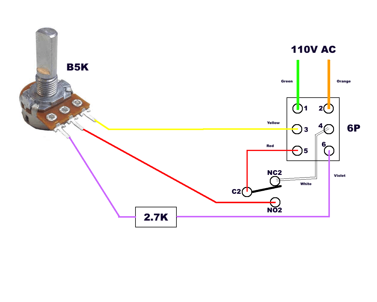

Hi, I recently obtained a Yamaha JA1701A Rotary Speaker assembly that I was told was removed from an organ or rotary speaker cabinet (Possibly a Yamaha RA-50). I repaired the circuit board and it runs on 110V AC supply. I have the two speeds working fine. By joining the red wire and white wire for slow speed and fast speed can be selected by linking the red wire to the yellow wire. Speaker is working fine.
Would anyone know how I could regulate the speed in the fast setting (red and yellow wire joined together) without damaging anything? It would just be a little more versatile even though I like the two speeds.

The motor appears to be of the synchronous or asynchronous shadow pole type. So you'd need to vary the frequency.

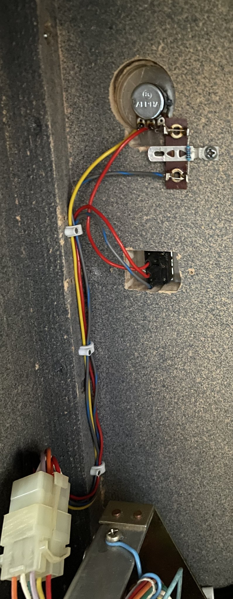

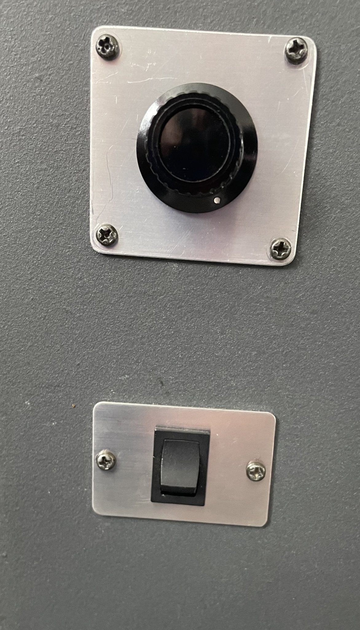

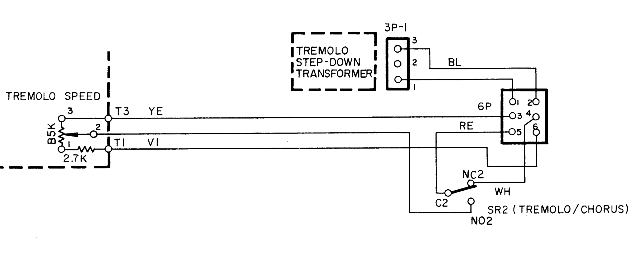

I carried out the speed control modification to my Yamaha JA1701A rotary speaker utilising the details from the RA-50 service manual. I fitted the 5K linear potentiometer and 2.7K resistor into the fast speed wiring exactly as shown in the manual. It works perfectly. So can now switch between a fixed slow speed and a variable fast speed. Thanks to all for their advice and info. Appreciated.
I'm quite astonished as the schematics at the SM's page 4 shows that the motor speed is controlled by the motor current, not by the frequency. As it's an asynchronous motor with a phase shift helper winding, I dunno how that works 🙄.
Anyway, congrats to your successful modification!

Rockies914, I am happy to send you the details of the mod I carried out, if it will help you.
Thanks! 🙂 I have a RA100 service manual that shows a 5k potentiometer, in line with a 2.7k resistor. Is it that easy?

If you happen to have the RA50 service manual in digital format, my version of the RA100 isn't the greatest 🙂
Thanks very much! Much better than what I had. It looks like the voltage is less than 6v so that makes things easier. I'll put a digipot on my next parts order and see if I can whip something up 🙂 It will be awhile but I'll post back with the results for certain.
