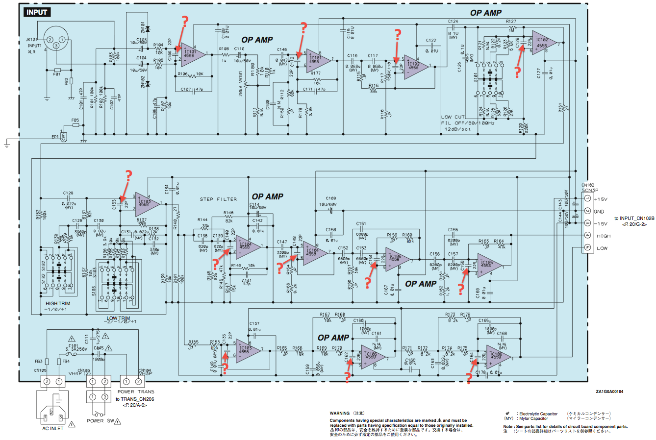

So I've got some Yamaha MSP7 active monitors and they have been all around great speakers for home studio use in a semi DIY "treated" room.
I have to admit however that I'm a little curious about how upgrades may bring them further into their element.
That is, I'm thinking about swapping out the ghastly 4558's for newer op amps with better noise, distortion and DC specs.
In the attached schematic you'll see that every 4558 has a 22pF cap across its inputs.
My question is - what is the purpose of this cap?
I read up on Lead-Lag Compensation and in my foggy lay understanding I think the 22pF serves to limit high frequency response - for stability's sake as well as to protect against RF interference?
I'm wondering, with the 4558's already relatively low bandwidth (3Mhz) and the copious filtering going on around them in the feedback loops (see schematic attached), how necessary is this 22pF cap?
Without removing it, would it render changing the op amps pointless?

I'd guess someone did some copy & paste there. These caps are typically found in phono stages (with values in the hundreds of pF) so should aid EMI rejection in low-level stages (like IC101), but they are definitely not necessary everywhere. You can see them as a high-frequency bootstrap or GBW drain. If you feel like it, you could try removing one at a time and checking cellphone sensitivity.
In terms of opamps, yes, those 4558s are a little long in the tooth. They should nonetheless do an OK job as a "one size fits all" type here. IC101 could use something with a little lower noise, while the filter stages appreciate something with low input impedance distortion and moderate current noise. LM4562s should actually work quite well everywhere. With the better output drive capabilities of the modern type, you could also cut R177/178 values by about a factor of 2 for even lower noise, though you should determine where the volume pot is typically set at in order not to throw off impedance balance (inverting vs. noninverting) too much.

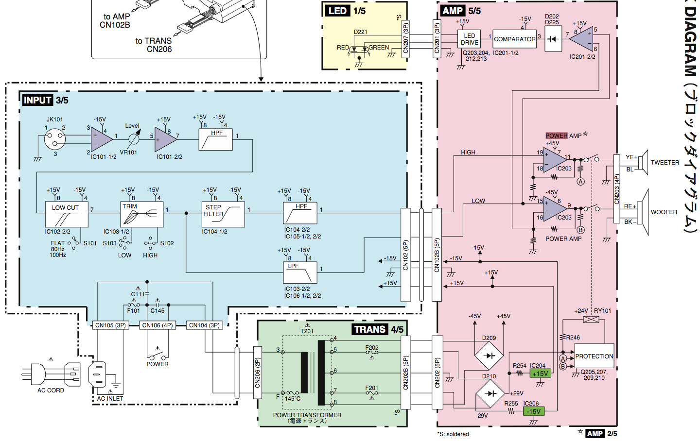

Another thing I think is cheesy about this design is that apparently even if the filters are set to "flat", the signal has no choice but to pass through the multiple op amp stages (block diagram attached).
I never use the filters anyway.
Yes - with faster opamps it may even lead to oscillation.

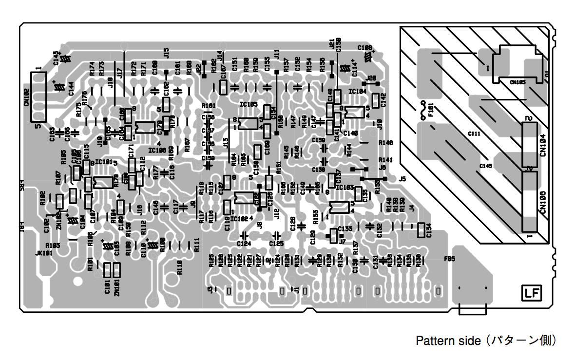

Also rather pointless improving the opamps without changing the grounding. The decoupling caps as shown pump noise into signal ground from the rails. Noise is created on power rails by opamps' classB output stage.
You mean from the supply current transients feeding the push-pull stages - under the influence of power rail inductance?
Couldn't cleaner supplies with lower output impedance be of some benefit here?
Yes and yes. Not just power rail inductance, resistance too. Most of the time I look at commercial opamp-based circuits, the supply rail impedance I see isn't particularly low. Decoupling caps are generally hugely undersized for high quality audio reproduction.
So then it makes me wonder if adding parallel/beefier wiring for the supply rails is in order.
As you can see in the attached pic there are some jumpers distributing the rails around the board.
It might well help - but first check the output impedance of the regulators on the other board. At lowish currents, that might dominate over the wiring impedance. Local regulation tends to be best - I normally prefer using shunts (TL431 is very cheap).

I think I know why they may have put the cap across the inputs.
These are filter stages and buffers.
Some opamps are unity gain stable, but can show problems when the gain is <<1. The 22 pF raises the noise gain at HF, providing a bit more gain margin.

Correct - as a general statement
However, with opamps that are marginally stable for gains at 1 or less, some small capacitance across the inputs, or from the inverting input to ground raises the noise gain and stabilizes the loop.

Having a gain <<1 would seem to only apply in the inverting case. Is this what you're referring to - the inverting filter stages?
Do you know of any online literature about this (or in print)? I need to read more about it.
You can reduce the noise gain of non inverting stages and buffers too, and in just the same way as long as there is a resistance added between the opamp output and the inverting input.
