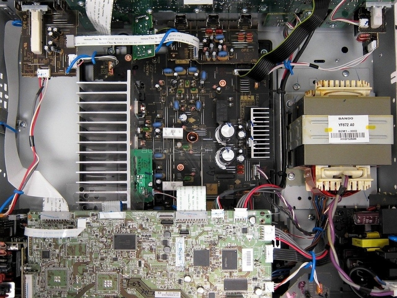

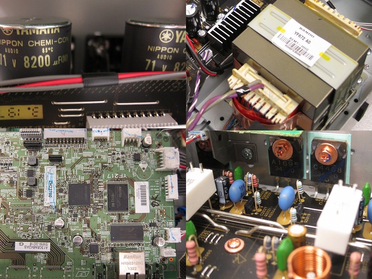

Internet pics.
I count ~10 pcb's.

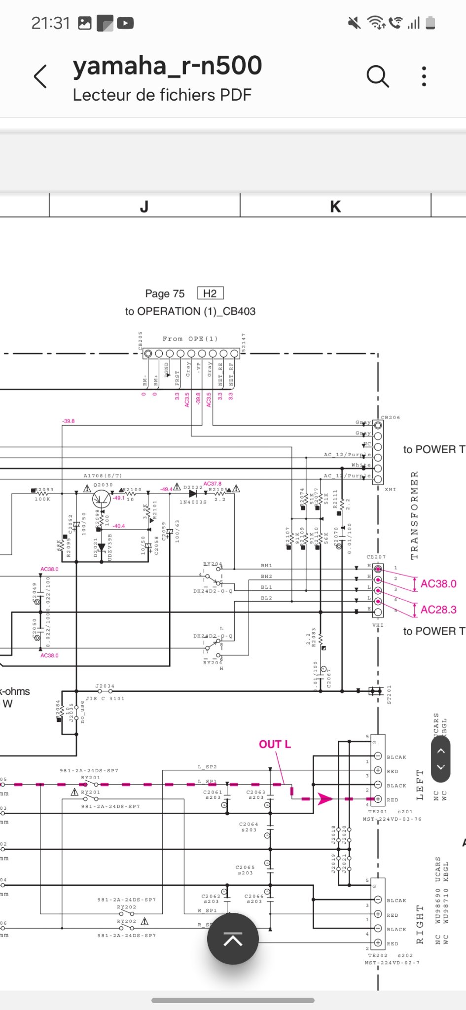

Good morning,
I continued my measurements and moved forward. the microprocessor cuts the power supply to the transformer via the protection relay which explains why there is no display because -VP is suddenly absent.
After reading the schematic, I do not understand how he work. For me the transformer winding that produces the 38V is not connected because the RY204 relay does not connect BH2.
