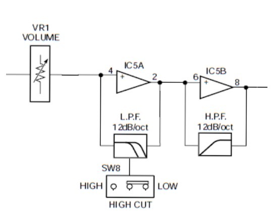

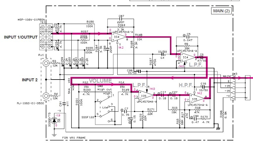

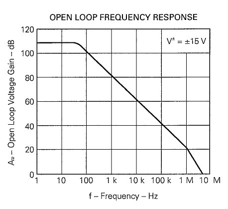

I itz_all_about_the_music Member Joined 2022 2024-02-07 7:19 pm #1 2024-02-07 7:19 pm #1 Seek advice (design details, required parts, pros, cons, risks...) on replacing the OEM switchable low pass feature to a variable crossover pot/circuit. I'm attaching three pics: OEM filter characteristics, block diagram, schematic. I itz_all_about_the_music Member Joined 2022 2024-02-21 1:43 pm #2 2024-02-21 1:43 pm #2 UPC4570HA open-loop response shown below. You must log in or register to reply here.
