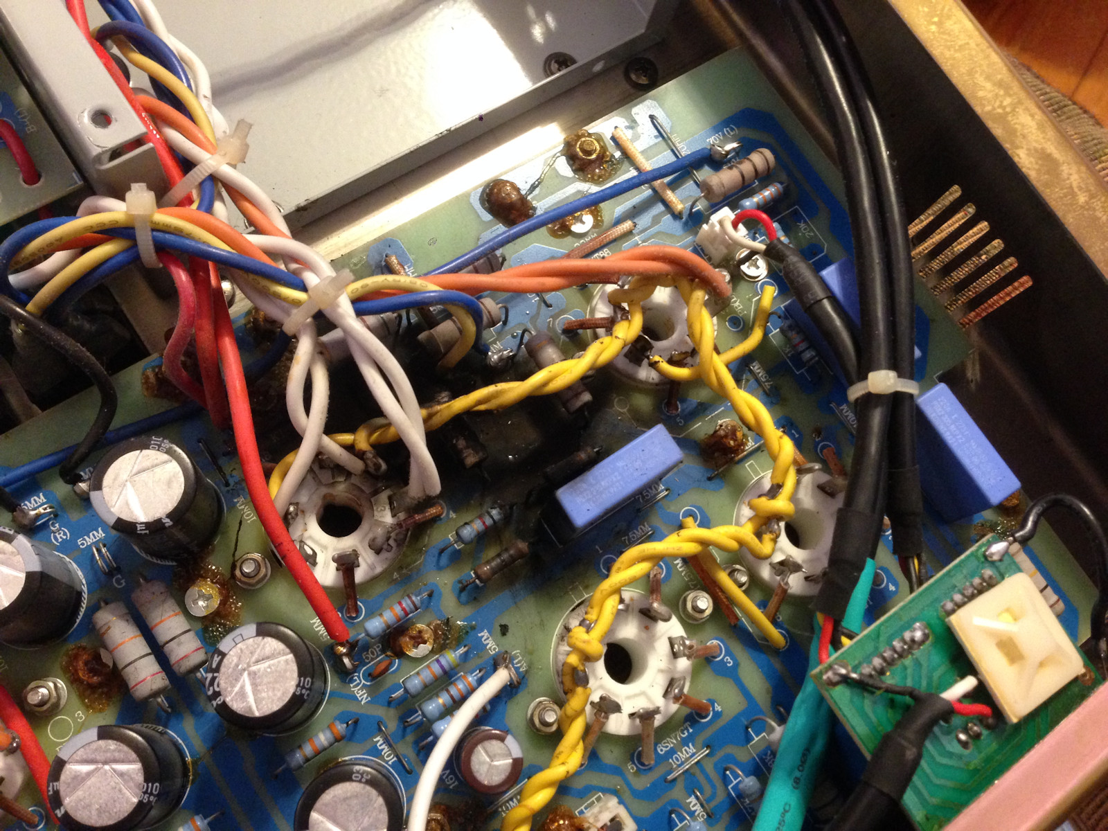

Bad tube (I think) took out my MC-100B. 180 ohm 3W resistor fried
After 10 years of flawless operation, and even a couple years of driving a set of Tung Sol KT-120s, my Yaqin MC-100B has let out some magic smoke. I turned the amp on, hit play on my R2R, and walked into the kitchen to make some eggs. Music started playing, I got a few items out of the fridge, and then I heard loud static from the living room, for just about 2 seconds. The only other time I've ever heard something like this is when, a few years ago, a well-used JJ tube made quite a nice little light show while I was listening to the amp. I shut it down immediately then and no damage was done.
But this time, before I could get back to the living room the noise was over. The music slowly died away, as if the power was switched off. I touched the tubes, and V1, V3, and V4 were warm to the touch. V2 was stone cold. Not a good sign.

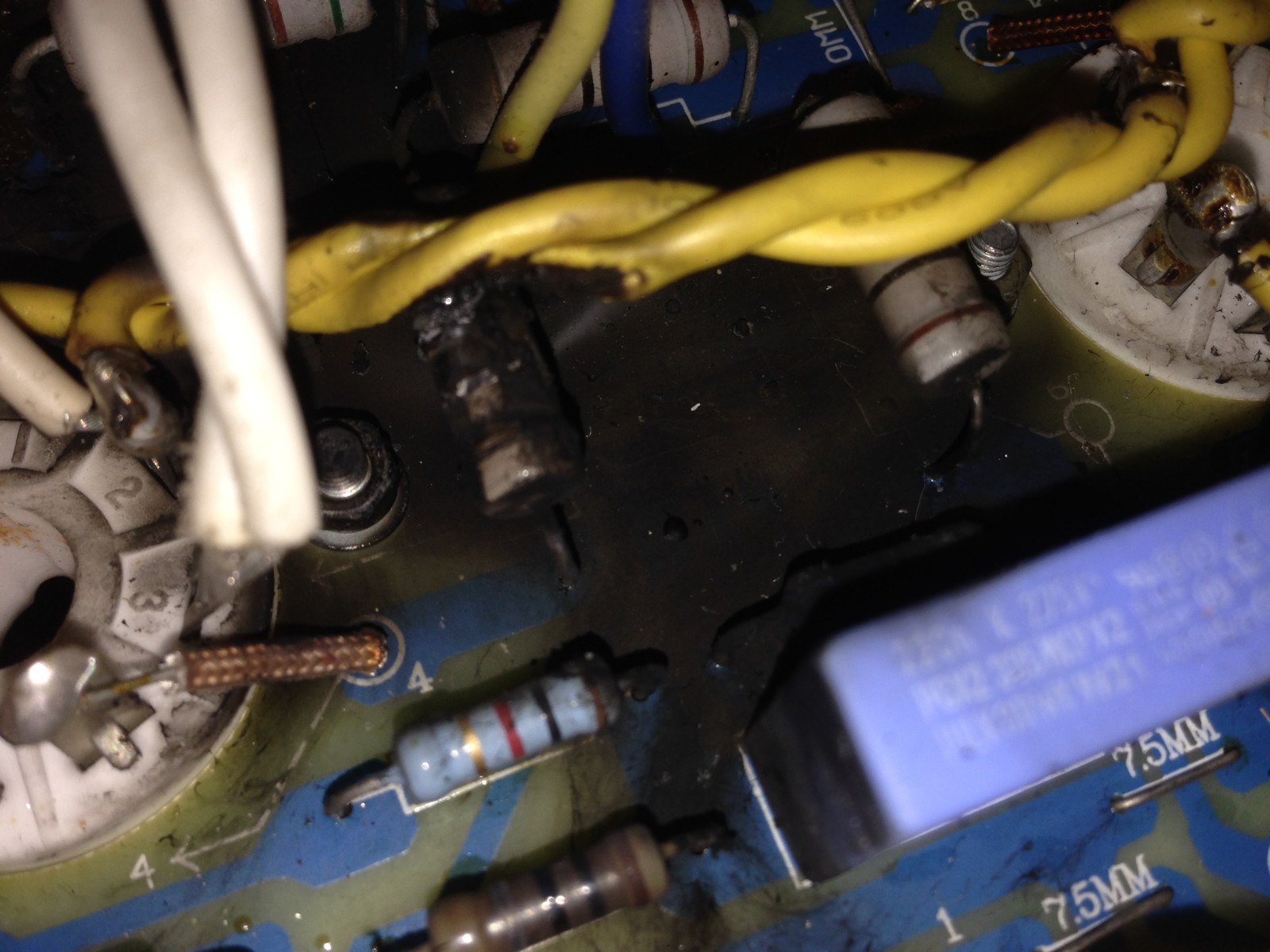

So I unplugged it, removed it from the rack, pulled out all the tubes, flipped it over, and removed the bottom. There's a nice char mark under one of the 180 ohm 3W resistors on the right side of the V2 socket (Well, right side if the unit is upside down and the volume controls/front inputs are near your body)
Pic:
Here's a close-up of the offending resistor:
So, two questions. 1) What likely happened here? 2) If I replace that 180 ohm resistor, pop in a new main fuse, and replace the KT88 that was in V2, will that likely fix it? I don't see any other parts burned on the board, but are there any others that could be damaged by that resistor burning?

The heater wiring above the burned resistor looks a little charred and would benefit from being replaced.

Also have a very close look at this 10 ohms (supposedly) resistor lefthand next to the blue .22µ capacitor. This might be the cathode resistor and also has seen excessive current. So my guess is the related KT88 tube might have become gassy, or it's coupling capacitor might be leaky, or the bias arrangement might be faulty...

The wires for pin 3 and 4 are not touching. That's a 100k ohm resistor, and it appears to be fried too. Is that 1/2 watt or 1 watt, do you think? I did have a couple of gassy tubes in this batch (I bought a large batch of Teslovak KT88 tubes and weeded out the gassy/bad ones. Apparently I missed one!).

by it's rings' colours I would have bet on it's value of 10 ohms. If it indeed has been a 100k one (brown-black-yellow), then it most probably is an anode resistor, and there might be also an issue with the PI or last amplifier stage before the finals.

Also, the deeply discolored 100k resistor is brown, black, yellow, gold on the other channel. It's marked 100K on the PC board right beneath the resistor.

Replaced all of the 3W 10 ohm and 3W 180 ohm resistors, repaired/replaced the burned wiring, upgraded the four .22uf caps in the signal path to .47uf caps, replaced the burned out blue LED with a red LED, and plugged a new tube in. Powered right up, and I adjusted the bias voltage to .55v for each tube. Hooked up some test speakers and she sung! Completely fixed, I'm really happy! BUT, I'm going to take it back apart and do a little re-wiring. I want the front panel input to bypass the volume control. Looks like a really simple change 🙂
