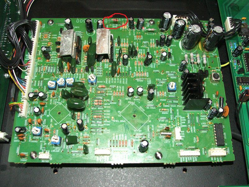

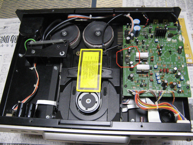

I'm trying to fix my yba cd2 delta player.
The player works perfectly for 20-30 minutes and during that time track poor cd without any trouble.
After that time, it start having troubles reading and at some point wont even initialize a new cd.
The problem seems related to the spinning motor where it try to turn but won't reach proper speed. If I give it some help it will initialize but after some time it will start skipping when slowing down.
I've found a visual problem on the main board which seem a generic board for the sanyo sf-p1. The diode d116 (circled in the picture) is over heating and damaged the board and traces connecting to it. You can see that the diode is lifted from the board to prevent that but it's still hot enough to conduct heat to the pcb and slowly destroy it.
I would relocate the diode to a bigger one using the casing as a heat sink but I need to find the reason that this happened. The player had been repair for the same trouble couple years ago and from what I can see they only replaced that diode.
The main board is the same you will find on many players of this era, classe cdp .3, roksan caspian, cec cd2100 cd3100, krell kav-250 ... I've found some pictures of these cd players over the web that show discoloration around that diode so I don't think it's a problem only related to the implementation in the yba cd player.
I've searched for a schematic for any of these players and only found a service manual for the classe cdp .3 and it doesnt cover the main board at all.
If anyone had experience with this problem or have a schematic it would be of great help.

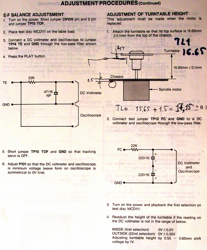

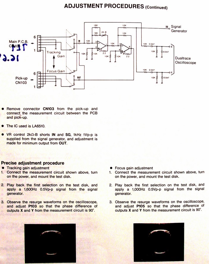

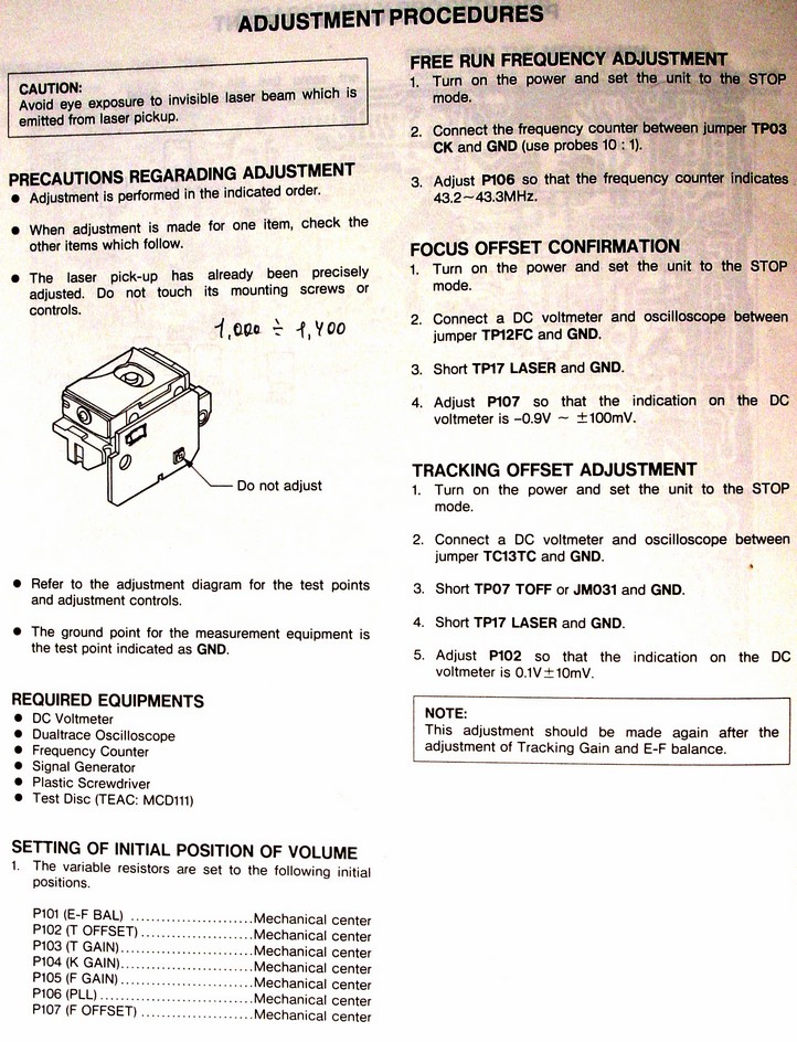

The absolute first thing you have to do when you have reading problems with an Alpha or Delta series YBA CD player is clean the laser. When I say clean I mean using a Q-Tip soaked with glass cleaner. You would not believe how many times a dirty laser lens is what is the cause of the problem. I sometimes get an RF signal that is up to half a Volt higher after cleaning!!
As Mooly pointed out, there is no way to do a proper adjustment without an oscilloscope. You should have between 1.5V to 2V RF at TP16. Sometimes I have to crank that close to 2.5V as many customers want to read CD-R and CD-RW discs and the original setting was a little too low for that. I rarely have to replace laser pick-ups as they are extremely reliable.
As for real defects, the first thing to go bad on the Delta series of YBA CD players is the spindle motor. The second one is the YM7121B or C as the players are extremely sensitive to electrostatic discharges. The third one is the zener diode, D116, regulating the display "high voltage". The fourth one is the tray motor. I am beginning to see tray belts going loose since about a year now.
The easiest way to test the spindle motor is to connect an analog multimeter on the x1 Ohm scale to DM+ and DM- of CN102 and turn the platter very slowly to see if there are shorted spots. The needle should be steady around 15 Ohms.
The same goes for the tray motor on SM+ and SM- of CN102. A good indication that this motor is defective, IC104 gets burning hot.
Another problem I see from time to time is a jerking tray motor while reading the CD. It is more pronounced when using a CD that is not perfectly centered. When I first began to see this problem I thought it was because of off centered disc platters but after awhile I had to dismiss that conclusion as I saw more and more older players having this problem. Since I was not supplied with a schematic by YBA I had to "develop" a fix for that behavior problem. After a lot of experimentation I found that increasing the value of R164 from 2.2k to 15k I was able to eliminate the jerking. This can be done without removing the PCB by soldering the new resistor to the left side of R164 and right side of R166 and not forgetting to cut the right side of R164 AFTER the soldering is done. This new resistor value is not absolute and may differ from one machine to another. The best way is to install a resistor with full length leads in case you need to change that value.
Getting back to D116. The original value of R170 that is in series with D116 was 470 Ohms on the first PCBs I saw and became 2k2 on later PCBs. They used the same circuit on the Alpha series of YBA CD players and the same diode burning problem happened then..., after they replaced the transformer originally coming with the PCB by a "better one". The voltage output of the new transformer was higher so D116 had to dissipate more than it originally did. Stupidity being what it is, it looks like almost everybody using that PCB made the same mistake. Go figure... The really bad thing is that I can not find replacement displays anymore and this is that part that suffers/dies when D116 looses contact from the PCB traces as full voltage is applied to the display.
I am at your disposal if you need more information or even parts if you can not find them and would be extremely grateful if someone had the schematic and could send me a copy.

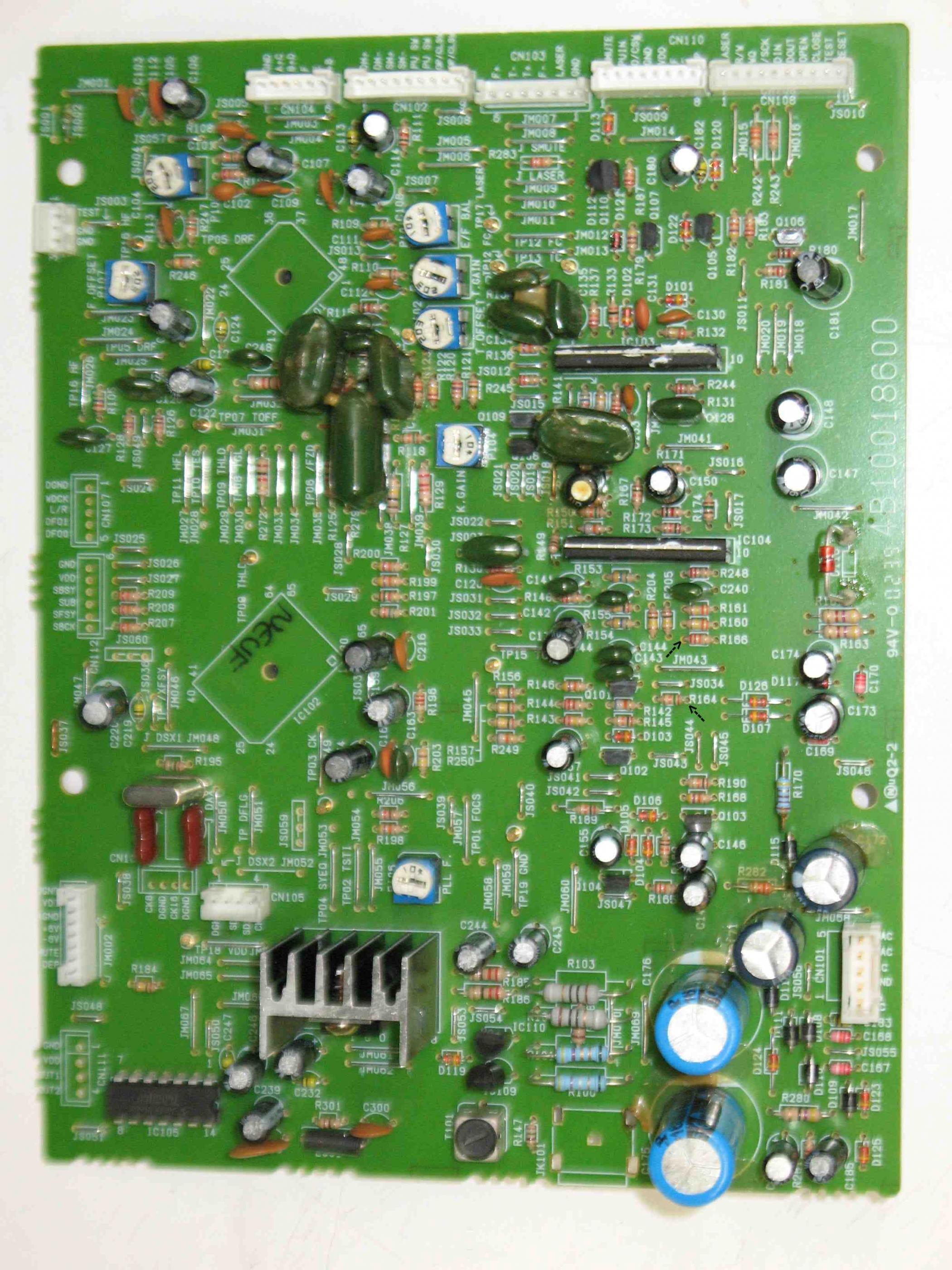

Thank you for the informations about this models, where this Sanyo PCB is in use.I'm trying to fix my yba cd2 delta player.

I received a question as to where exactly the "new" R164 goes.
I just uploaded an image of the board with arrows pointing where this resistor should be soldered.
Another question was, Is this mod will work on my Classé CDP.3?
I see no reason why it should not work on any player that uses this board.

I made a mistake in post #4, R170 became 220 Ohms, not 2k2.

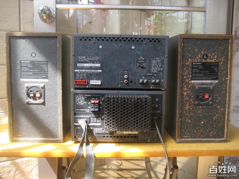

unfortunately there are no internal images of Sharp's CD-S600X, but I think, there is the board from this discussion used.
Try to get in used condition this hifi system from Sharp (for comparable measurements by troubleshooting).

tiefbassuebertr,
I downloaded both manuals from the links in your post #11.
The Sharp CD S600X may use some components as the YBA Delta series board we are looking for but it definitely is not the same.
The CEC 780CD/880CD is the same as the YBA Alpha series so it can be used for the CD 1, 2 and 3 of that series.
You write about increasing laser emission power to get CDR and RW read?
Thanks for R164 info, works well but I think that issue is because ~1V DC on sleed motor. After R164 change is still there but motor react much slower and we can't hear jerking.

- Yba cd2 delta, classe cdp .3, roksan caspian ... main board
