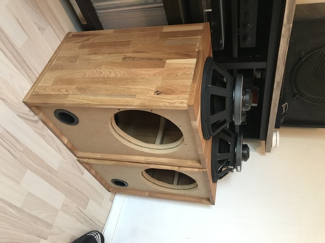

Some pics on the driver and the ongoing build attached.
To be continued.

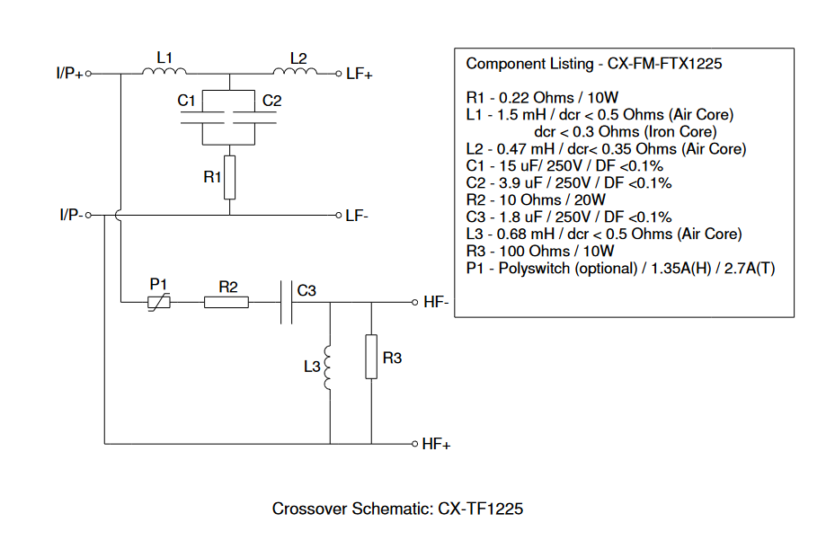

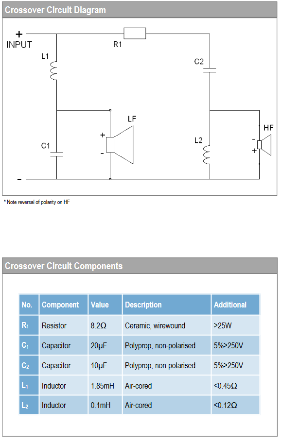

1. Crossovers and simulation prior to measurements.
Celestion have a few alternative crossover designs which may fit my box but they look very different. One is 3rd order and seems to deal with resonance peaks while the other is 2nd order it probably require external eq. I have yet to find any measurements of these drivers and I have little experience with simulation anyway but looking at the datasheet I really wonder which would fit best. As most coaxes both the low end and high end have nasty peaks at 2kHz to deal with. Looking for some advice here. See attached options
Sources:
https://celestion.com/wp-content/uploads/2018/01/FTX1225_system.pdf
https://celestion.com/wp-content/uploads/2019/09/FTX1225-crossover-design.pdf
https://celestion.com/productpdf.php?id=992
2. Working with oak
A) Ive never worked with oak before but it seems extremely dry and crisp. So I decided to assemble the box using glue only, no screws to try to avoid cracks. Ive read that some people use stain on oak both inside the box and outside to prevent it from cracking. Is this a good idea? Should I screw the internal bracing after all?
B) I have a few gaping joints, I'm think about filling them with glue but are there other ideas? They are not the worst (will share pics soon), but Im afraid that over time it will be visible also after staining.
C) Finally stain: what are some good material that both look good, protects it from cracks and scratches and are there any step-by-step guide recommended by the pros here? If course I need to sand a alot before I get to this point.

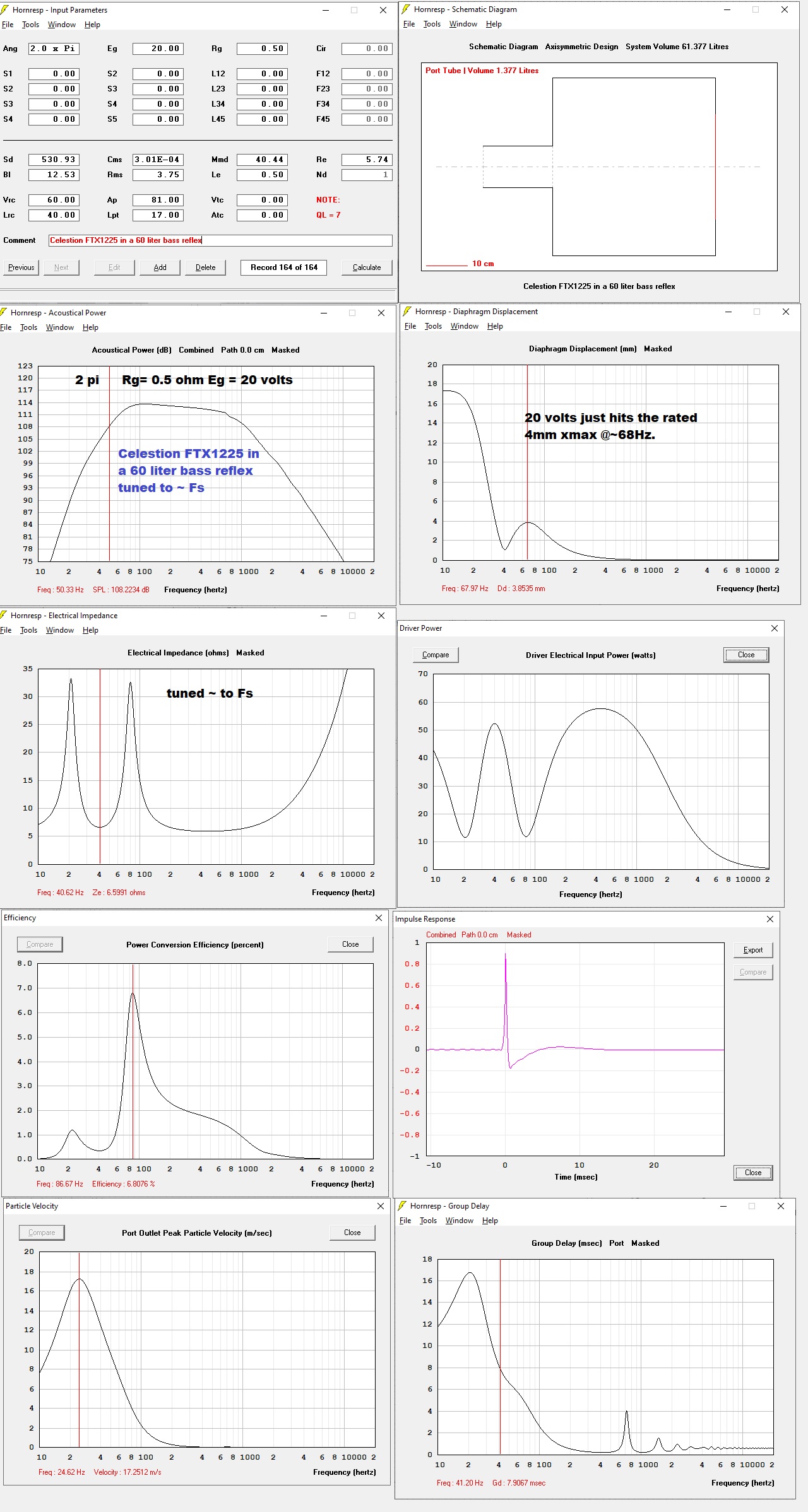

3. Pass port tuning
I think Ive decided to go away from sealed but have little experience in simulating box. What would be a decent tuning for a 60l box and this driver? It it possible to have 40-50Hz without loosing punch?

I've tried for 10 minutes to reply - goofed with a PNG - have to wait as system says can't repeat as a duplicate.
Also note the Vas typo where the decimal point was shifted.
It looks good for 20v tuned to free air resonance and just hits 4mm Xmax at 20 volts input around 68Hz
Thanks that doesn’t look to bad. 40hz achievable, I was a bit sceptical at 4mm being the xmax but at 68hz I assume it’s not a big problem then. I can use double ports will that somehow “help”? Is there a way to design for a smoother roll off from say 50hz and achieve higher SPL around 60 but less at 40?
you could tune lower but that will mainly make the driver work harder in the 40-50Hz region. Doubling ports for a 4 inch ID port will just about double the length so would be about 13.5 inches or so in length to tune to Fs .
I'm not sure why you want to simulate your crossover before you build in this case. It seems reasonable to do it after measuring.

Regarding the crossover alternatives yes I will definitely wait until I can measure I was just curious to understand the difference of the two, maybe electrically first and how they both deal with the 2kHz. I would assume the most complex of the two would have quite a dip in that area but I’m aiming for a less complex setup. I might also consider DSP but I want to try and see how I can do with passive.

About your crossover choices, sure have a look at them now if you want to learn about them. When you measure you can just put the new responses in.

My passive and DSP crossovers end up doing the same thing. Whichever you can work with to get the right result.

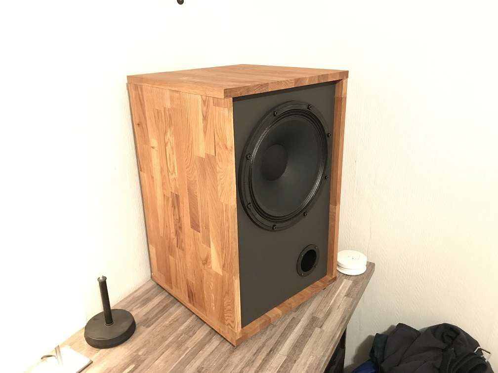

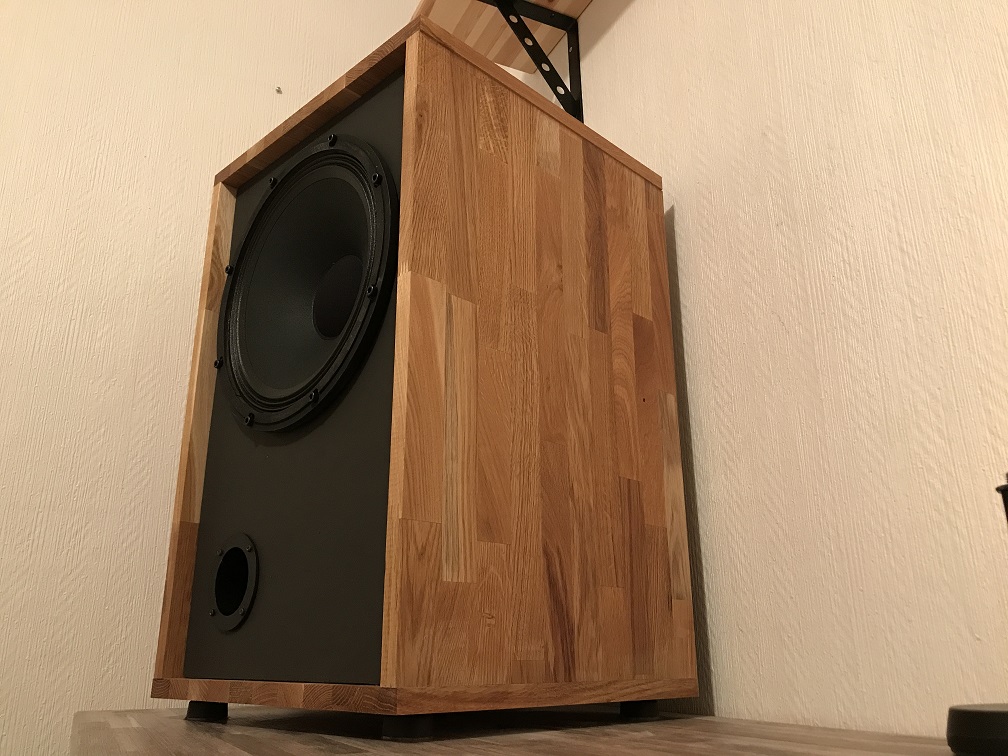

Not yet but I’m close to connecting. Had to do quite a bit of sanding to make the baffle hole fit properly to the driver as I dont use routers, further had to sand the edges of the removable baffle to make it loose enough to fit into the frame. Manual work takes time. Right now the removable front is drying from some paint. I also had to find a local dealer to support in M6x60mm bolts as 50mm wouldn’t cut it on this think caste frame. I’ll soon screw it together and connect but still with open rear and no damping so its not going to be realistic testing, just to begin with burn in as I continue sanding and cutout of terminals for the rear. I haven’t even started sanding of the oak joints but that’s of no rush. I think it looks good already after just a simple round of clear ikea furniture oil.
Its alive!
Using the Eminence BXB2:2K5CX crossover doesn't sound too bad.
With no rear though the bass suffers but the treble is surprisingly clear.
Cant wait to break it it properly, put in damping and close the rear.
Not too unhappy with the looks either (don't mind the walls in my crappy home-office...).
