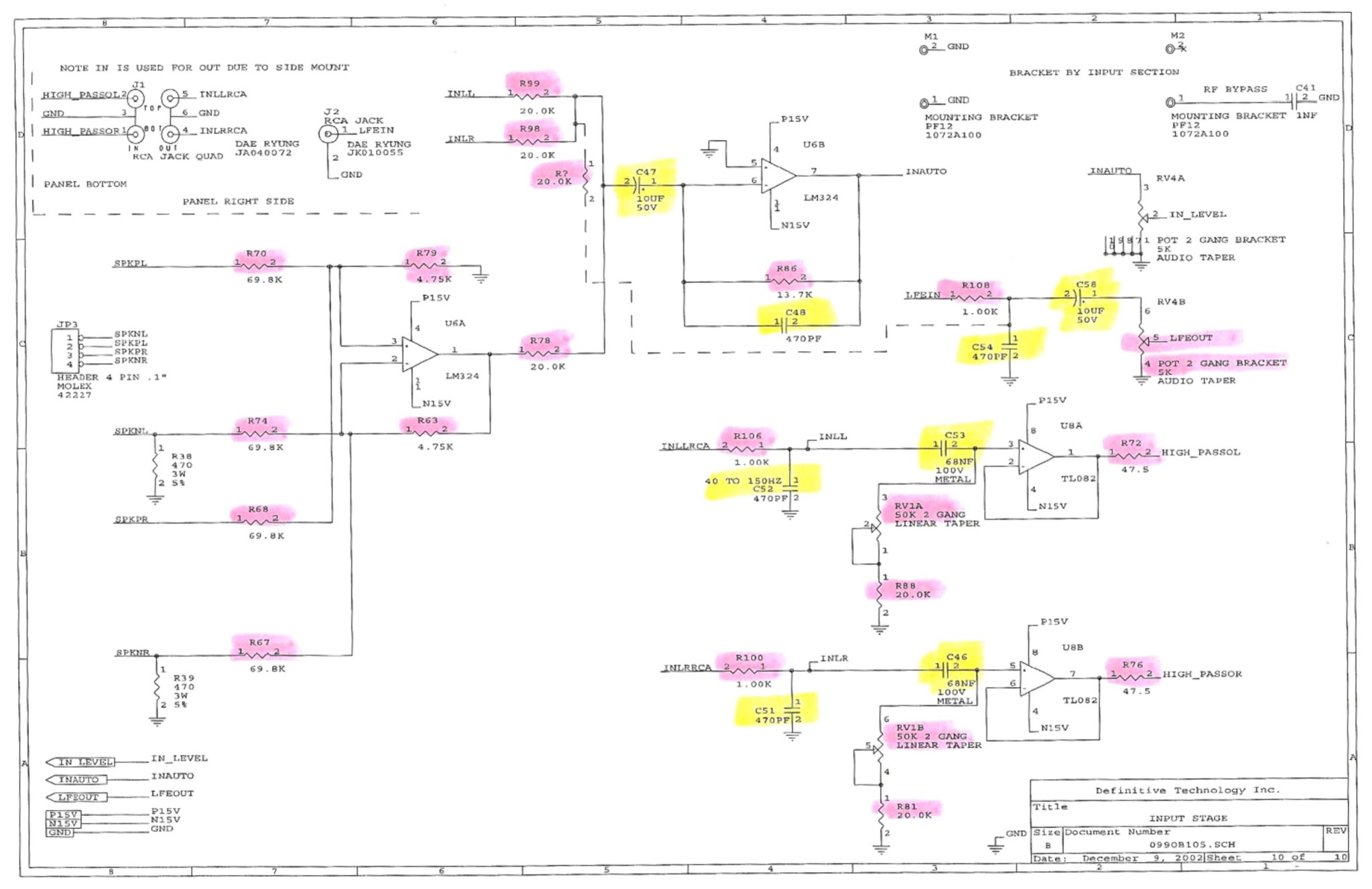

I've seen many people discussing it, but nobody really able to explain the root cause and probable repair for a low-output Definitive Technology SuperCube III subwoofer, or more accurately, its preamp from what I've read. It produces sound, but at an extremely low volume, and seemingly only through LFE. Gain knob works and controls what little volume there is.
Anyone have more in-depth details on this thing?
I've the skills to repair, but require some assistance diagnosing, as I absolutely SUCK at working with class D stuff.

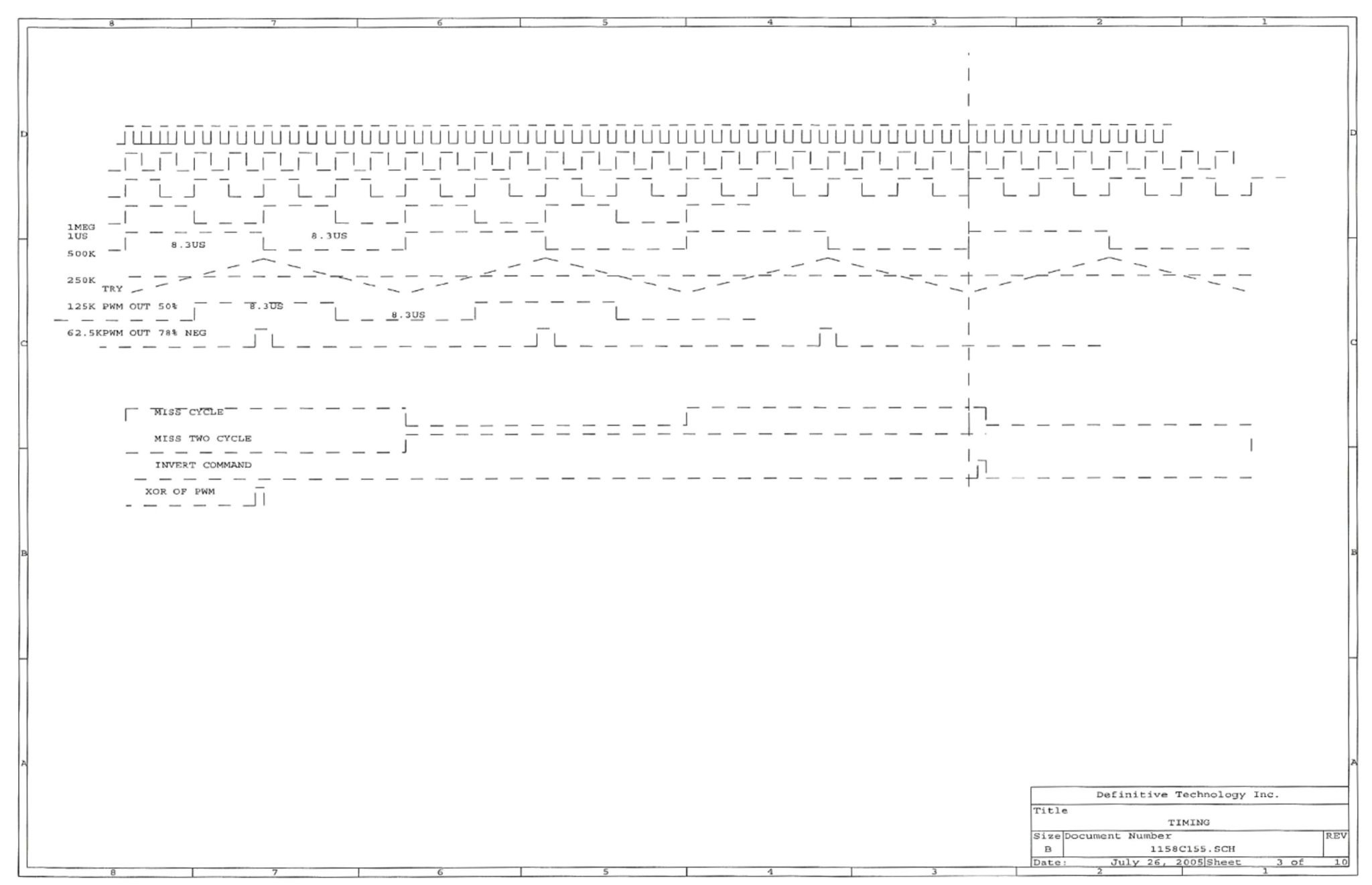

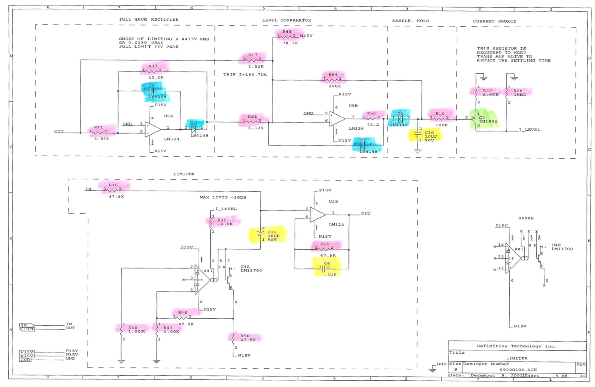

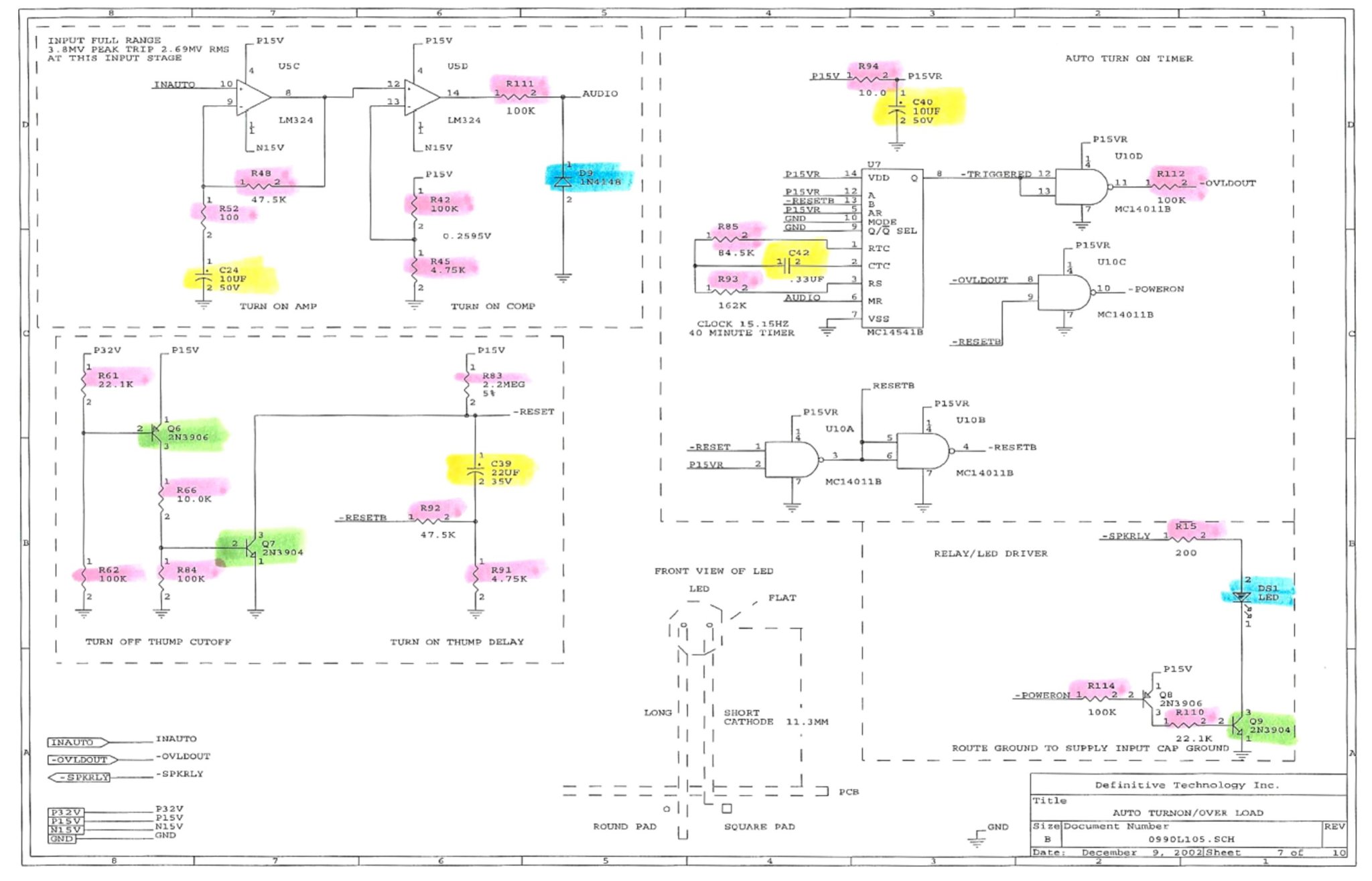

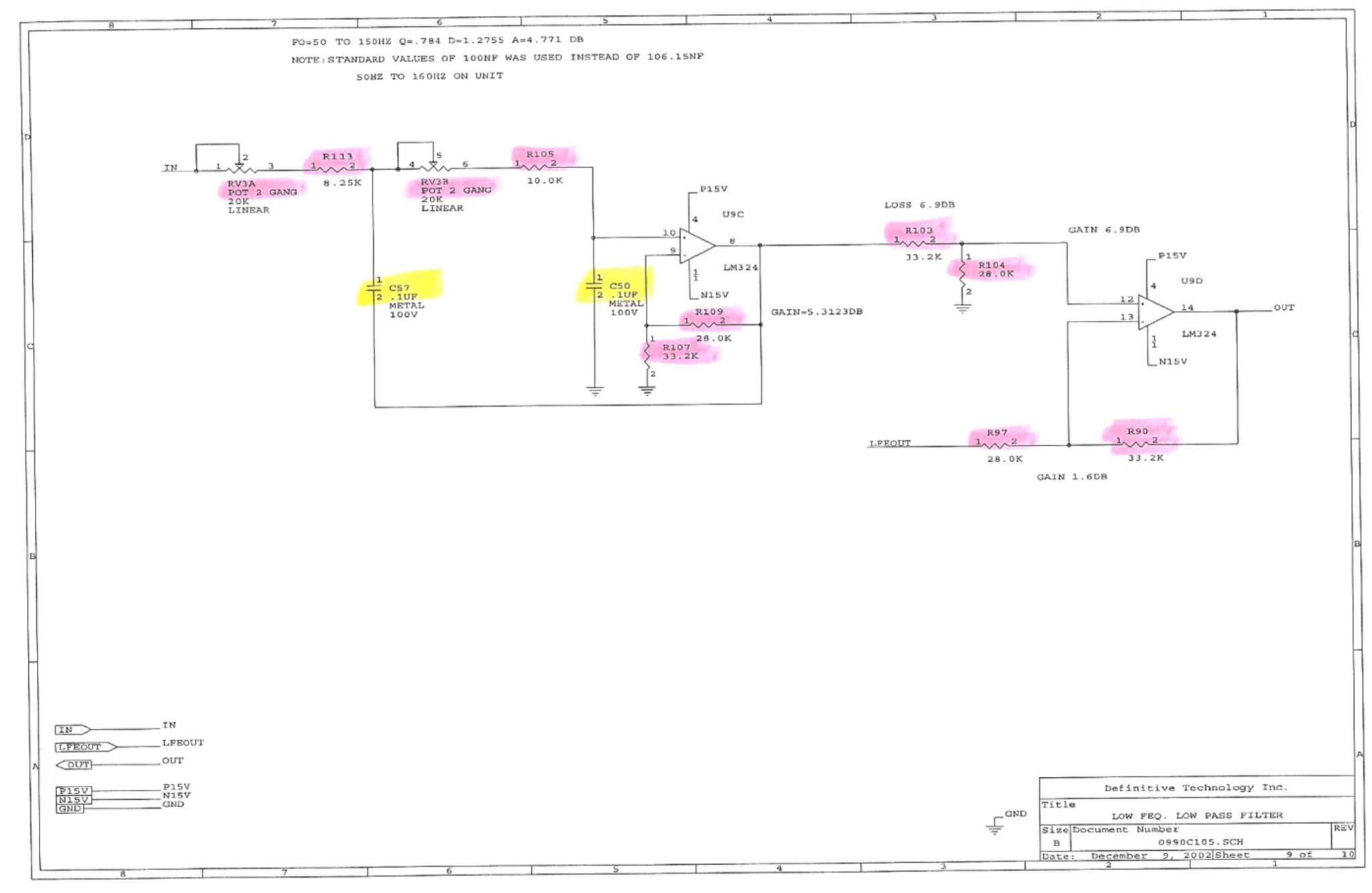

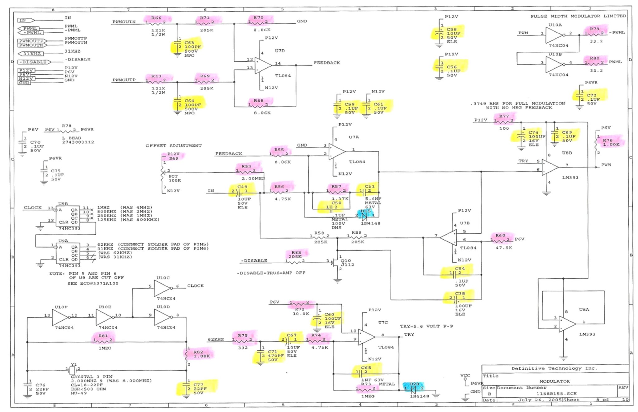

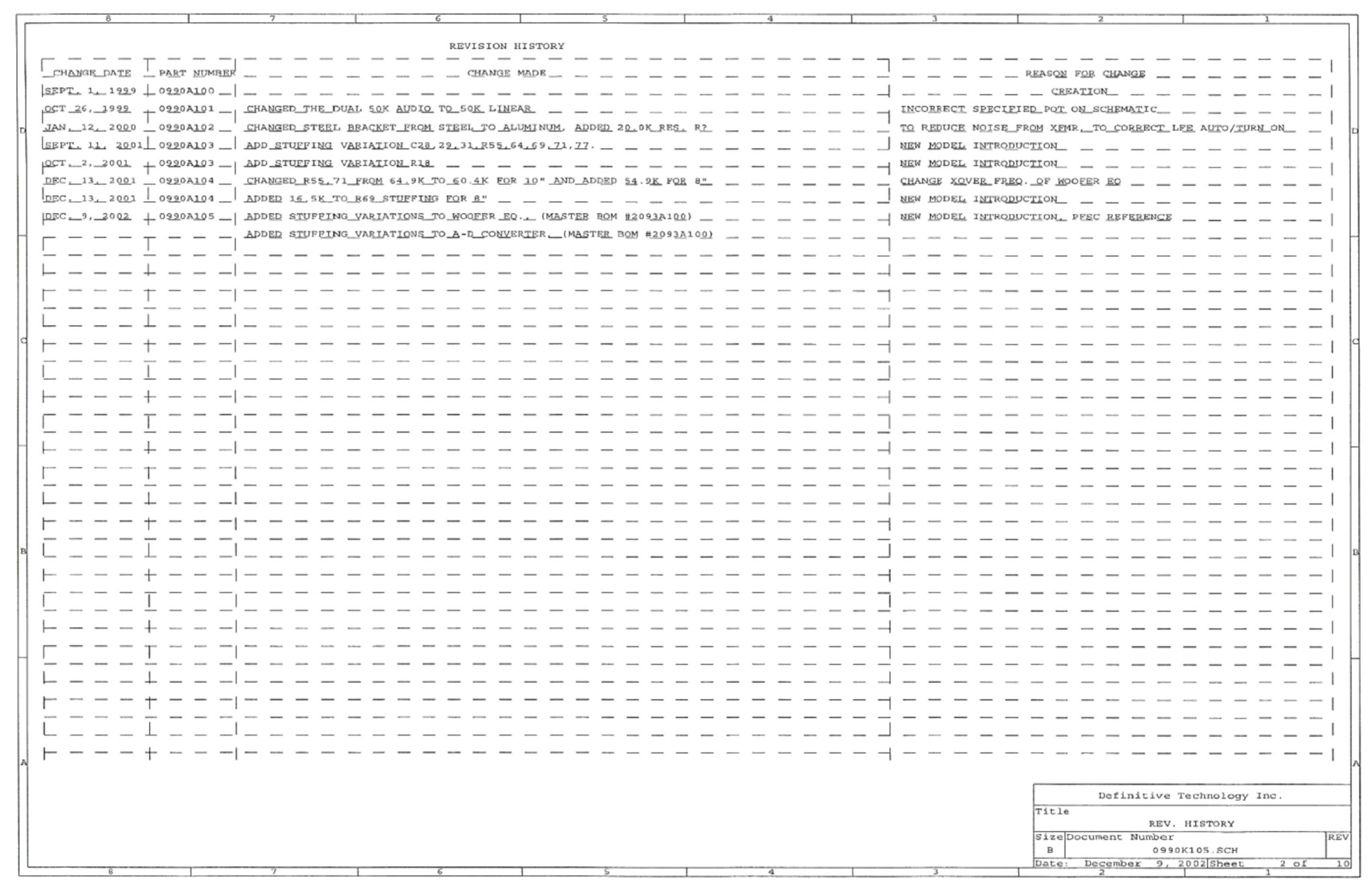

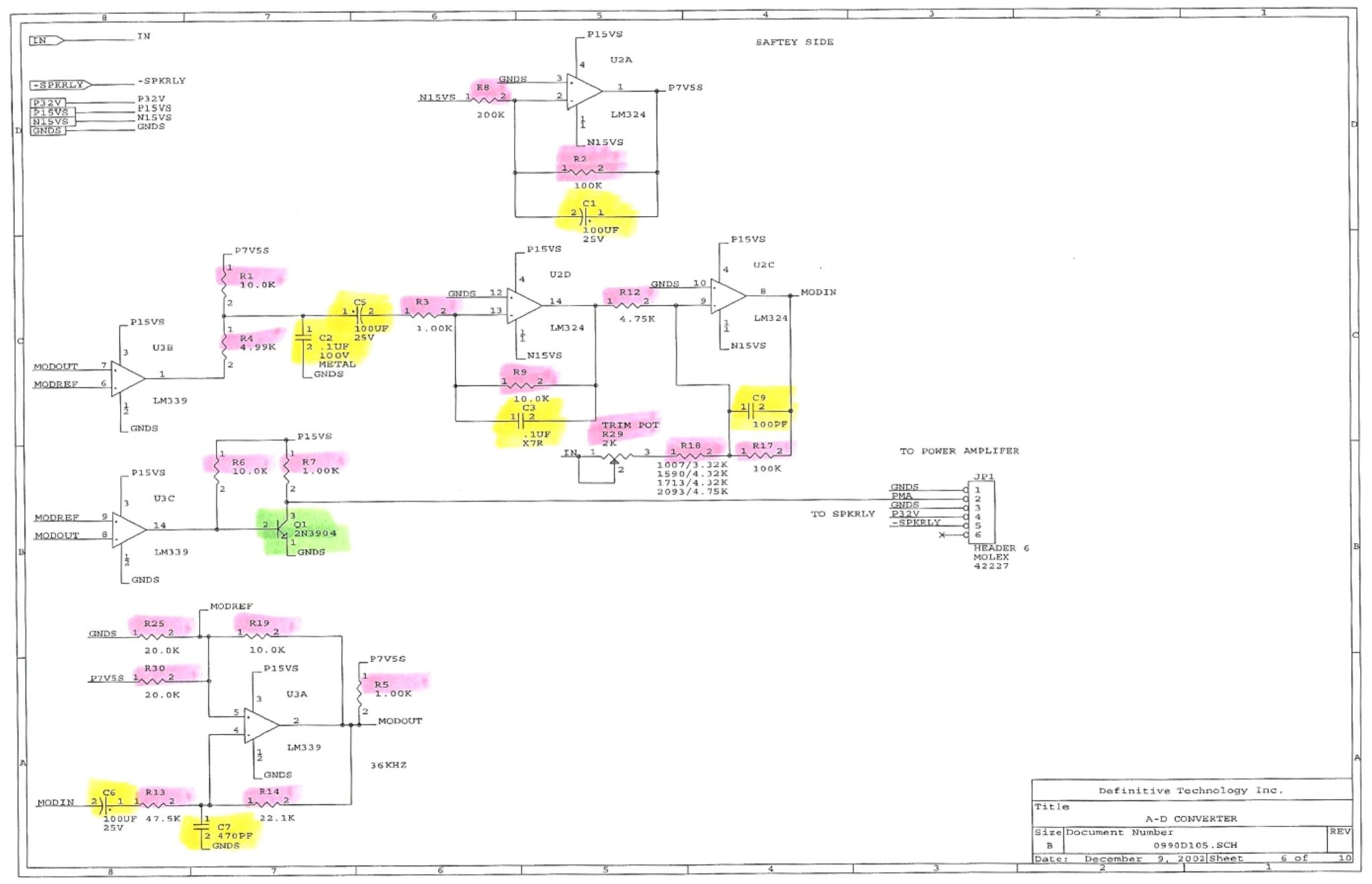

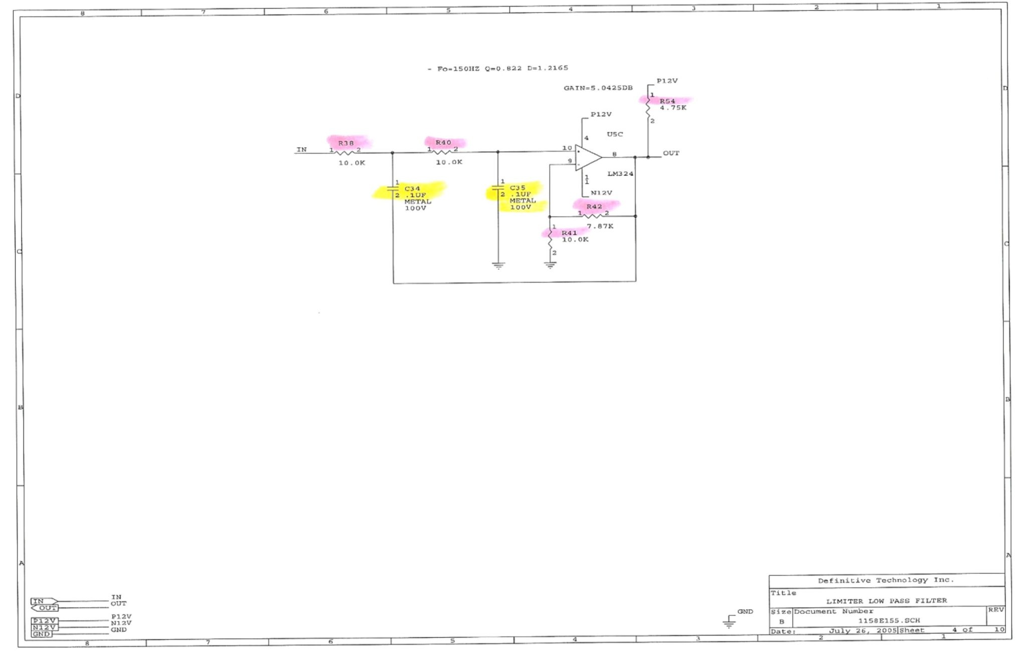

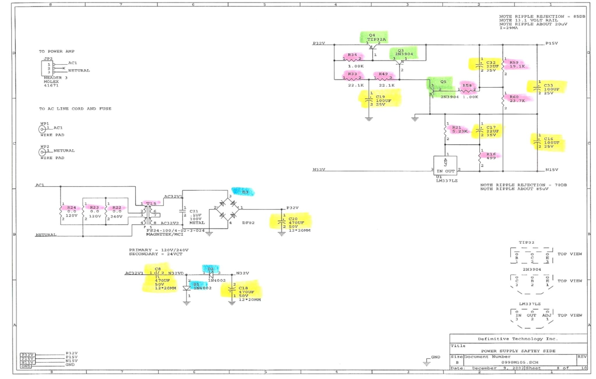

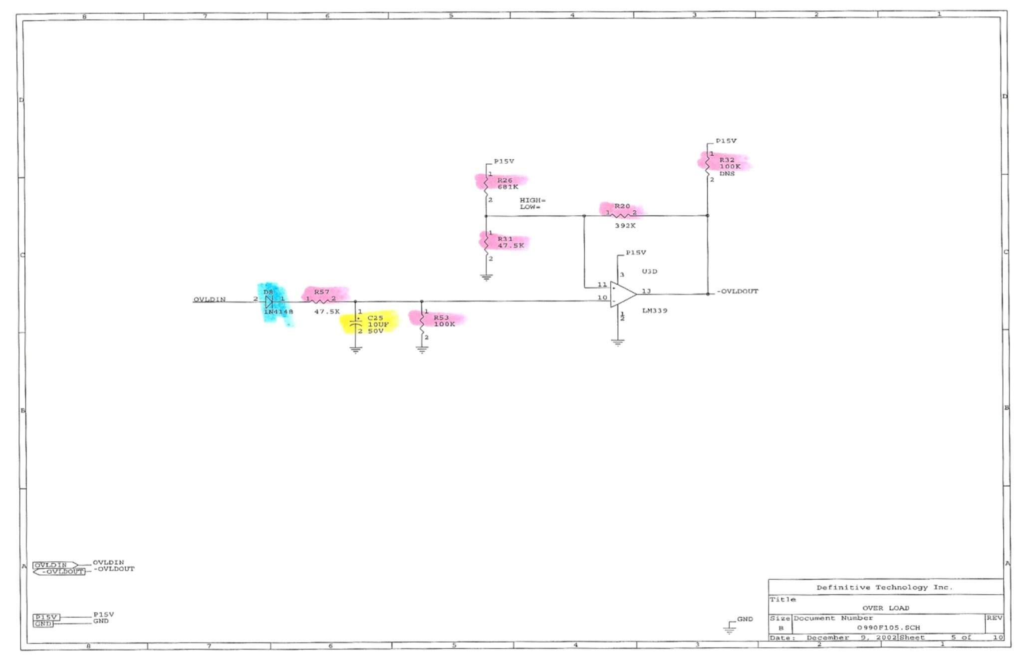

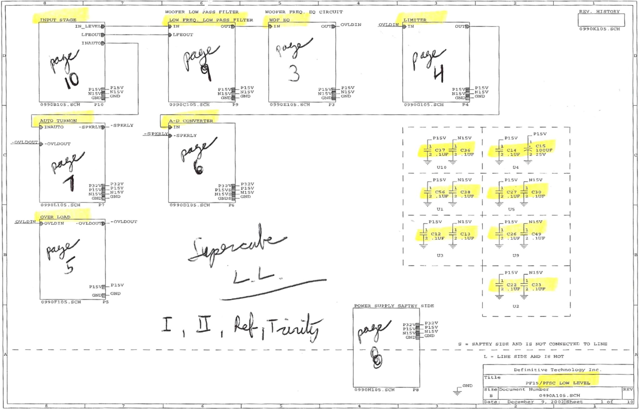

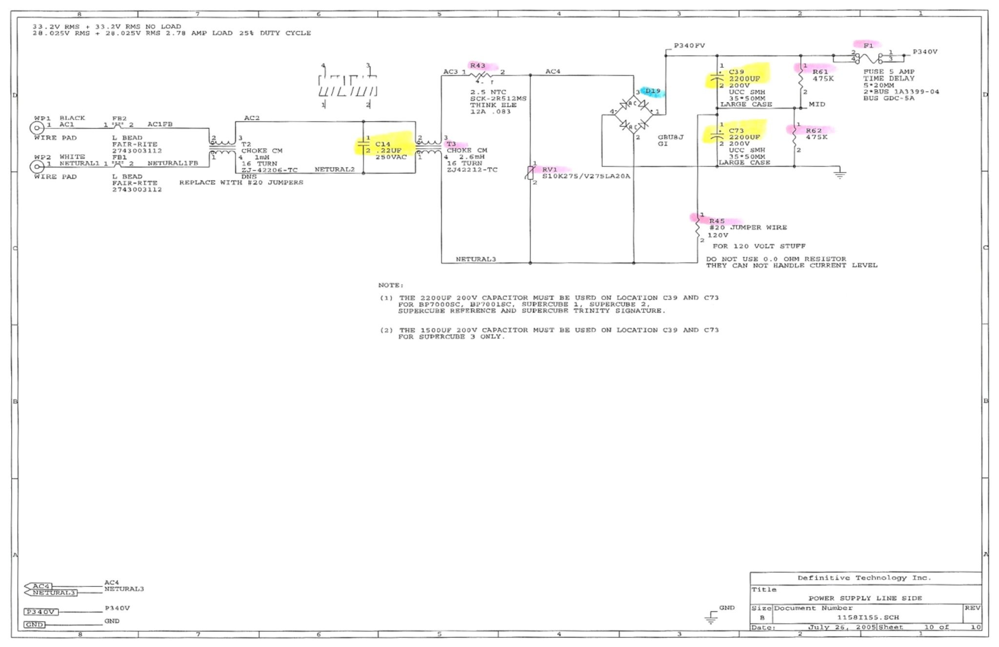

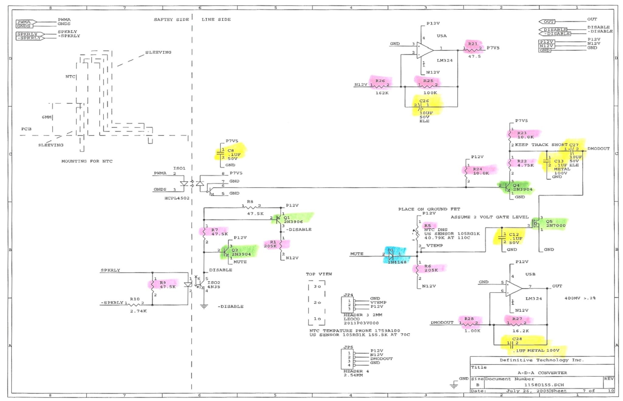

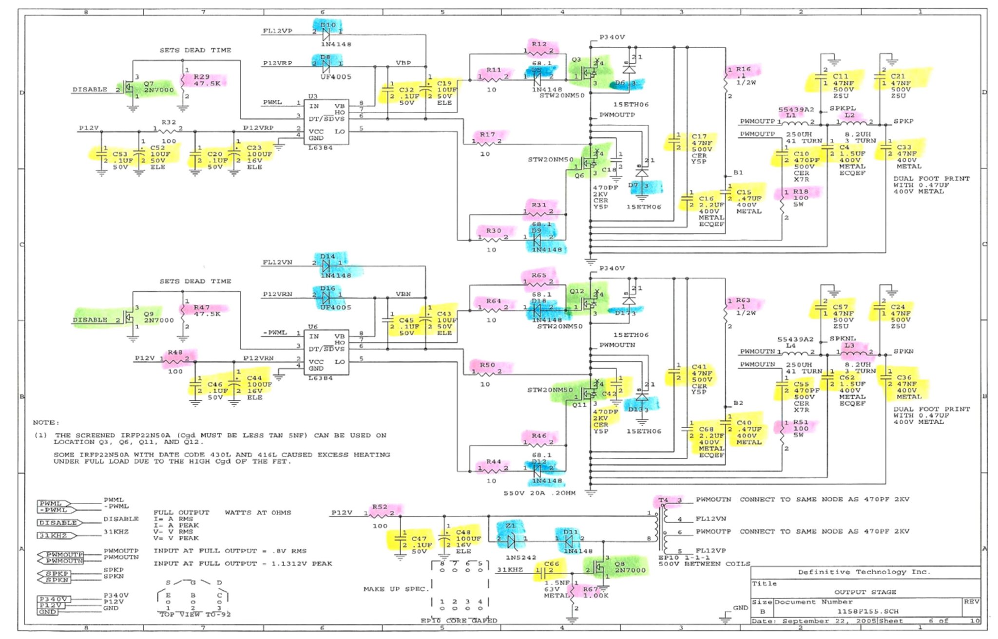

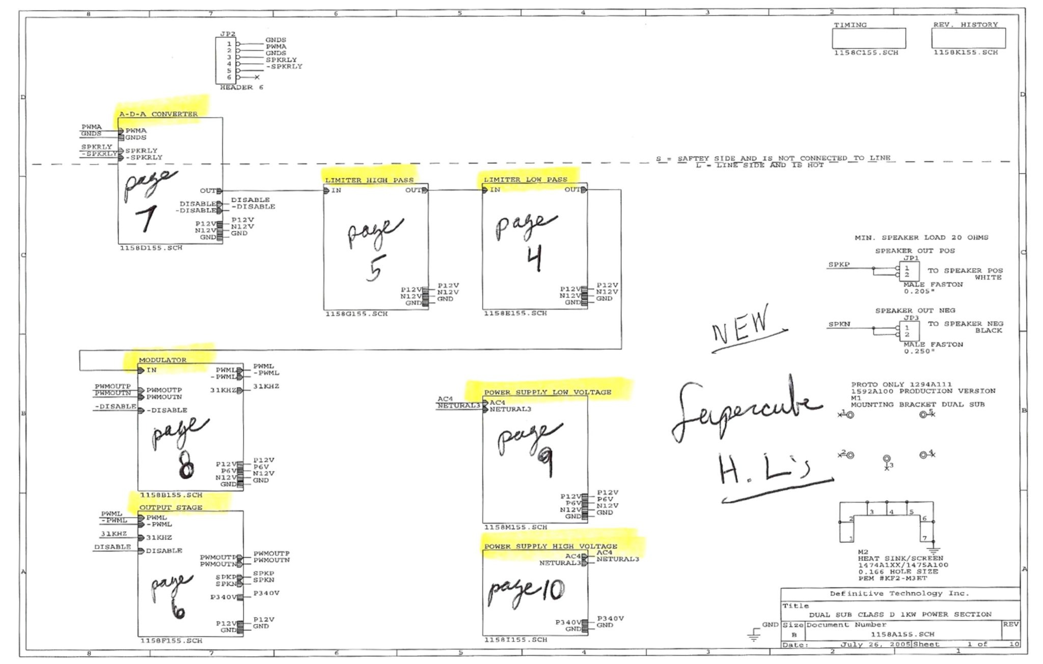

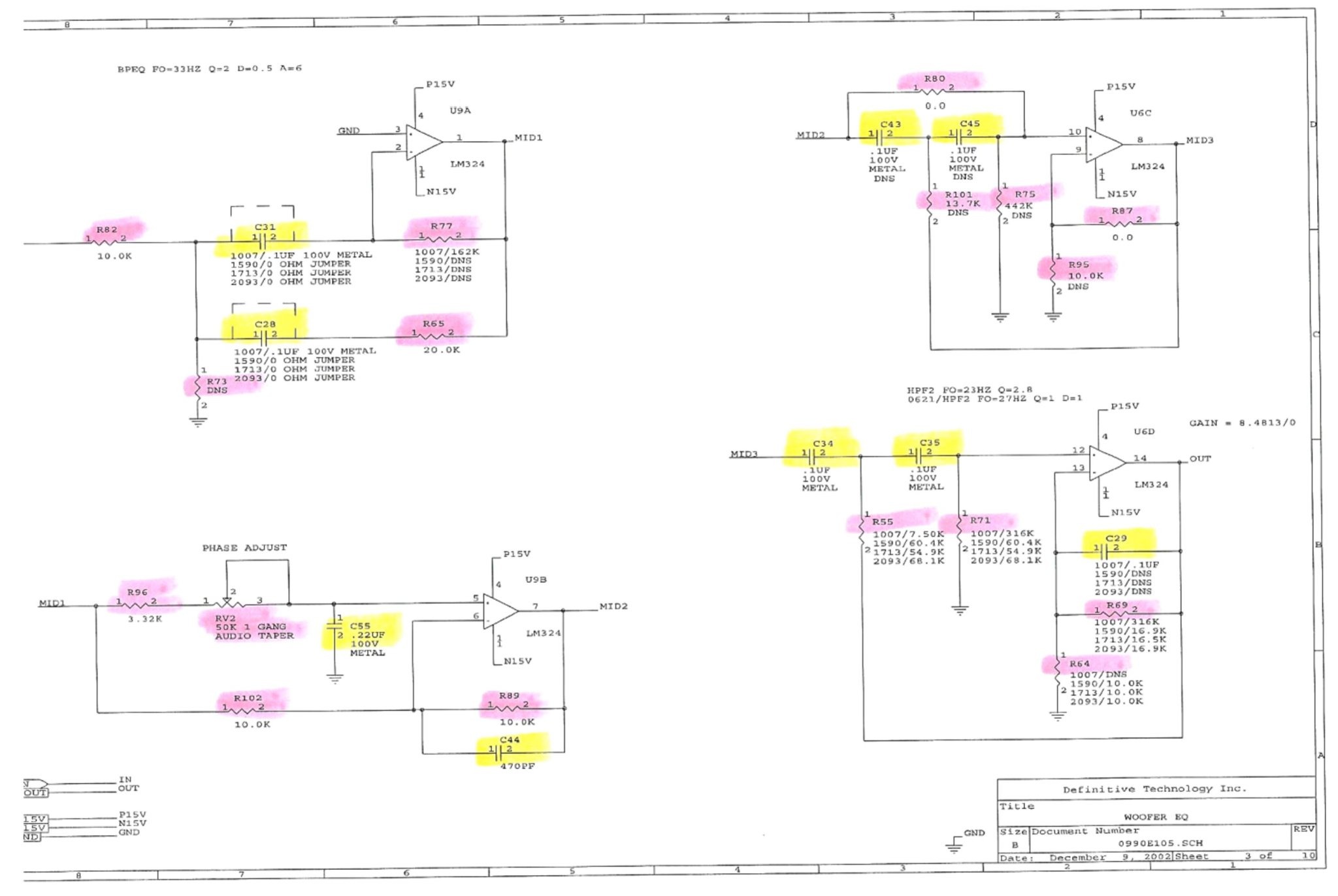

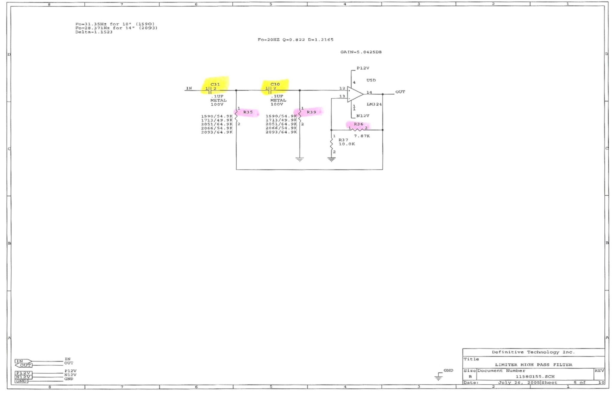

I've watched several repair videos on the Definitive Technology Supercube III. There are some schematics, which were uploaded by the repair video person norcal715 but they are on another website and they aren't allowing new login/user accounts. I believe much of the problems stem from the faulty potentiometers and as the videos revealed. I examined the videos and saw that the Level control pot is an Audio/Logarithmic taper 5k dual, the Frequency pot is a dual B20k Linear, and the Phase pot is a single 50k Audio/Log. You should be able to open the low level board and test the pots.
The files are two high res 13Mg pdf's.
I've copied the pages below as images.
Enjoy 😀
Enjoy 😀

Repaired one recently. Indeed the three pots were all open circuit. Once the volume pot was changed, it only had output from the LFE input - as the LFE input bypasses the crossover crossover/phase controls.
Once the other two were changed, it was good to go.

I can confirm long ago the manufacture received a bad run of 5K audio taper POTs and before the defect was found these went into production.
The small rivets in the pots that attach the terminals were not properly crimped and due to the vibration inside the subwoofer there was a significant and ongoing failure of the pots with open terminals.
This can result in no signal or full volume with no control depending on what rivet happen to go open in the pot.
If the 20k dual linear pot fails with open rivets this can cause weirdness in the xover frequency control including no signal and/or loud noises again depending on the exact rivet that may go open. The 20K pot came from a different vendor and there were far fewer failures of this pot.

Those schematics are for the SC3? Some of the description seems to be for the 2, though I'm unsure how much shared design there is between the two.
Thanks for all the information though!

There was a lot of commonalty in both circuits and PCB assemblies between all the super cube models and the later bipolar towers as well.Those schematics are for the SC3? Some of the description seems to be for the 2
The schematics for the low low level board you have does not cover the SC3.
The SC3 design is as I remember very close to the schematics for the SC1, 2, Trinity.
The PCB reference numbers will all be different from a SC3 so that will make it a bit hard to follow.
Be good to find a SC3 low level schematic.
If I remember correctly the SC3 power board was the same board as the other two larger models (SC1, SC2) only with a cut down heat-sink to allow fitting into the very small SC3 box. Kind of like a V8 stuffed into a subcompact car.
This was many products in my past and a very long time ago so my memory is a bit thin I admit.
You can try to test the pots in circuit however it very often gives false results as pushing on the pot pin with a ohm meter or scope probe almost always would cause the pot to work for a bit leading you astray.
If you want to end-up with a reliable unit the best way to go is to simply start by replacing all the pots and then trouble shoot what issues are left.
The low level board is pretty easy to trouble shoot with the exception of the ADA circuits that formats the pulse width modulator to pass the audio signal across the opto coupler.
You can test the low level board without the power board (much easier and safer) by applying 120V to the AC input connector.
First check the power rails.
Then follow the audio path through to the power amplifier interconnect cable.
There you will find the audio riding on a square-ware as a pulse width modulated signal that connects to a opto coupler on the power board.
I think somewhere around 60~80Khz (not sure) is the frequency.
To test the power board you MUST have a a isolation transformer as the power board is hot and directly connected to the power line.
Not using a isolation transformer is asking for destruction of you lab equipment and possibly you singing off as one of the living.
Trouble shooting the power board is a bit tricky and you can easily cause extensive damage rendering it a paper weight.
If you need help with a power board let me know and I will try to provide some hints.
Happy hunting
